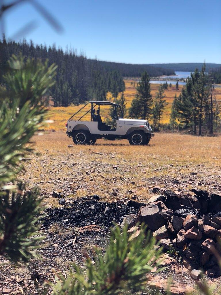

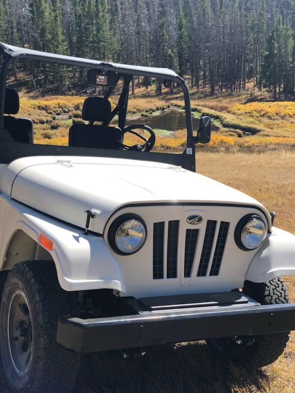

cumminfourya
Aug 8, 2018
33
Omaha, NE, USA
1391
Well it did everything I wanted and more. Was finally able to get mine up to Wyoming and ride. This thing is a absolute beast. Everybody on the trails stopped to talk about it. Many people have heard of them and seen videos and said how amazed they were after seeing in person. It handled all the terrain perfect!!!
