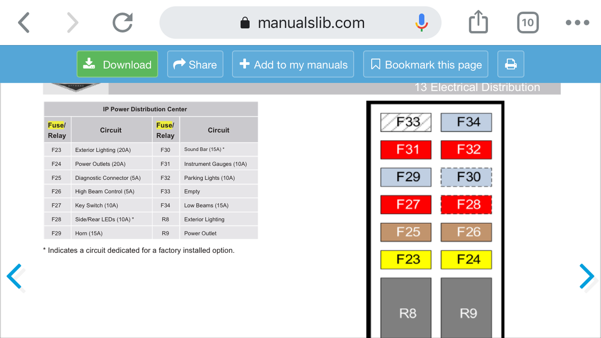

Look for the Electrical Schematics of the Roxor available on this forum. They will make the job possibke in the first place.

Attached: schematics, two boxes with descriptions of each relay and fuse.
