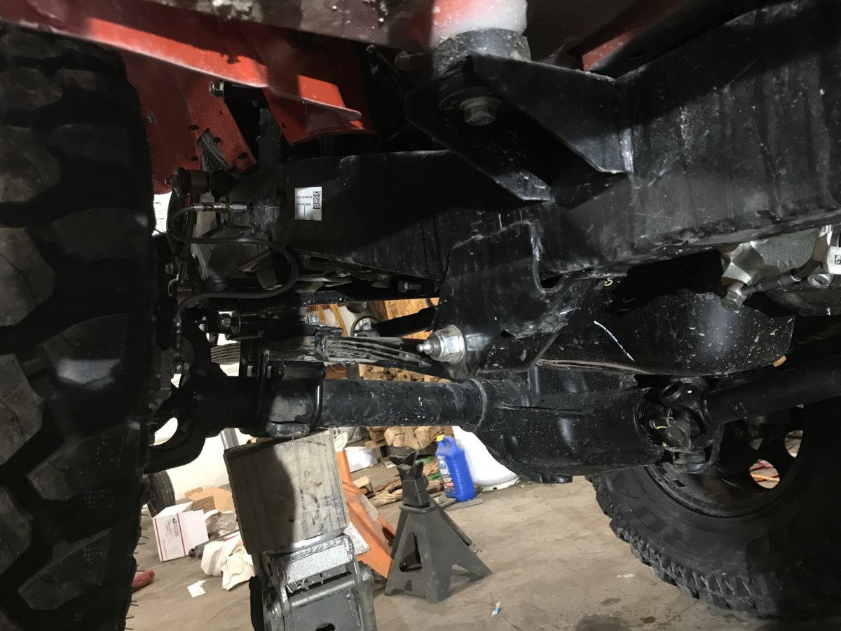

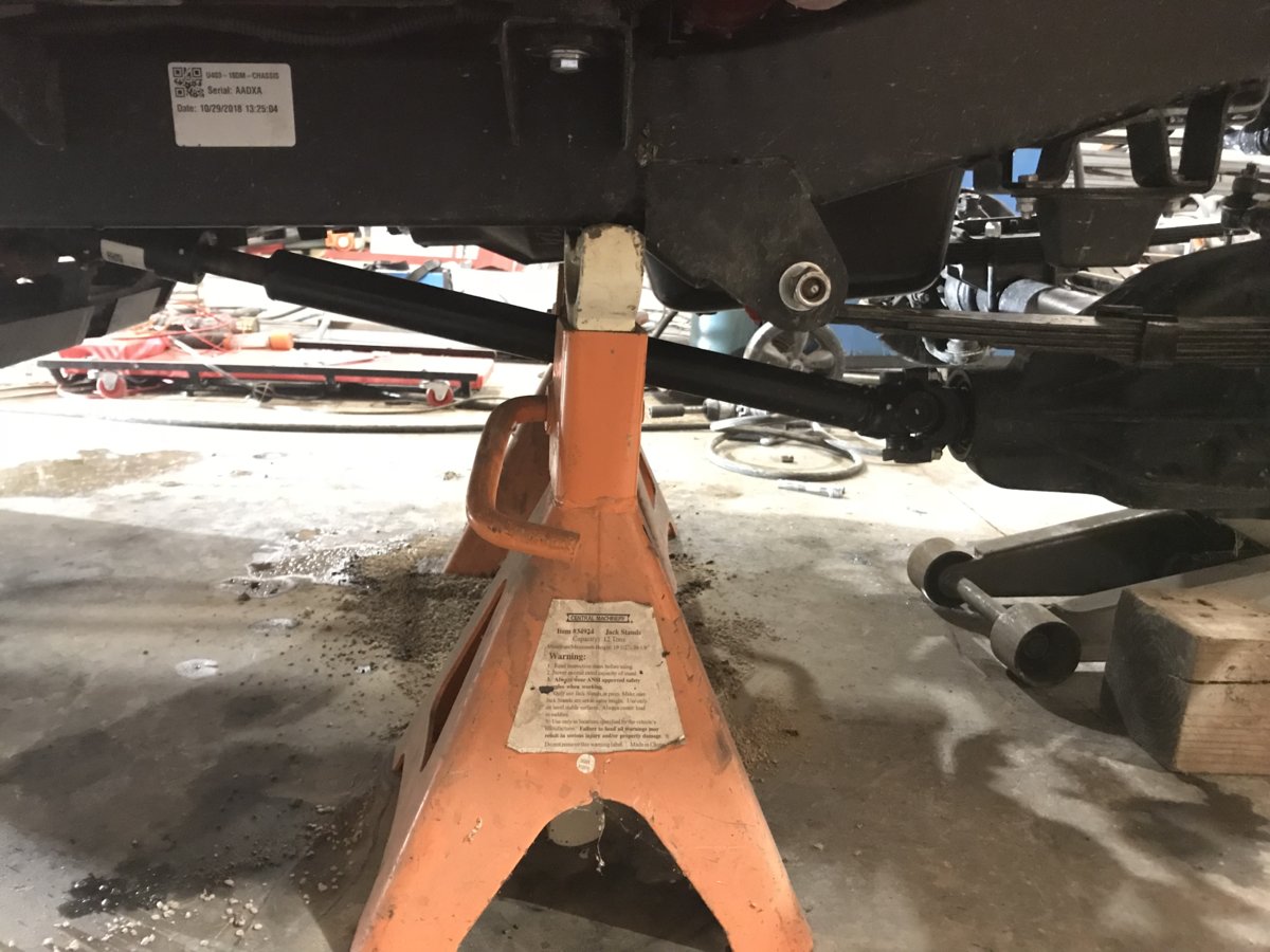

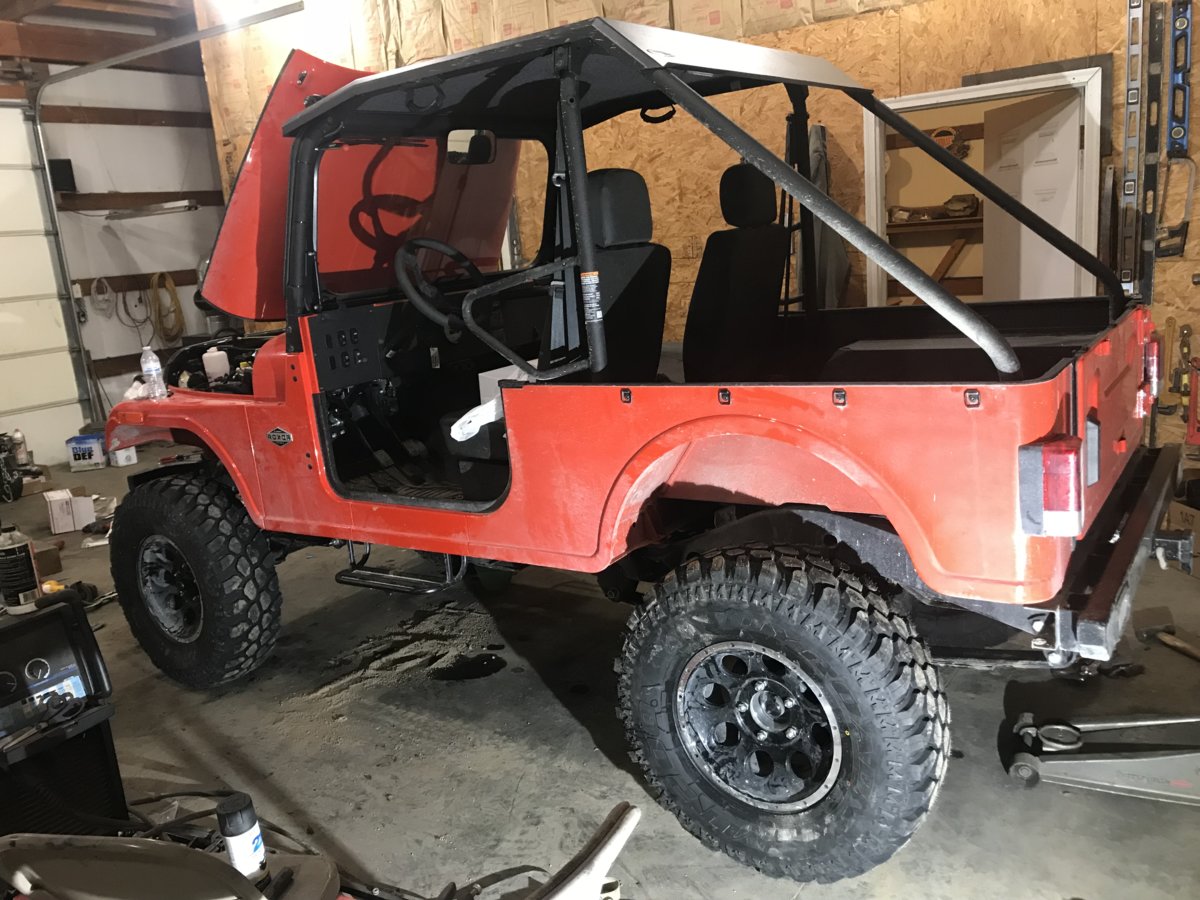

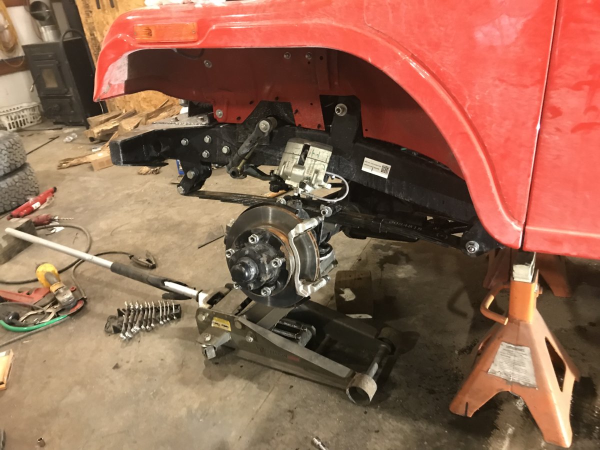

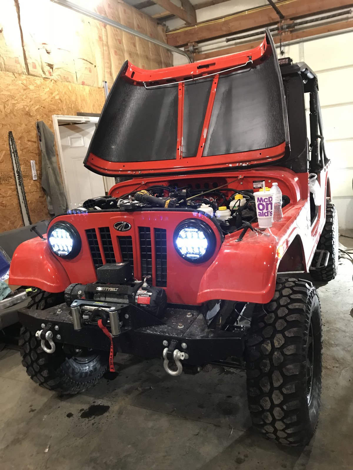

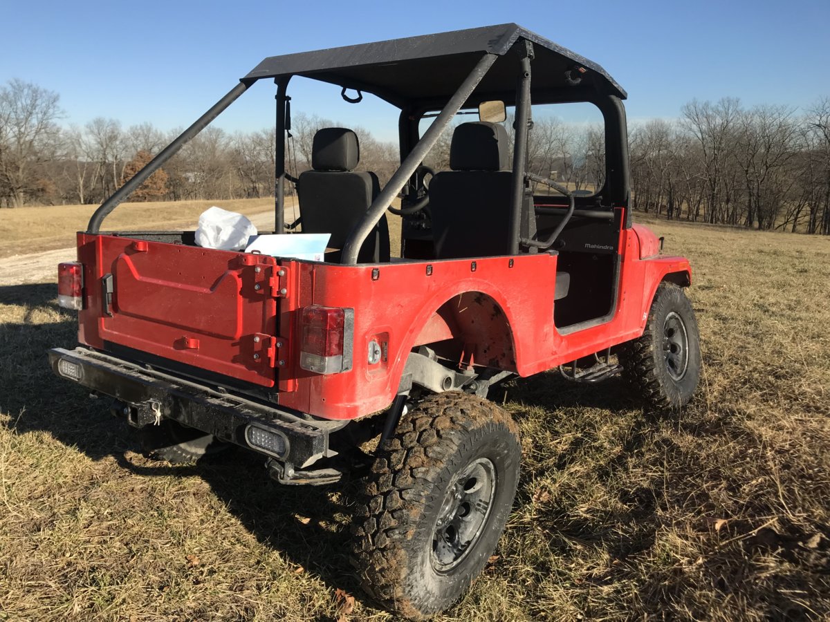

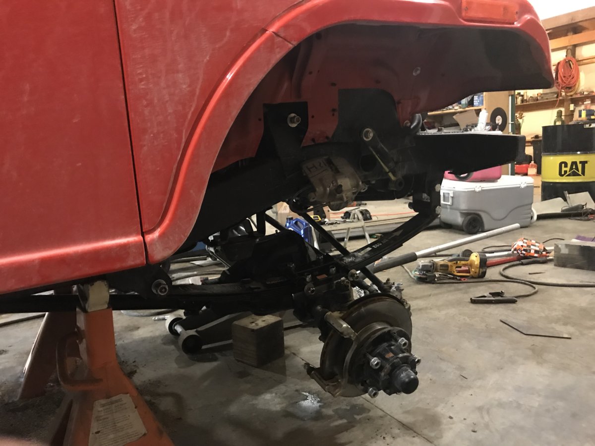

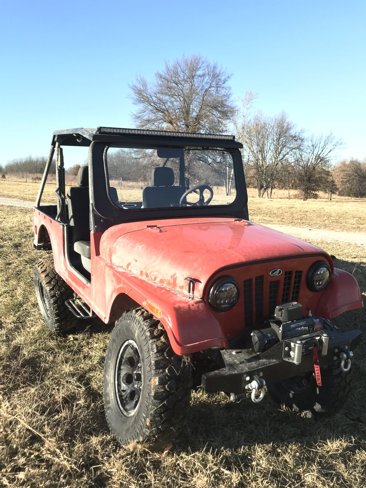

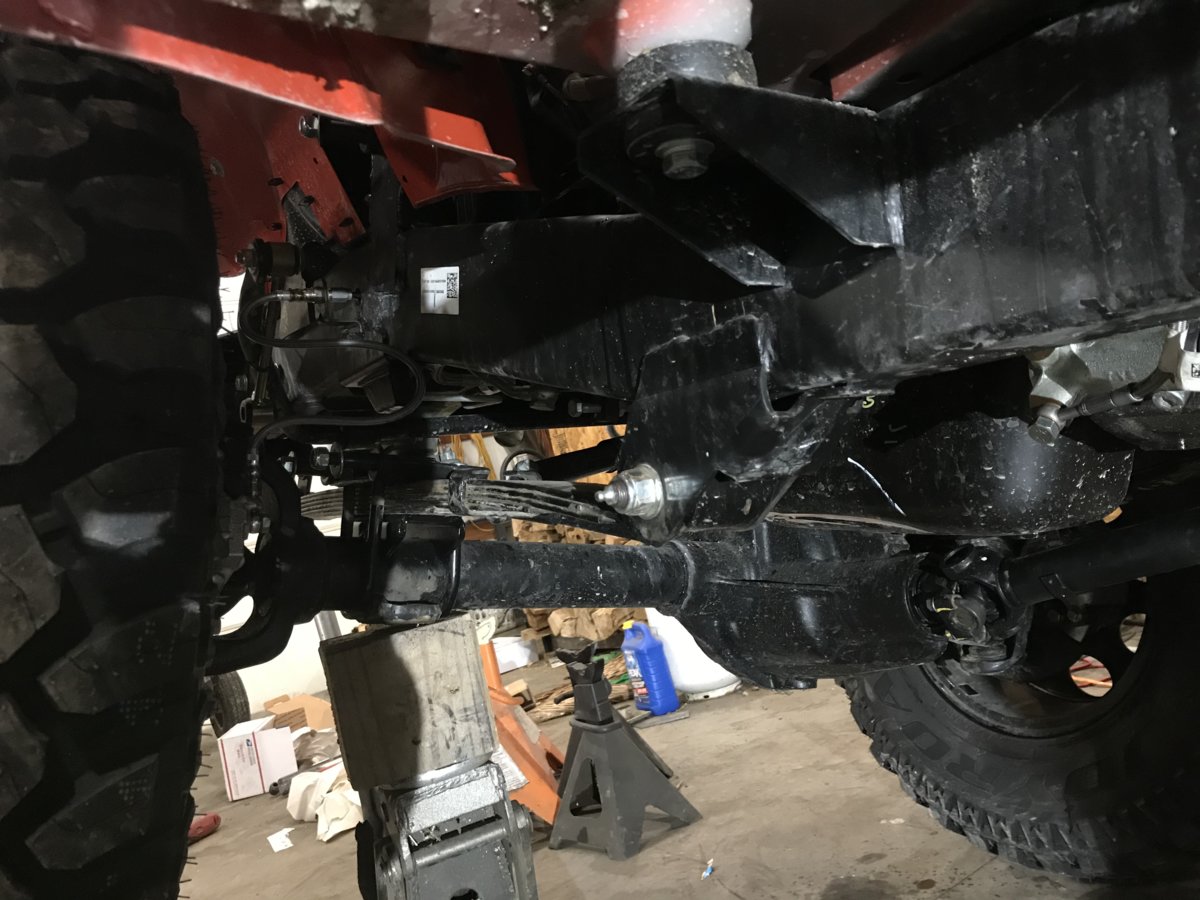

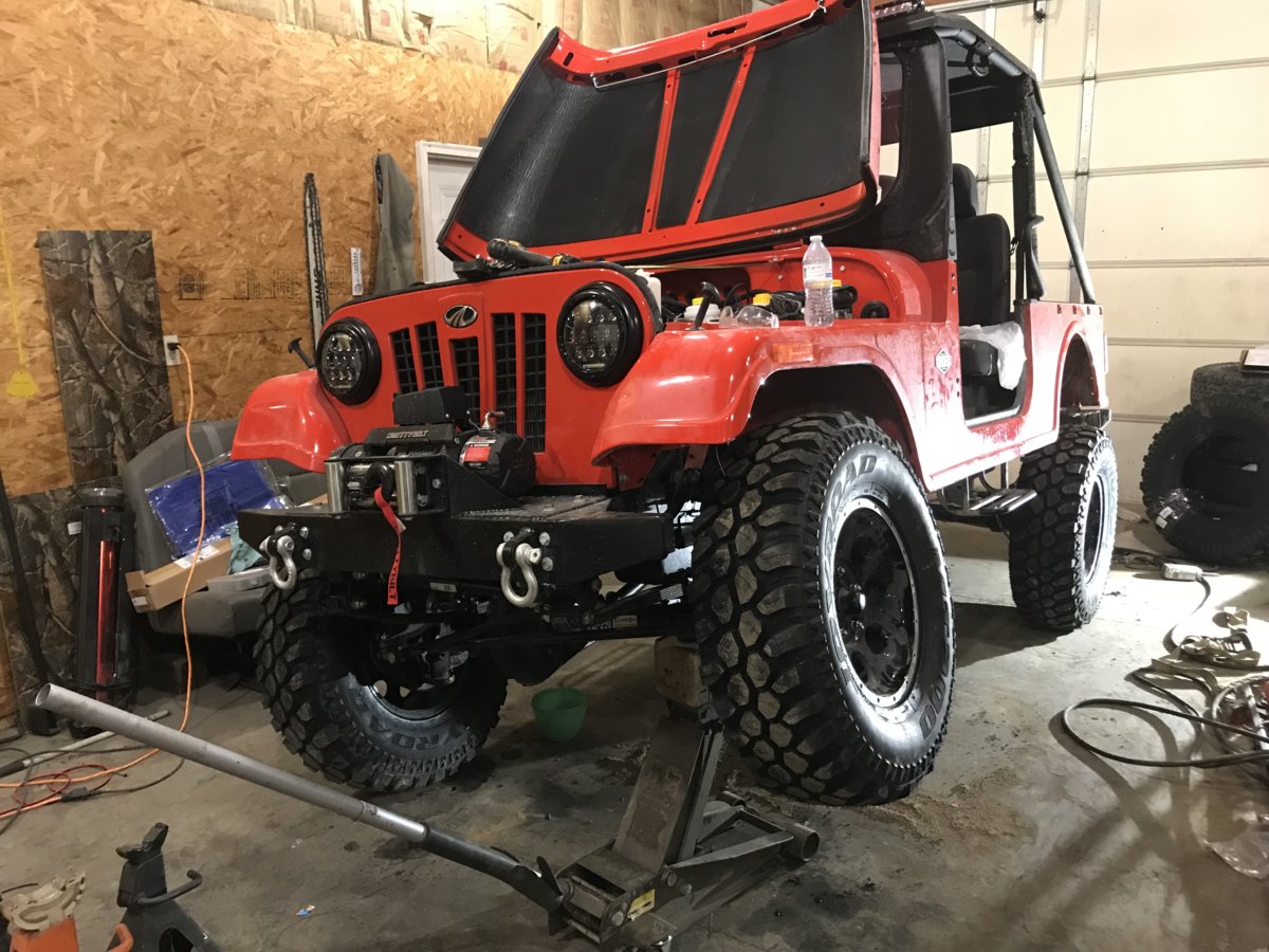

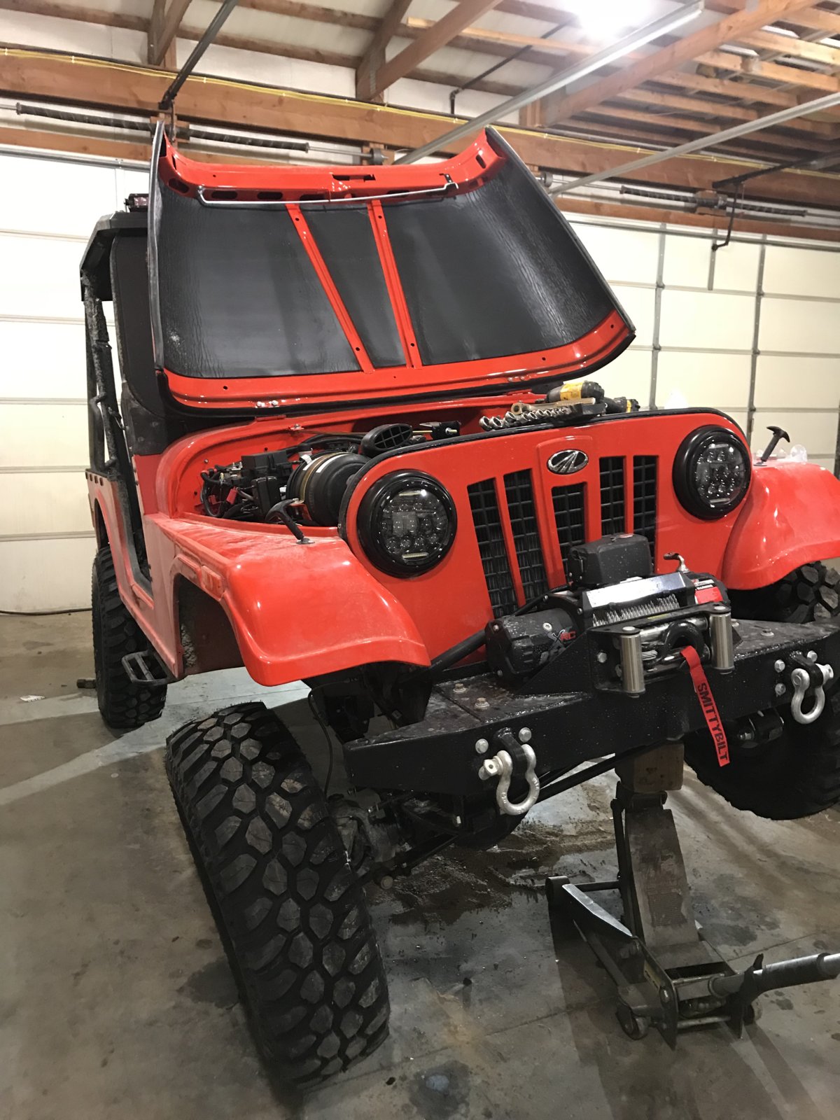

Well I’ve been working on this for a few evenings out in the shop excuse the mess ? the only thing left to do is the steering does anyone know of a drop pitman arm for a Roxor may do a tierod flip too and wait on the shocks to arrive

What size tires are those? Were you able to readily available brake lines?

About 5.5” on front I lost my stock measurement on rear I took the bottom leaf spring outta the pack im thinking about 4-5 in rear if someone would could they measure from rear hub center to the top of fender
I get right at 28” from center of hub to top of rear fender.

I did spring over axle that way I could keep a flatter spring for better ride and articulation on a side note there is lot of stuff to do than just weld on spring perches
