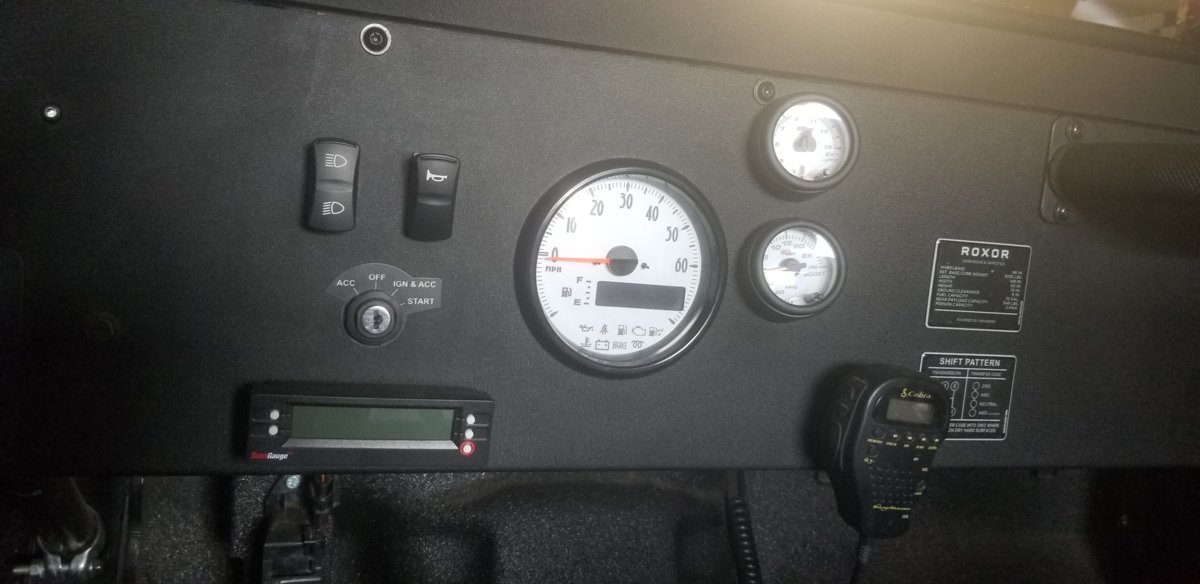

I'm thinking my winter project will be installing analog gauges if I can source the proper sending units. The stock idiot light cluster is pretty lame for those of us that like to know exactly whats going on. Stewart Warner makes some nice high quality stuff.
2,290
Agree, I like knowing my water temp is. I put one of these in. An OBD II sensor.
