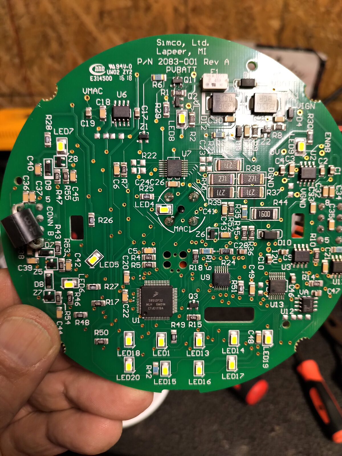

Does your Roxor still run as normal when the cluster goes out?
At work we have several old CNC machines where control boards are no longer available and use two outside companies to troubleshoot and repair. Would someone with a bad cluster be willing to send it to me and I will have have these companies look at it?

They still work but the alternator needs the cluster to excite it and start charging. Probably also why the failures are related with jump starting.
I can send you a photo of the circuit board. Here it is. Maybe they could go by this. If you found a firm that would fix these you'd be a hero! I sent it to one firm who specialzied in cluster repair and they said No Bueno.

Has anyone tried to get schematics or a layout for the circuit board from Simco? They will likely say no to the request. But maybe they have an applicarion engineer tjat is wiling to support the issue
An electronics repair shop (or electrical engineering student with a lab) will need two things to do a thorough analysis:
- The board schematics show what is connected (e.g. components), voltages at each point.
- The board layout shows how the schematics are translated into the actual traces on the board. For instance, a board can have multiple layers of traces or components on front and back.
Without the schematics or layouts, an electronics tech could still look for bad solder joints or cracked traces.
With the schematics and layout, an electronics tech (or a electrical engineering college student / associates degree candidate with a lab) can take a scope and measure voltages (or signals) on components.
Some thoughts:
- Since only some clusters are affected and not all that were built, it is not a design flaw.
- since the failed clusters worked for some time, I believe that
(a) something on the board broke (bad solder joint, broken trace) due to vibration
(b) or an overvoltage fried a component.
Some thoughts:
It would be awesome to get the schematic. I am not sure that only some clusters are affected and not all. It may be the case, but it may also be the case that those that have not failed yet, will fail at some point. It will follow a normal distribution curve. I talked to a dealer who had a lot of the original parts today (no luck on a cluster) and he indicated they sold 55 Roxors before Roxor went out of business and they had replaced 25 of the clusters.
