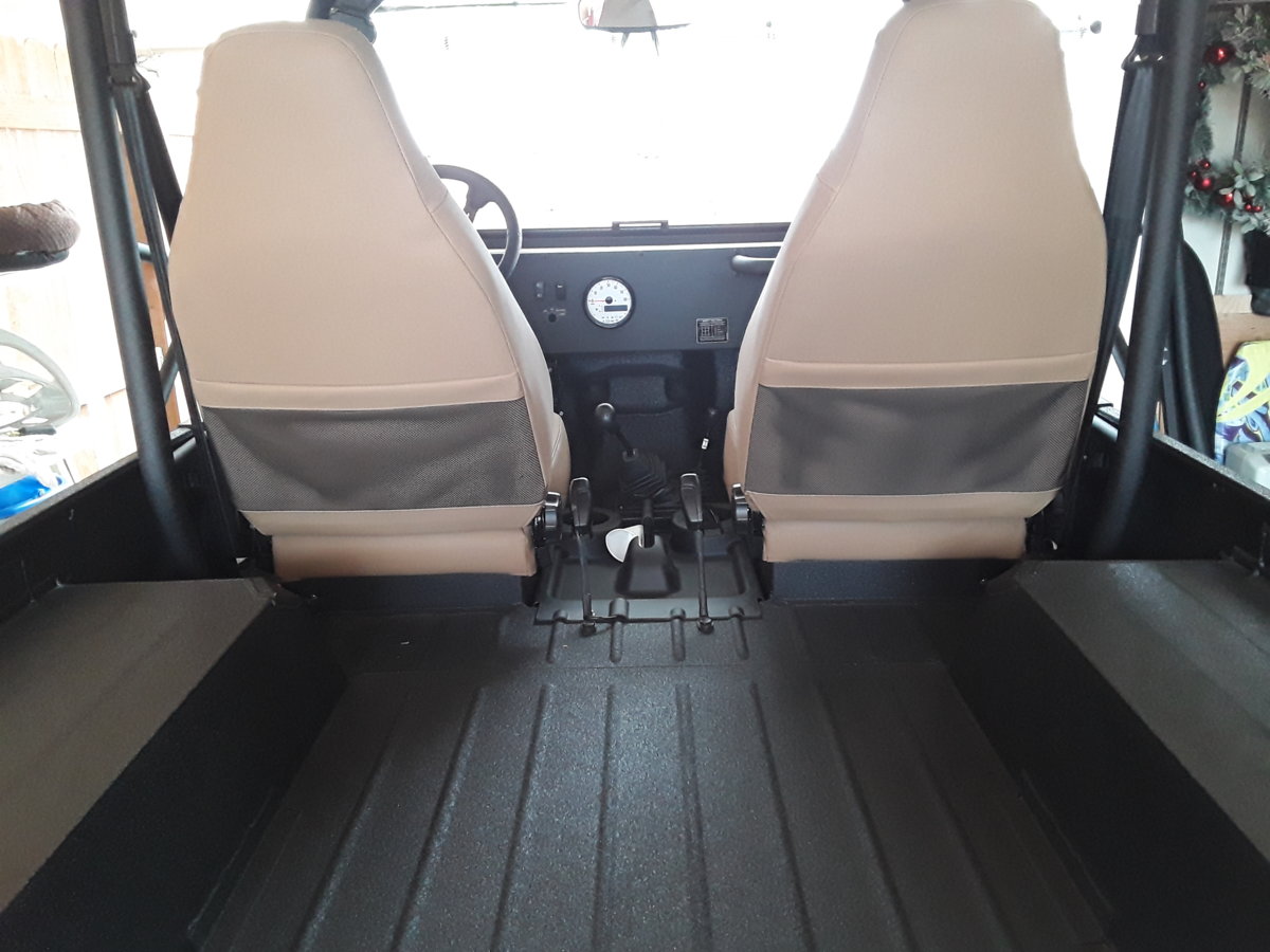

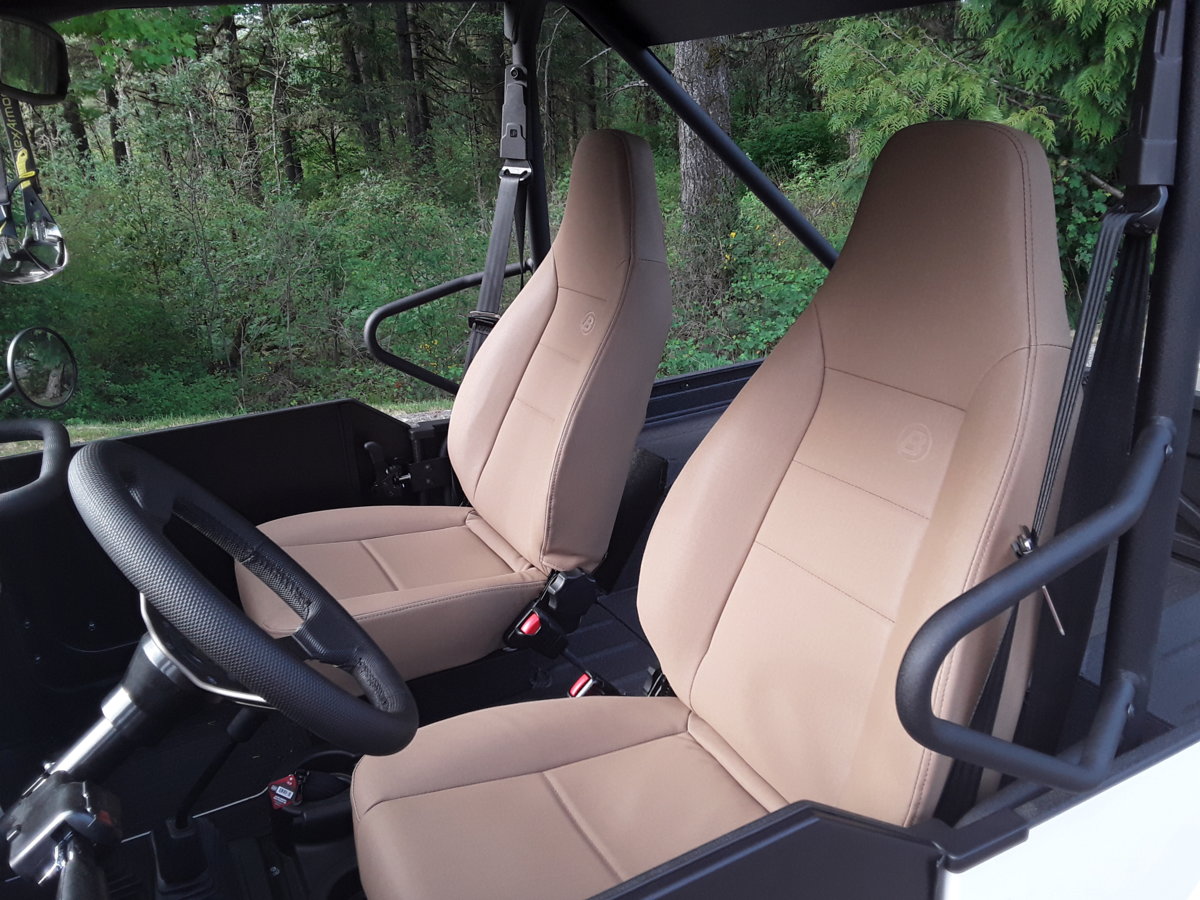

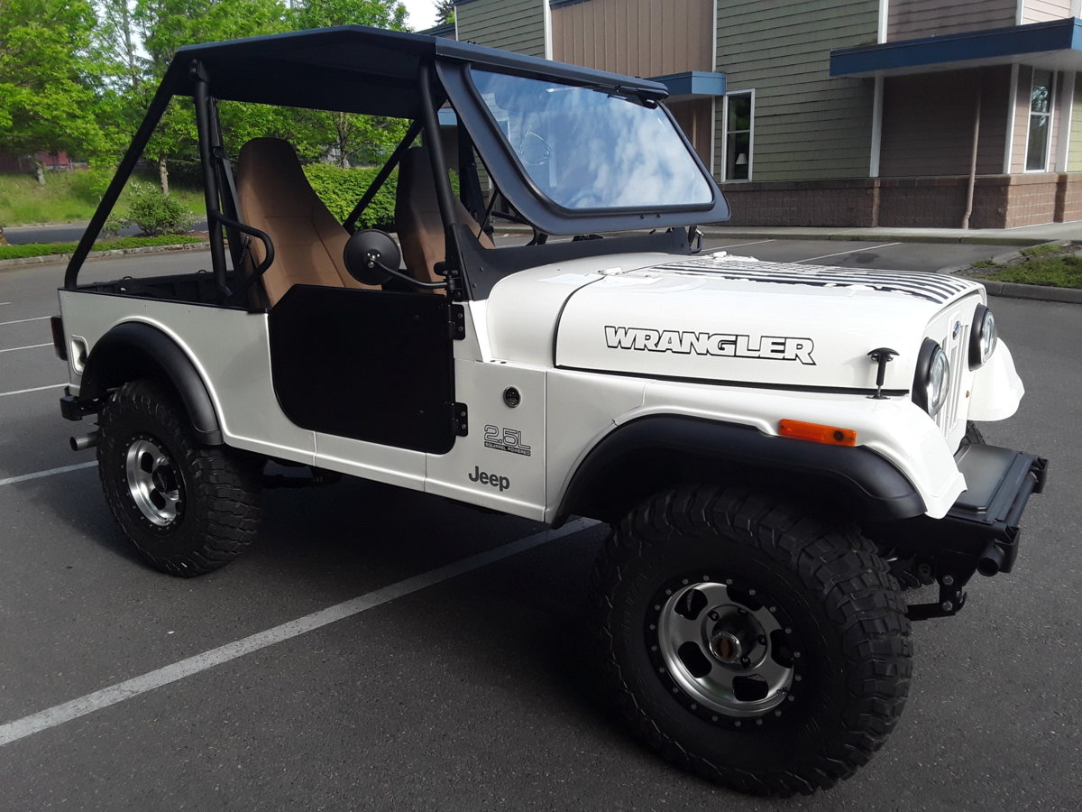

How did the seats workout? Were they the ones for the Wrangler?
Here's what those seats look like in the Roxor. easy fit reclining seat look like the jeep seats from the era of the jeep body.
The material is more like carhart than sticky black vinyl in the sun
