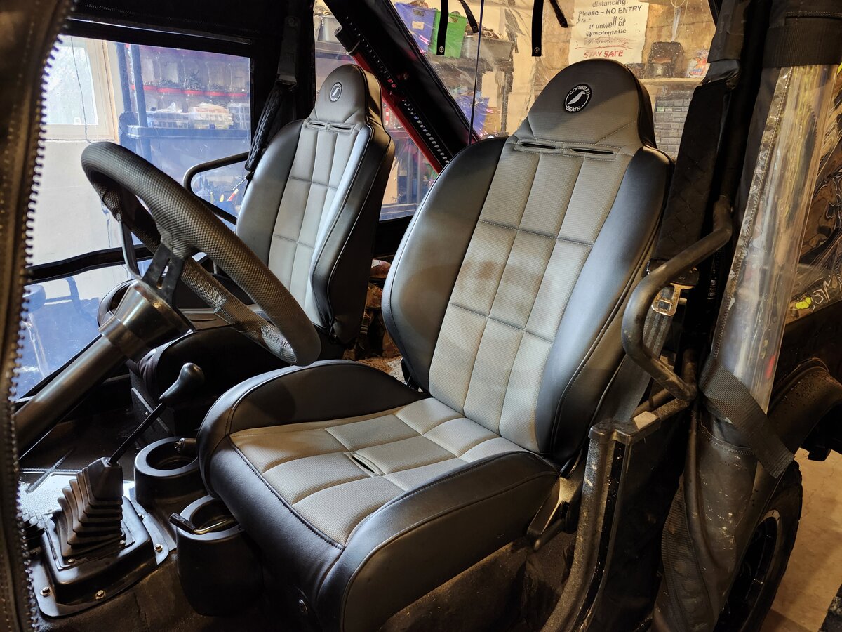

Corbeau seats fit nicely.

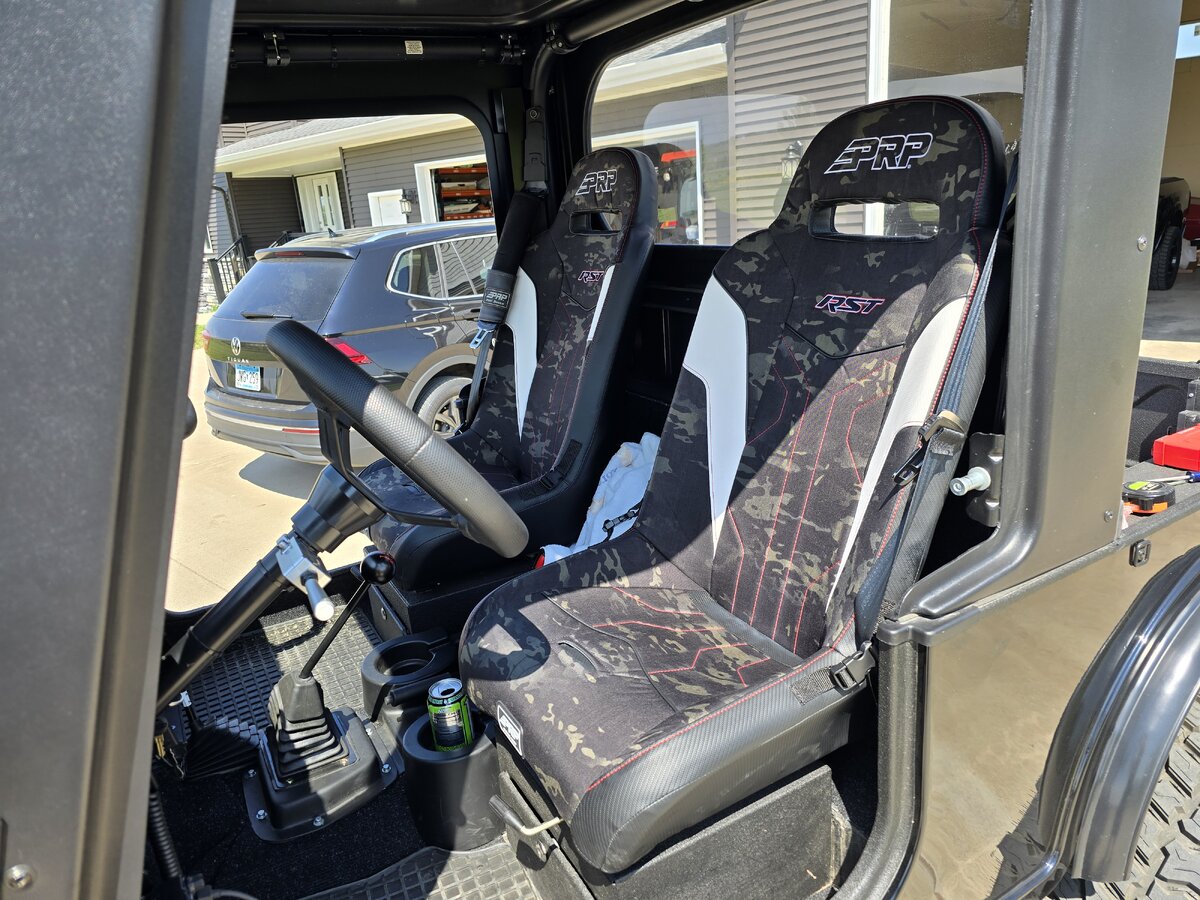

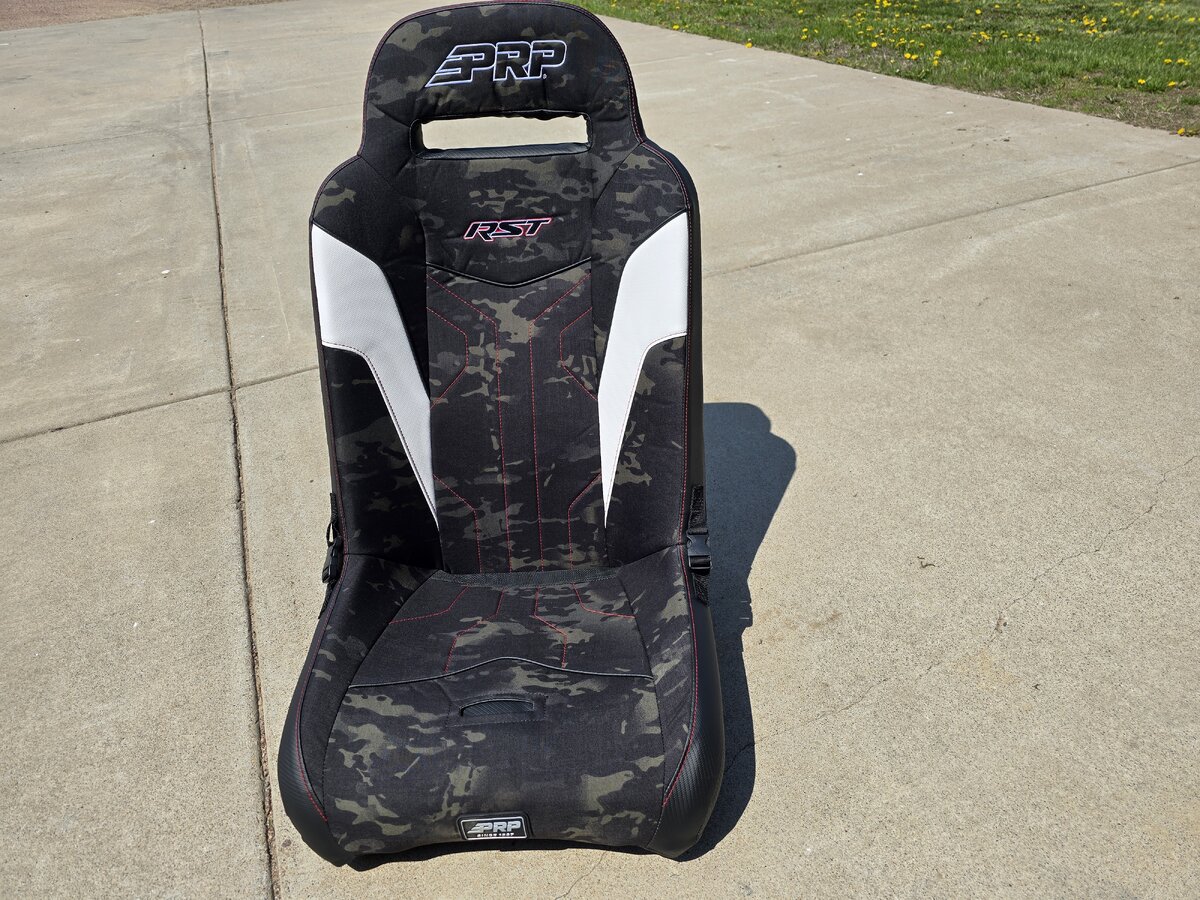

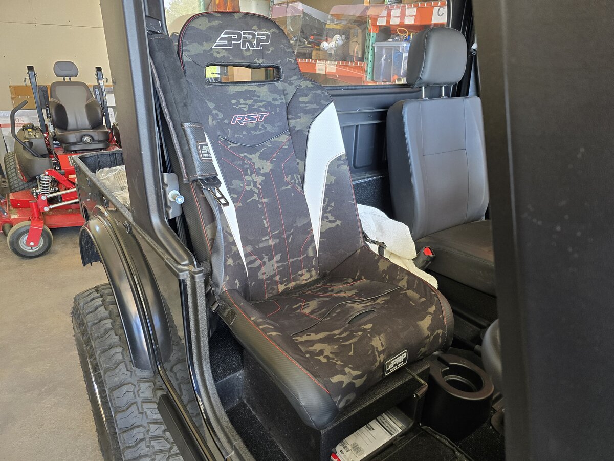

If you order PRP seats for a Polaris RZR, you don't even need an install kit, the base holes in PRP frame line up exactly with the factory Roxor slider mounts so you retain all functionality. Just have to enlarge the seat holes one size and source some bolts. Shim the back bolts with a couple washers to change the tilt if desired. Easiest install I did with the Roxor.
Do you feel those seats give you a little more leg room and lower profile? Thinking of ordering a pair
Longslyde
Nov 22, 2024
116
Sauk Rapids, MN
I'd say it's about the same once installed and you're in the seat. I didn't notice a big difference myself. The biggest difference I did it for was to change the material, so I wouldn't sweat my nuts off in them. LOL! YMMV.
