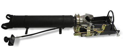

Well I don't get the metallic sounds. I have towed over 2000 miles to date. More towed miles than driven miles! Lol. I looked at this as an option. There are many types that do the same thing. Lots of RV folks use these. The only draw back I see is how reliable is it when pounding it off road or in a rocky area.
