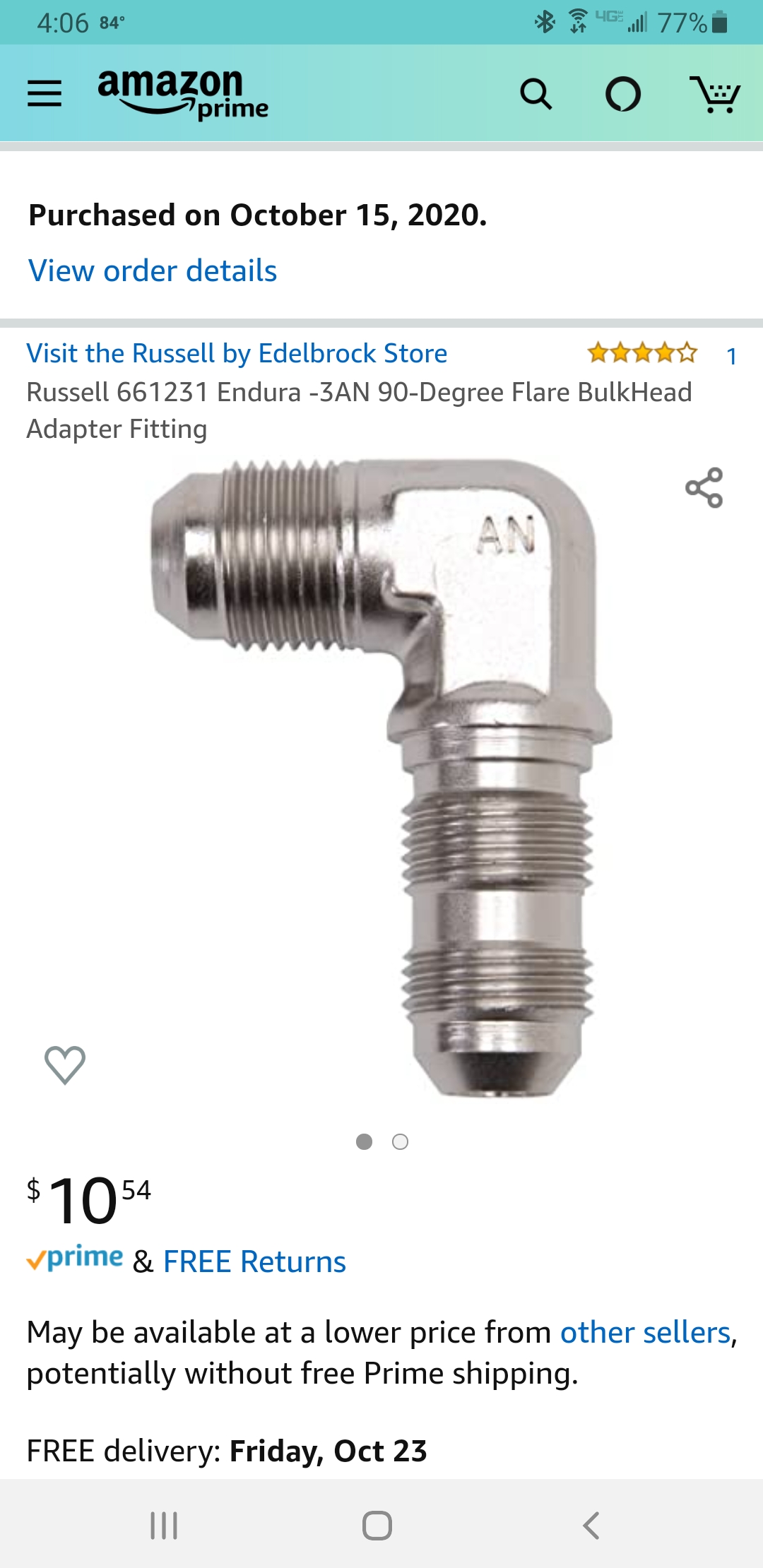

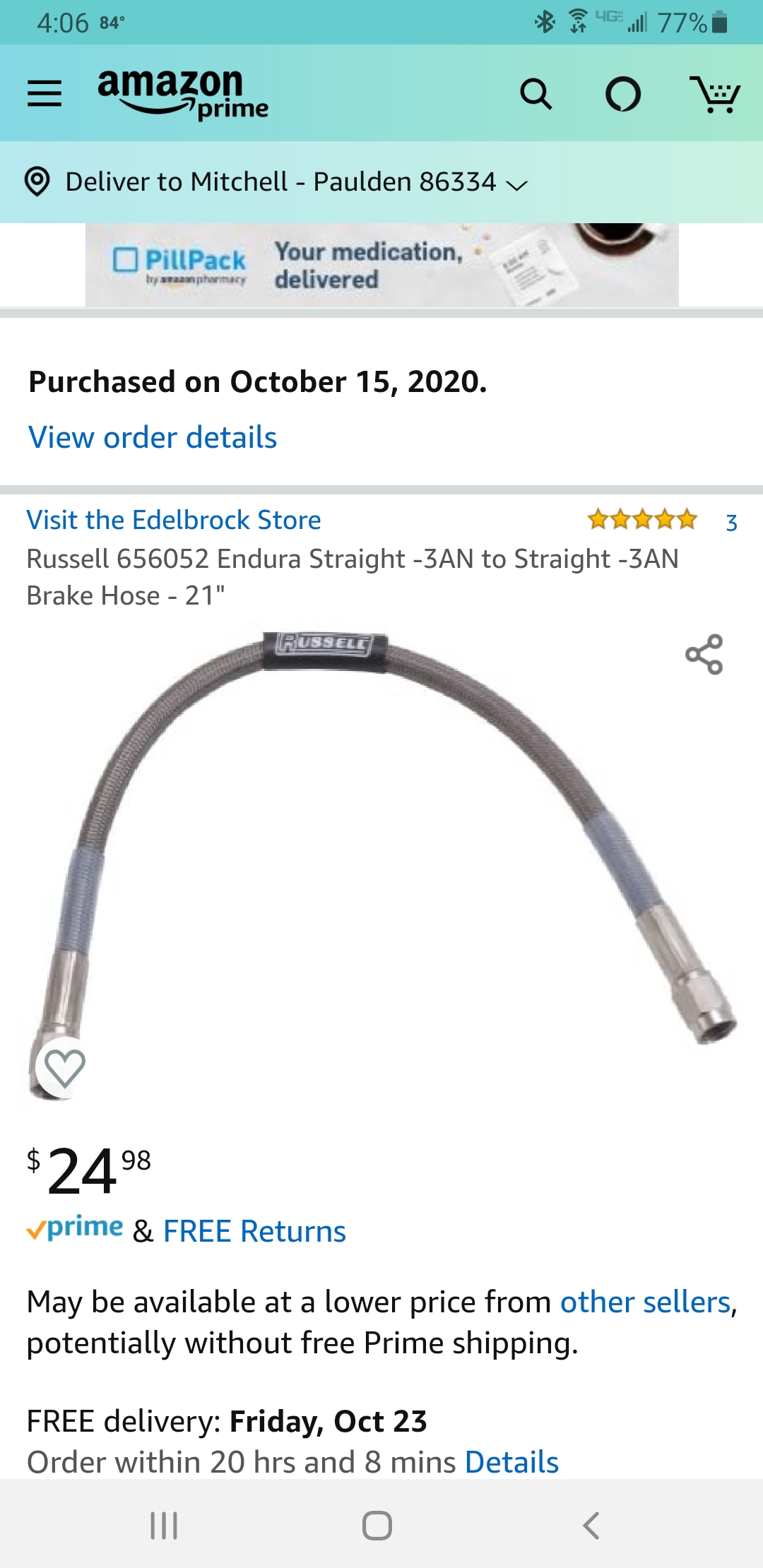

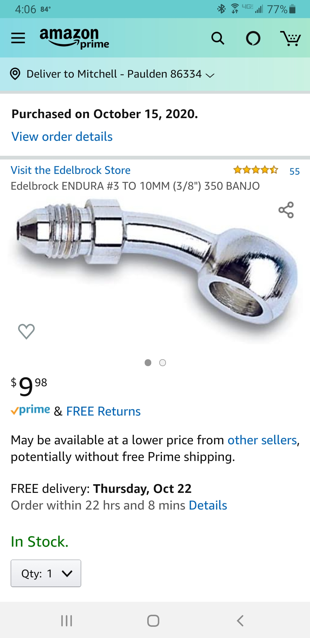

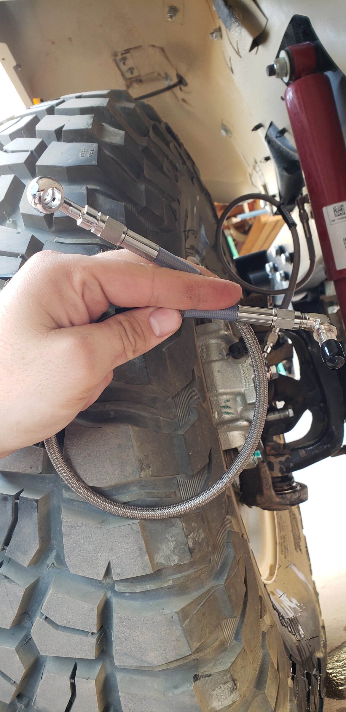

After removing the sway bar, and installing the longer shackles, I found myself needing extended brake lines. I didn't want to spend almost $150 with shipping for the OTR lines. So I set out to put together my own. I found that the brake lines are -3 AN. The Banjo is a 10mm (3/8). After a quick Amaozn search, I found the parts I needed. Once I get the lift installed, they won't look too long.
They arrived today. I wanted a 90° fitting at the chassis to clear the knuckle, and a 35° banjo to move the line away from the tire. I noticed the stock brake line rubbing against even the stock tires before I put 33" KM3's on. Anyways, here's what I got.

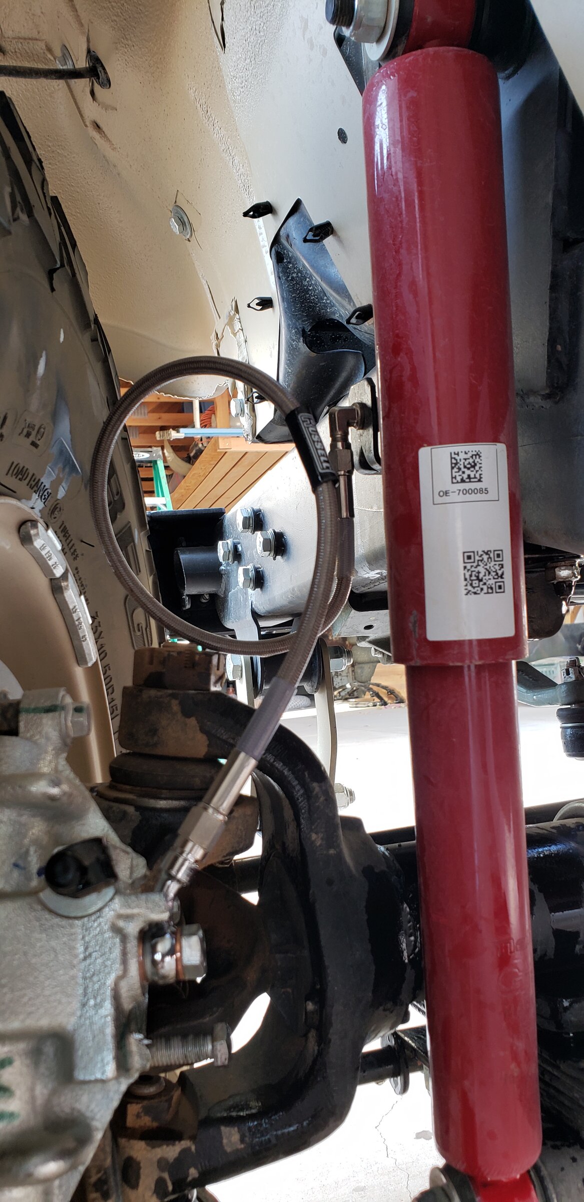

You might want to rethink that caliber banjo fitting, especially if you have adjusted your steering stops. I'm thinking even with the stock steering stop adjustment your going to be hitting that shock at full lock. Be sure to check it out sitting level and flexed and at full lock.
724
The 35 degree fitting doesn't hit. The bolt itself hit the shock. The axle is going to move forward a couple of inches once the new springs go on, so I might move the shocks completely.
1,201
I couldn't tell from the pics. Just knew it might be close. Yea if you can relocate the shocks that will definitely give you room to adjust the steering stops.

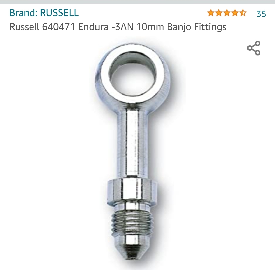

I drive it all the time in everything but mud. It works great. I didn't like how close the passenger side banjo fitting was to the shock, so I got a straight piece and installed it. It's perfect now.
