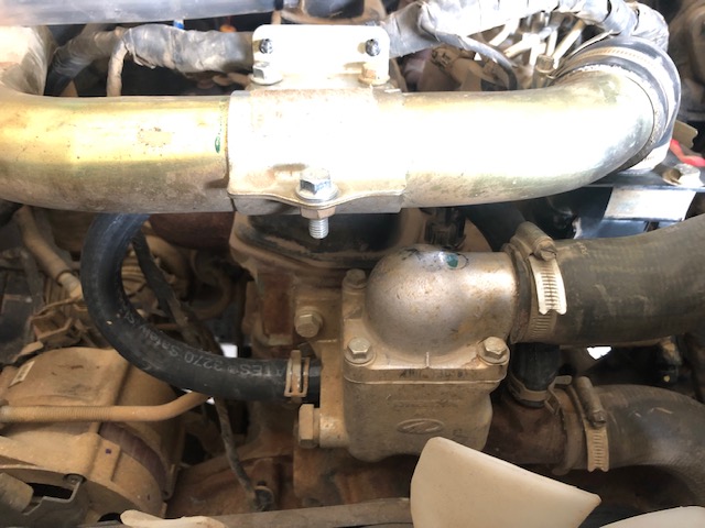

EGR removed as well as Intercooler. I capped off the Coolant lines but the Caps on the lines are swelling up and already cracked. Would you replace the caps (about 2 months old) or loop the coolant line from the discharge to the Intake?

I just finished mine and ended up using about a foot of 5/8" heater hose to make a loop connecting the discharge and intake. It was easy and I have no leaks.
