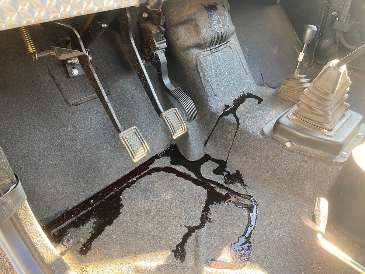

My Roxor is one of the 2018 specials that came with a hard top, light bar, and winch. I also had my dealer install Warne Locking Hubs, turn signals, and mirrors to make it street legal here in Utah.
I bought the machine in September of last year and used it for hunting last fall, but did not use it much during the winter. I had no issues with the heater. I started using it a lot this spring and have been using it for deer and elk hunting. My first trip up the mountain this year I ran the heater and the next morning I found a puddle of fluid underneath it. I figured out it was anti-freeze leaking from the heater and did not use the heater the rest of the trip. When I got back, I took the machine to the dealer and they claimed they could not duplicate the problem. I went back up to hunt early this week and it leaked again.
I suspect that the dealer did not run the heater with the high speed switch on and for this reason could not duplicate the leak. I have a call into them to discuss how to proceed from here (they're 45 minutes away).
Has anyone else experienced similar problems with their heater?

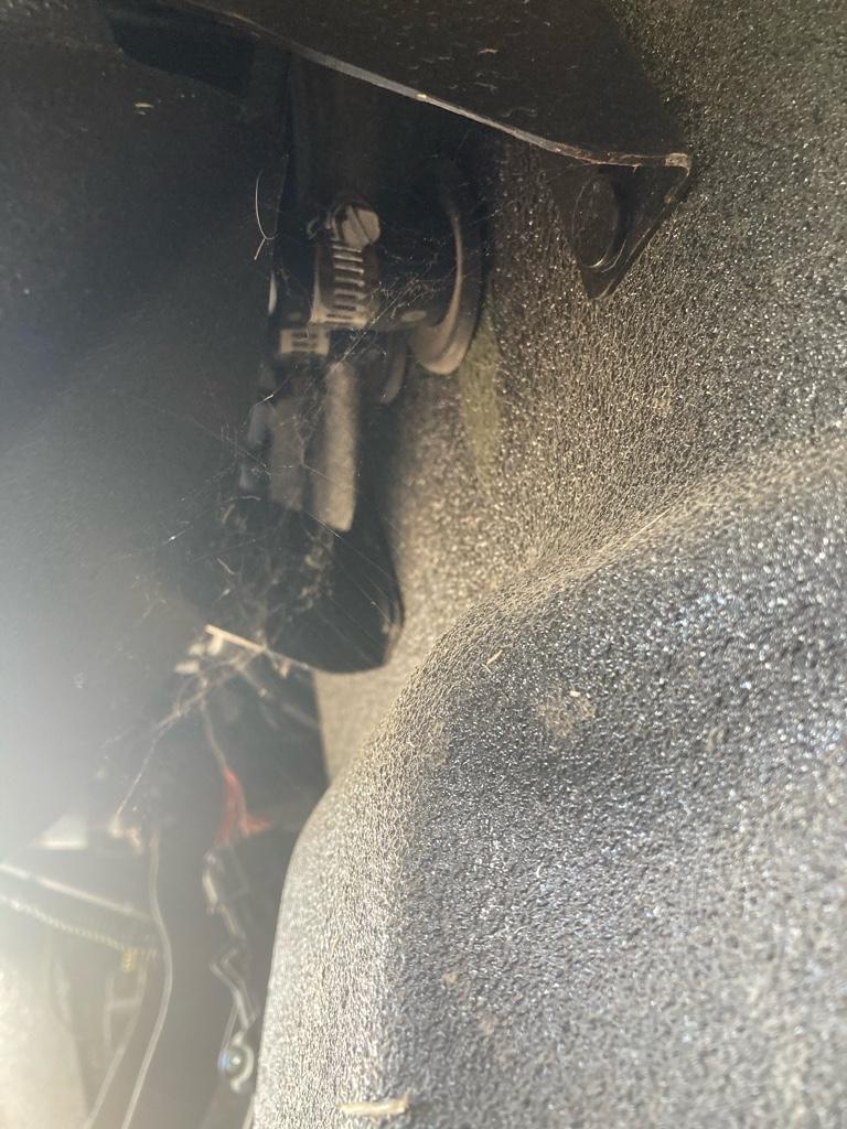

If it’s a factory heater core look under there and hope they installed the clamps where you can get to the adjuster. I tightened mine up after the unit was in just for this reason otherwise you’ll have to remove the whole core to get to them. When I first installed it I had a similar leak. One clamp needed be tightened a little more. Was very easy cause I made sure I could get to the adjuster screw. I suspect that is what your problem is.

It only seems to leak after the Roxor has been been shut down and the machine has been sitting overnight.

when it warms up the coolant tubes In the heater coil expand. When it expands any potential leak is sealed. Once they cool they contract and the heater hose to tube is no longer sealed good. Have run across this with coolant lines leaking after temps drop in the winter. They leak sitting still overnight but never leak while running. Typically it’s just a clamp that needs to be tightened a little more. Take a peek under the dash and either a flat head screwdriver or I think a 5/16 wrench a (May be metric, not sure) should be to tighten the clamp up. Probably only take 1/4-1/2 turn to stop the leak

Just lie on your back and try not to get it ll jacked on the tub door opening. You’ll be able to see the two hoses coming to into the coil. Like I said earlier hopefully the dealer oriented the clamps in a position where you can get to them. you don’t want to remove the core if you don’t have to. I had a hell of time getting some of the bolts to line up on mine. Not sure how yours will be, my drilling could have been off. Plus it’s more work if all you need to do is just snug a clamp some more.

The second leak (in the photo) occurred after the dealer had supposedly fixed it and I used the heater driving up to 10,000 feet from my home at 5700 feet.

This is mine looking from the passenger side.
