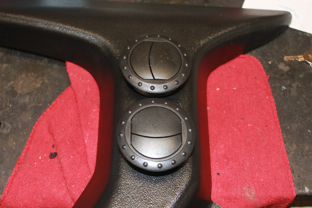

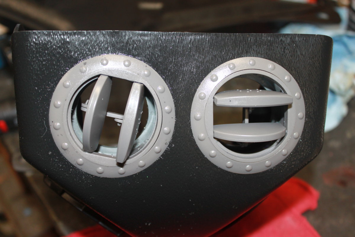

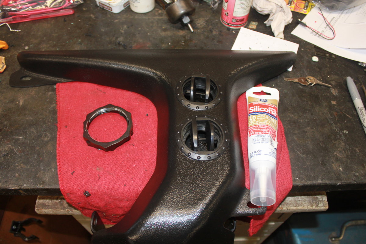

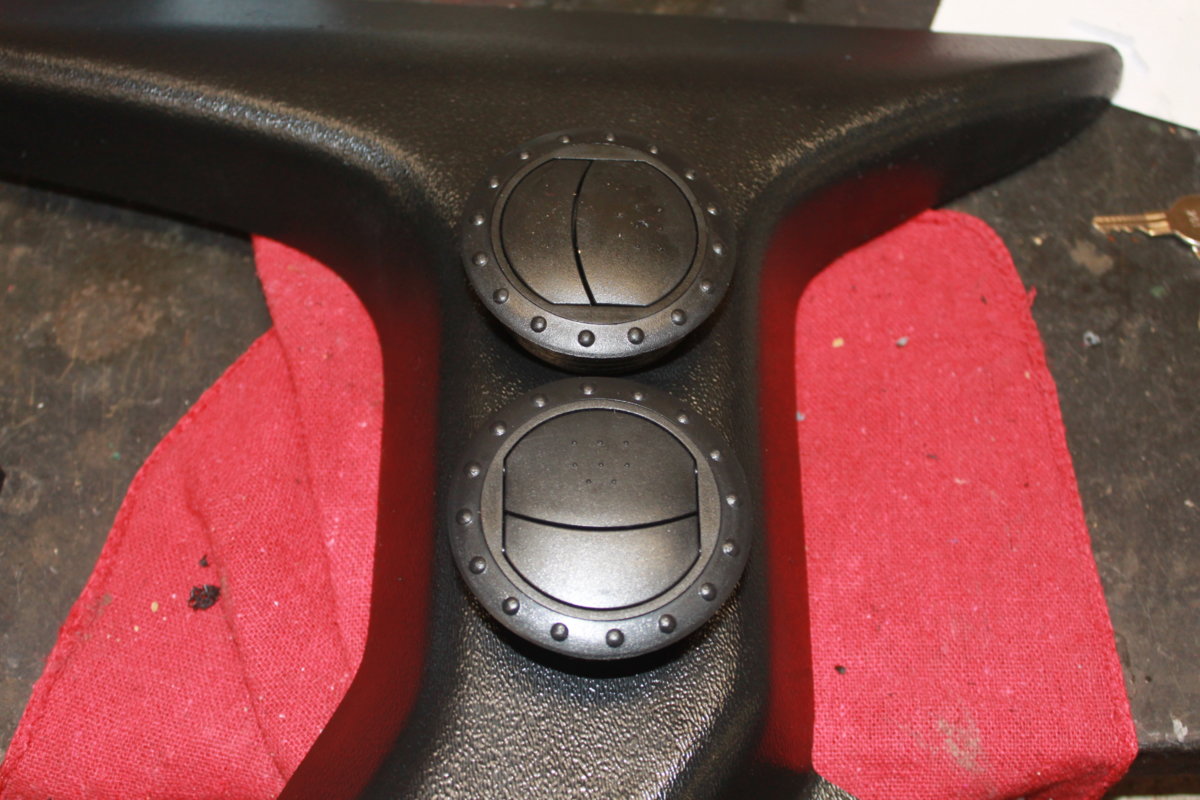

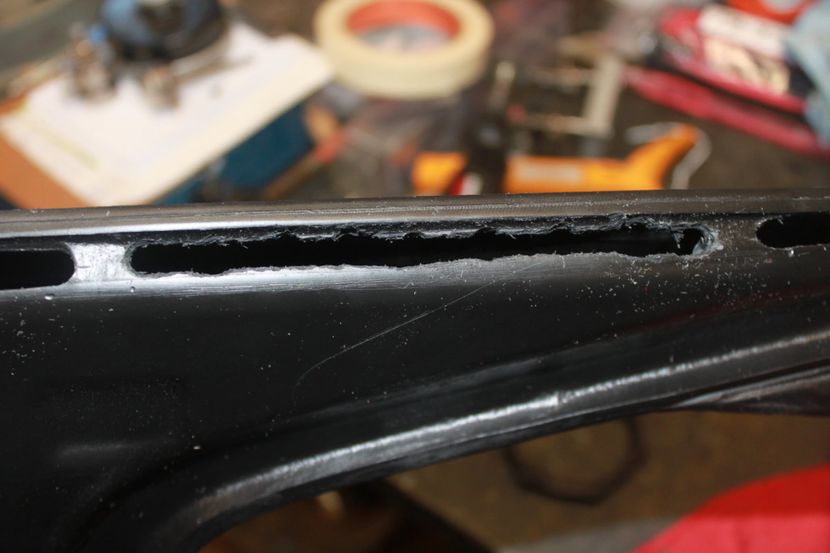

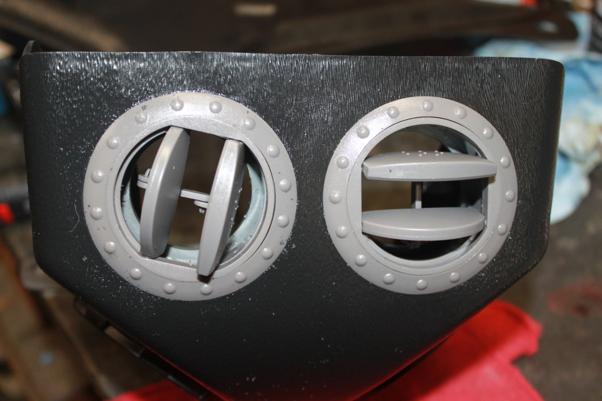

This is a Bister inspired mod to the Roxor OEM defrost kit. I purchased a set of 4 swiveling vents from this eBay vendor:
4Pcs Adjustable RV Trailer Yacht Side Roof Round Air Vent Ventilation Outlet | eBay

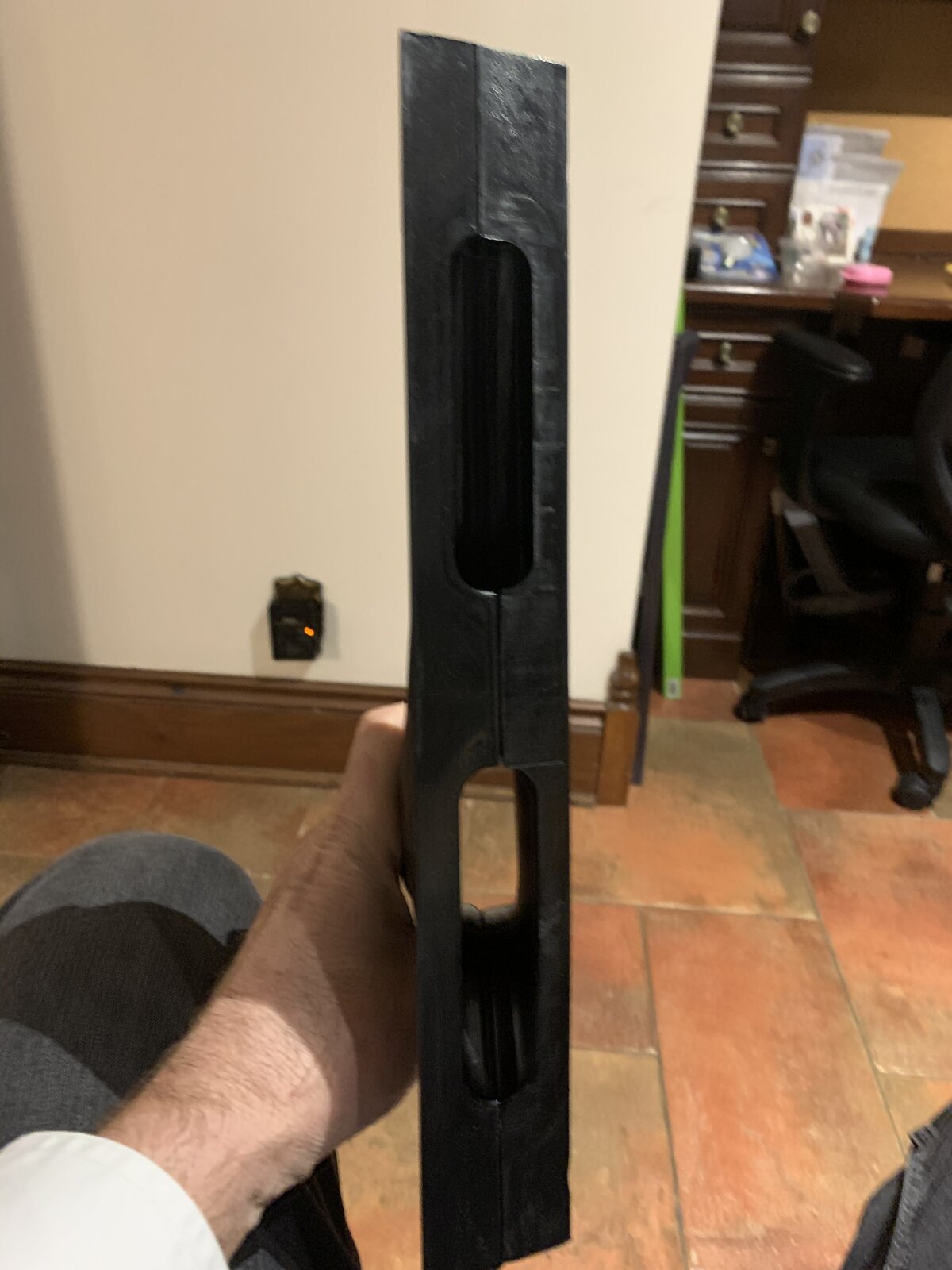

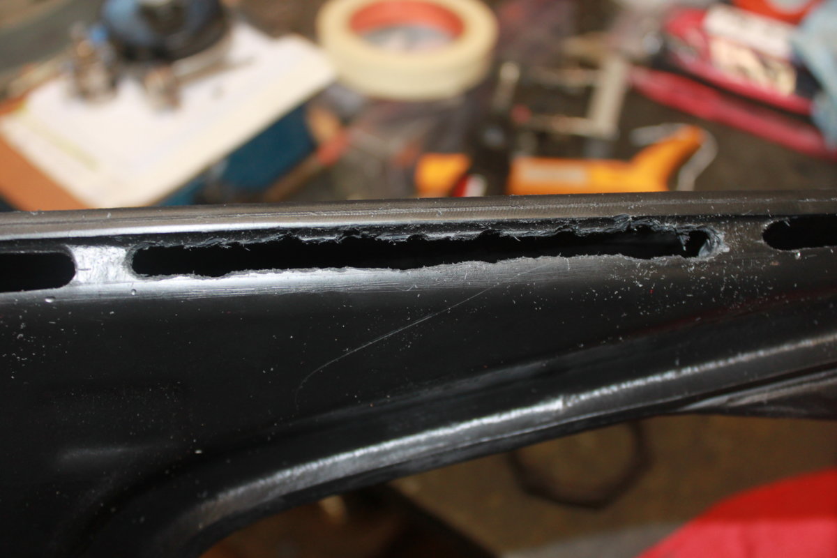

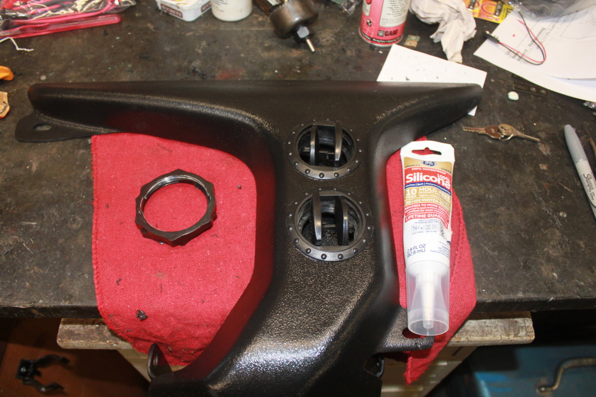

After trimming the tubes to within an 1/8 inch of the threads, I was able to cut 4 holes in the body of the defrost unit. The gray ones I mounted in the back, while the two black ones were mounted in the vertical column. While I was able to use the nuts on the back vents, (with a bit of trimming) there was no way to mount the nuts behind the front vents, so I made the holes a close fit and used RTV to seal them in. 2 5/16 inches would be about perfect, but I only had a 2 1/4 inch hole saw, so it was that and some dremel work to make them fit. I also cut a slot as Bister suggested in the defrost vent. I'll post again once I have installed this and can report on how it works.

Sweet. That will open it up nice and give you your air flow back, and being able to still close off the bottom like the original design will keep your good flow out the front/top. Nice. Thanks for sharing.

I was able to install the defrost kit yesterday. Temperatures in the 40's so no frost to remove, but I took a few readings with a pocket anemometer made by Extech. After a warm up and run around the property, all vents except the new front facing vents were throwing out air at 125+ degrees F. The two front vents showed 89 degrees. Also, the air speed was about 1/2 to 2/3 that of the other lower vents. This makes sense, since there is no scoop to direct air out, just whatever gets caught as the main stream rushes up to the defrost. Still better than nothing. The defrost vents ran to 120 degrees and only about half the wind speed, but this last was probably due to the difficulty in getting the anemometer to cover the air holes; they are long and thin, while the anemometer pickup is 1 1/4 inches in diameter.
I also tried different combinations of vents open and closed to gauge their effect on each other. Opening a second vent did not seem to reduce the airflow or temperature. Opening two bottom vents and one front vent caused a reduction in air flow from the front vent, but the same temperature. Since the front vents are only siliconed in, I could try to take them out and find a way to scoop some air into them, but that is for far down the road. For now, I am satisfied.

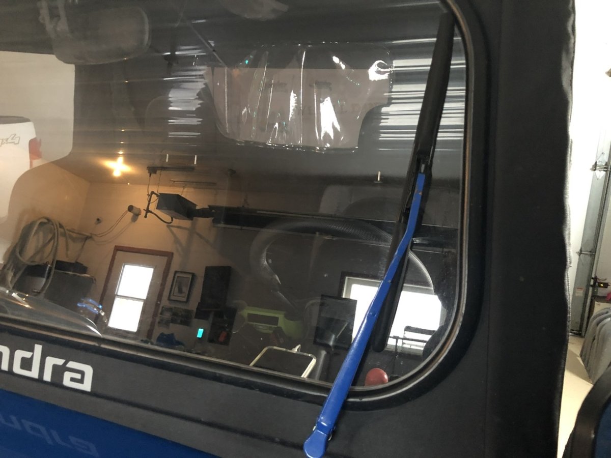

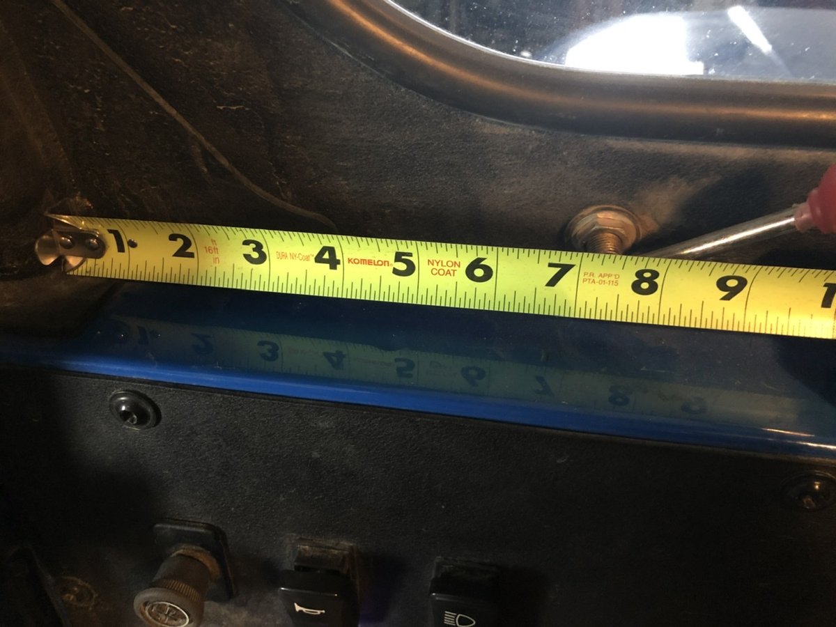

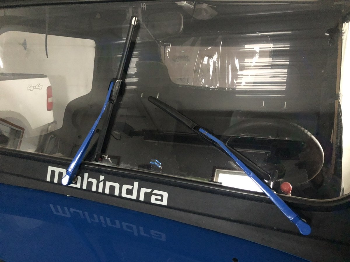

I think these ones would be the right size. My drivers one could be a bit farther to the right side by a couple inches. It's about 6" from the roll bar, 8" would be better to match up with the passenger one and give a fuller sweep. I can get a better measurement if you want. Mine had 16" blades and 14" works better. Mine came on a slow boat from China and we had to cut them down. The arms were too long. This is the arm length you need I think.

Here’s how my wipers line up. This is why I would move my drivers side in a bit. At least 2” more. It’s at about 7.5” from the inside of the ROP now. It would give a full sweep and I would be looking through the highest part of the wiper arc. Now that arc is off to my left. Also my wipers would meet better.

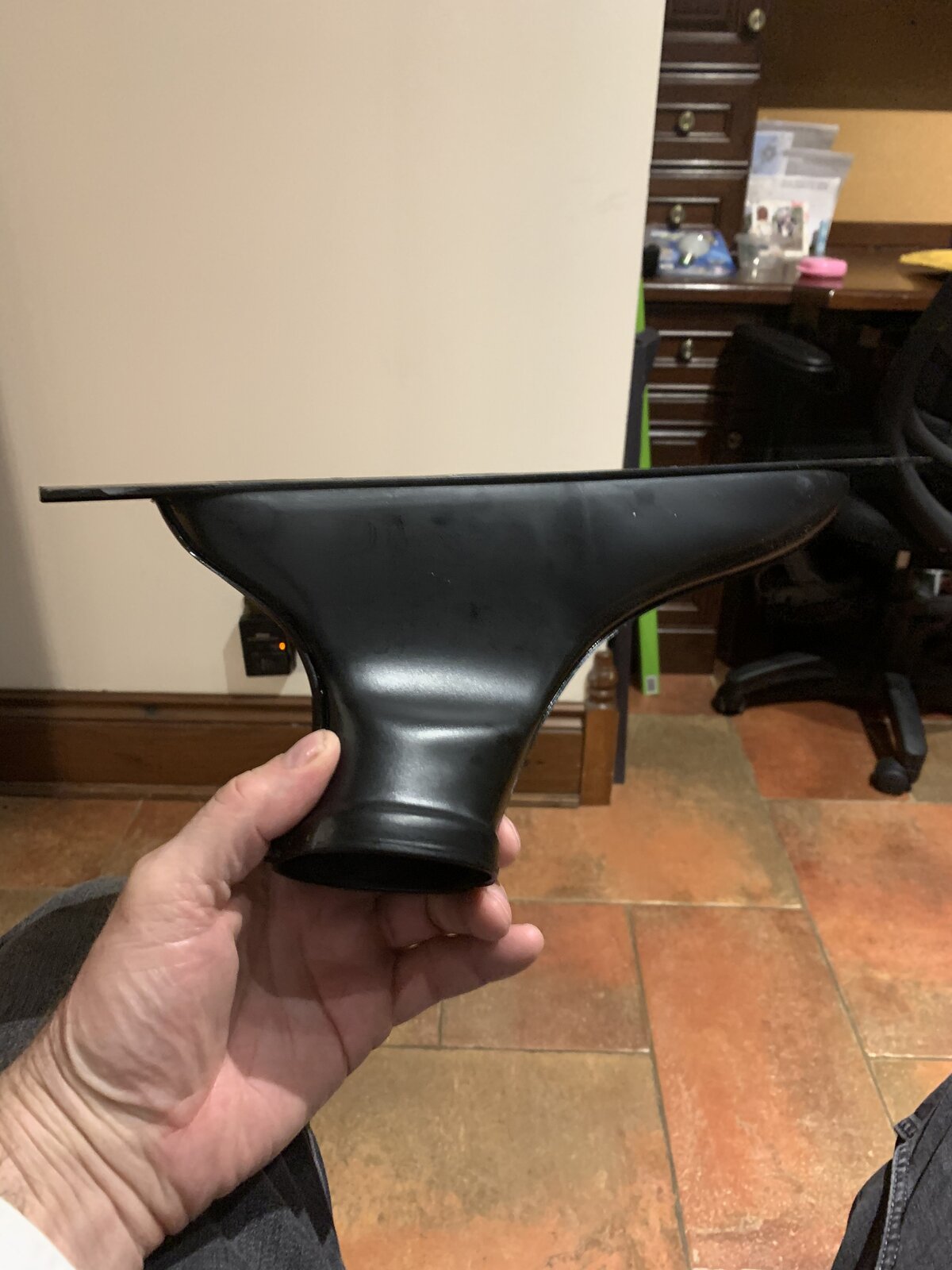

Found this Cj2 duct, just got it and hope it fits but its gonna be sweet...
