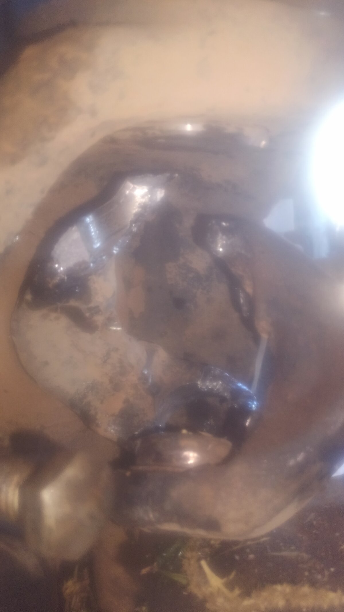

well i got a little two crazy with my roxor yesterday and broke the left front axel shaft. Sherwood tractor is sold out of both sides. any idea where i can find one?

I assume it’s past the point of just replacing the u joint. Assuming that’s what broke. I‘d try calling on the Rox or dieselfreaks and see if they have any take offs. climax off-road might have some as well

Pull your shafts and swap the u joints out to some spicers. From what I understand the stock u joints have been a weak link and when they go then there has been collateral damage with the yokes.

I agree with txriakkill that is what happened with mine. I layed it on its side and was on it hard to get it to walk out. Than bang. I have heard many times the stock u joints suck. But I had not gotten around to changing mine out before that happened.
