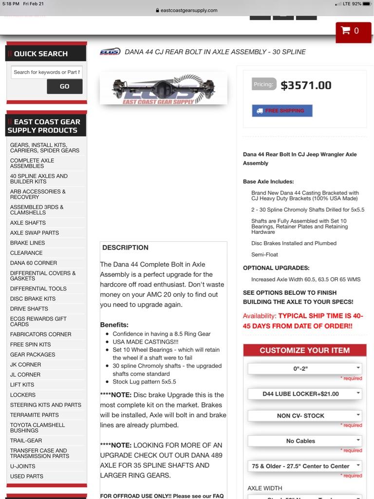

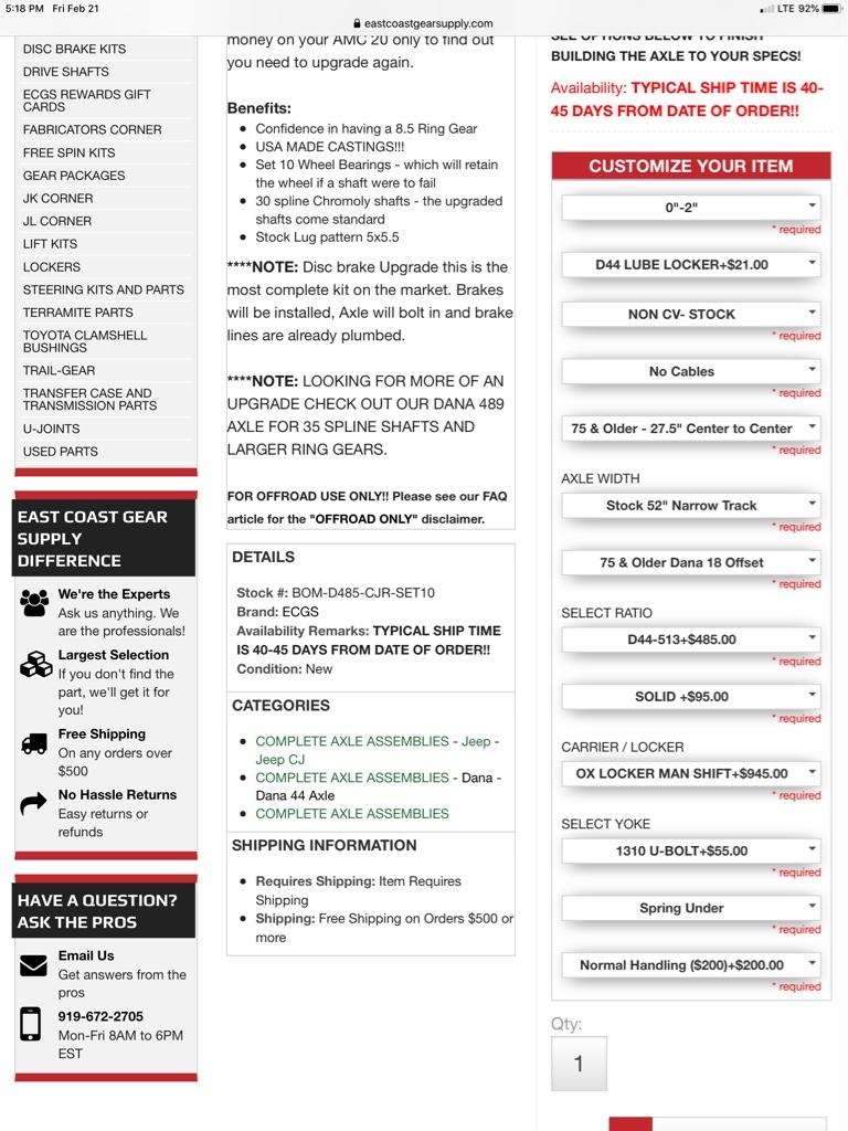

So I was looking at east coast gear and supply at custom built axle assemblies JEEP CJ COMPLETE BOLT IN AXLE ASSEMBLIES
it looks like we can get new built axles for front and rear with the correct offsets And even wide track width or wider. I awhile back I had it figured around 5k to do the gears. Lockers and chrome moly axles to the stock axles and that wasn’t including labor. Building a set from east coast looks to be around 7500 (grizzly front, ox rear). And the rear axle comes with disc brakes. Looks to be a possible comparable expense with better results. Just wonder about the proportioning for rear disc brakes and the steering mods needed for the front axle. All in all it looks good. Maybe just a rear swap. That part alone was very close to just the parts to upgrade the stock axle. Thoughts?
1,208
So for the rear we have about a $1200 for the full float. Another $1000 for the Ox. Not gonna include the cable since it’s the same cost for either option. Another say $400 for the gears. Then say $400 for the set up. So we’re looking at least $3000 in the rear axle. The build I have includes a lube locker gasket and a diff cover that’s not include in ,y rough estimate. That only brings the difference closer. So we’re about a $600 difference and the new axle has disc brakes. This not counting any additional parts needed to run the rear discs.
