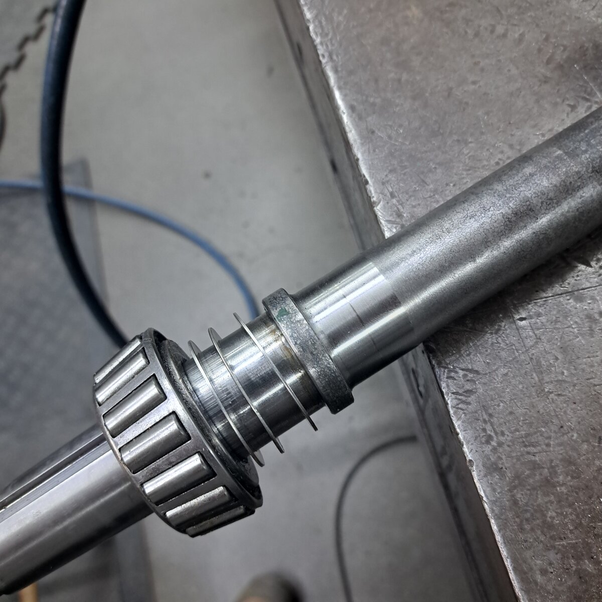

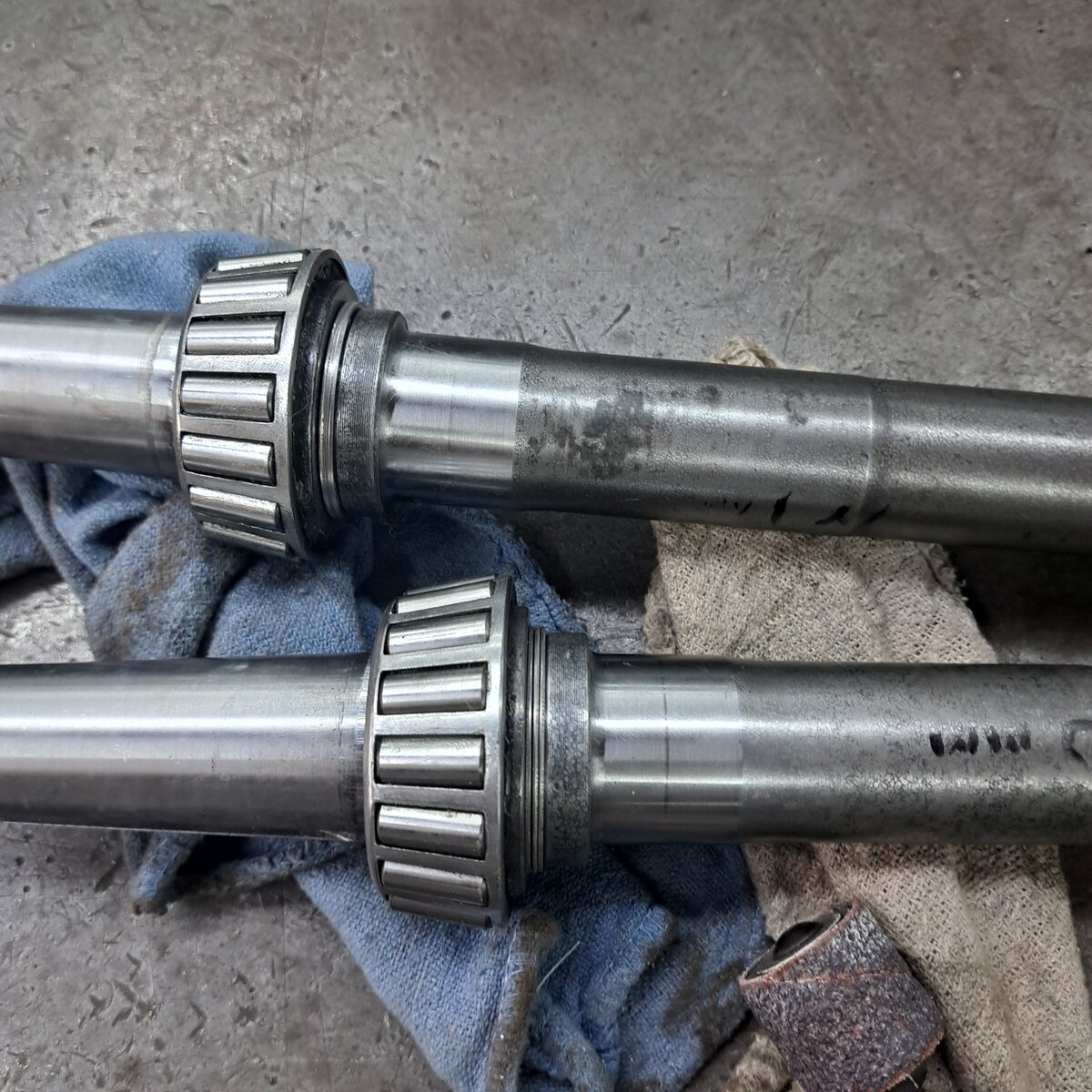

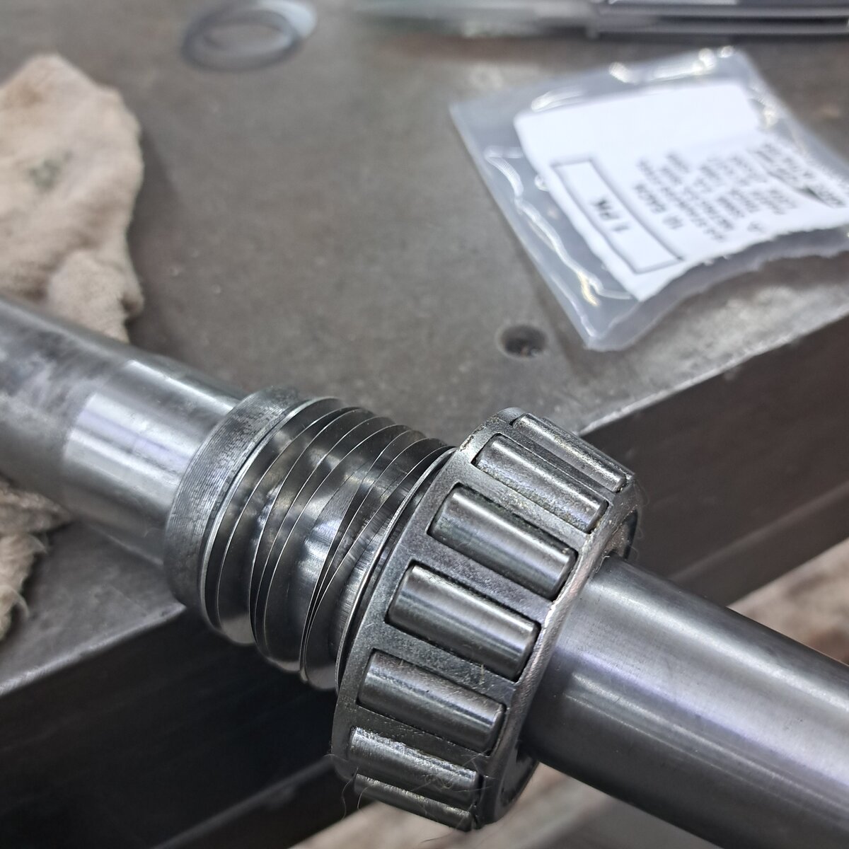

Finally got the hub puller I ordered. I pulled both axles this morning, cleaned everything well and put them back into the axle housing minus the outer races. I pushed both axles into the diff until they bottomed out and measured the distance from the outer axle flange with the shim in place to the inner bearing race. Left side measures 2.99mm and right side measures 2.66mm. I just ordered shims from McMaster Carr. They stock 35mm I.D. x 45mm O.D shims in various thicknesses. I ordered a pack of (5) 1mm shims and a pack of (10) 0.1 mm shims I plan on using three 1mm shims behind the bearing on the left side and two 1mm shims plus seven 0.1mm shims behind the bearing on the on the right side. That should give the bearings a slight bit of preload.

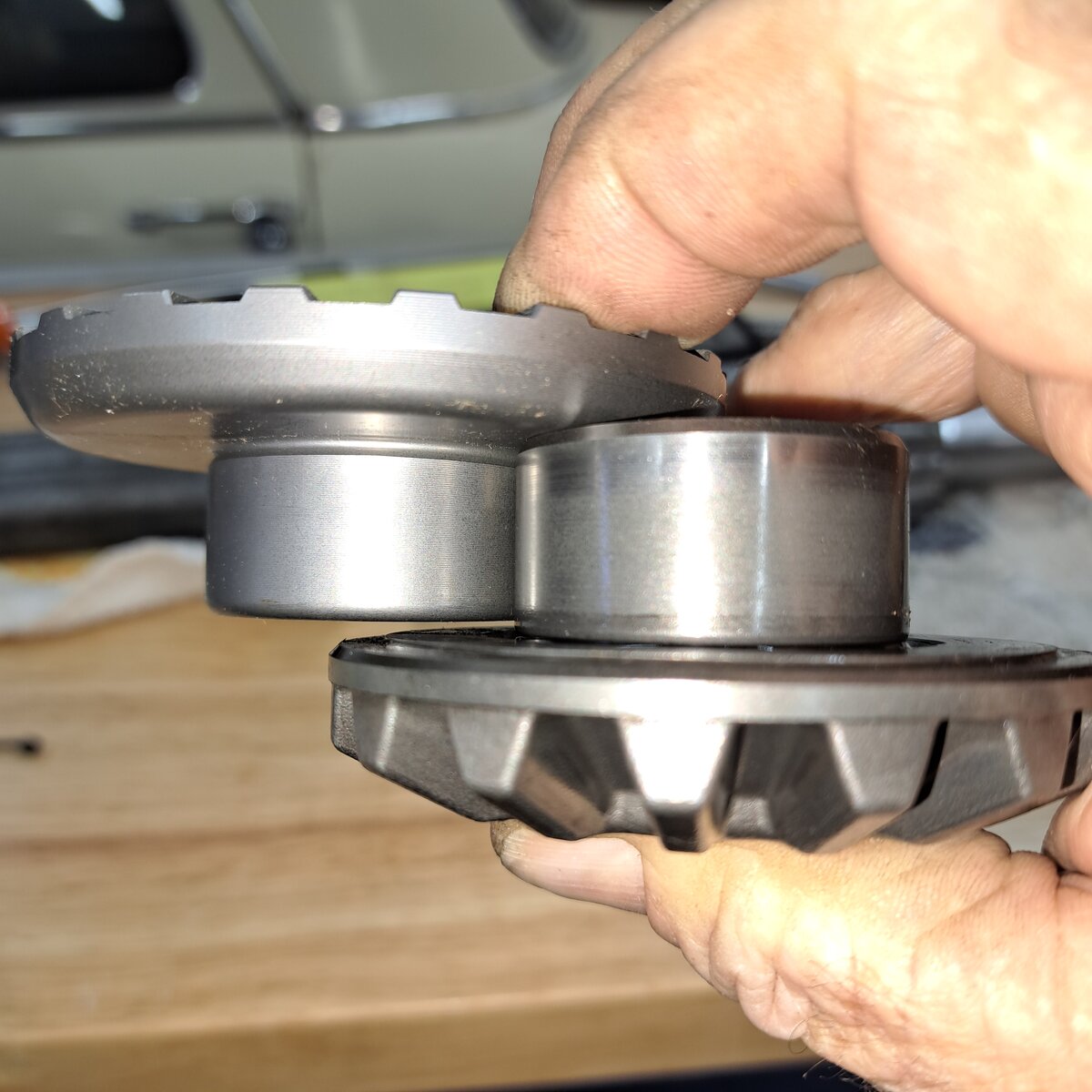

Got the shims installed and it did take the axle play out. I did have to slightly open up the diameter of the shims with a small drum sander. In comparing the drive flanges from the old Dana open diff and the Torq Locker there is quite a bit of difference in length between the two. This might account for some of the axle play after installing the lockers I'm thinking.
