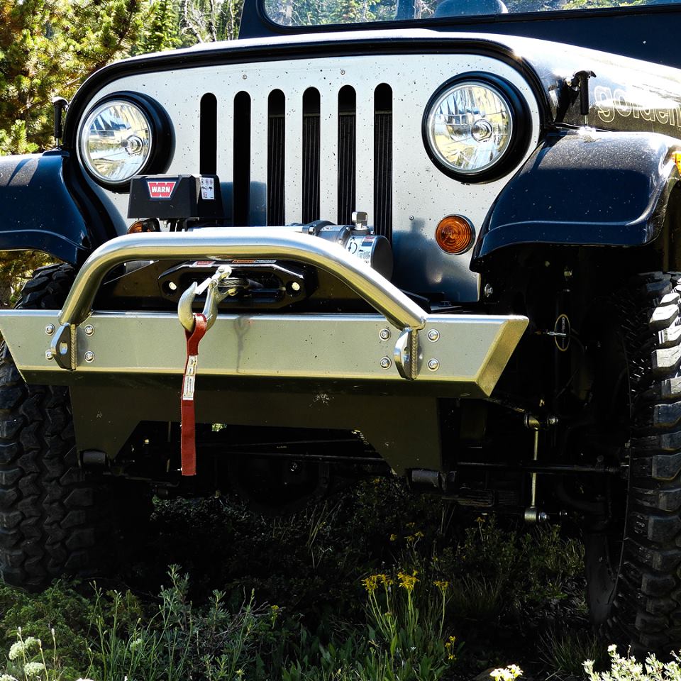

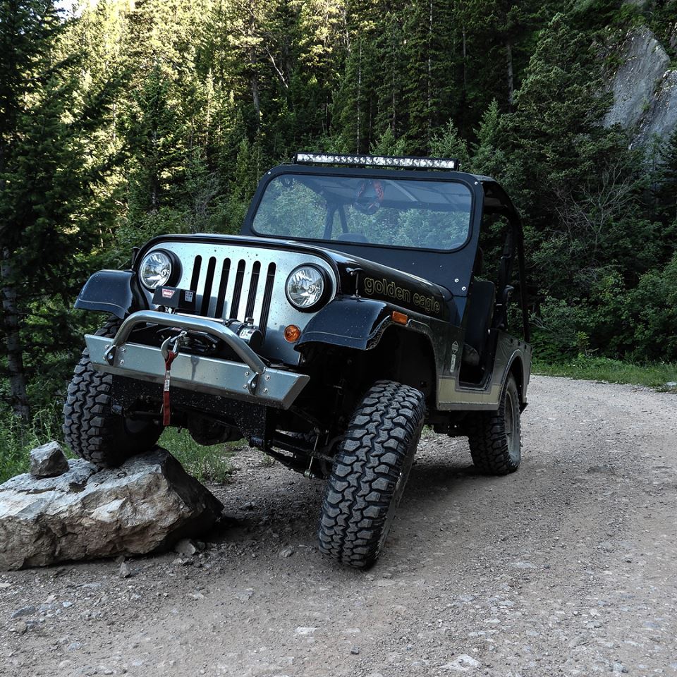

We have a 2.5" shackle reversal kit for the front, to level out the Roxor! I will attach some photos. We are also working with a leaf spring manufacturer to possibly build some 2.5" inch and 4" lift springs if there is enough interest. Down the road, we will offer a 4 link kit as well!

You can clear 33 inch tall tires on the stock wheels with very minimal rubbing at full lock with just our Front bumper. If wheels are swapped out for ones that have the correct backspacing, you will not rub at all. Our 2.5" lift kit levels the Roxor, and the 33 inch tall tires look much better over stock.

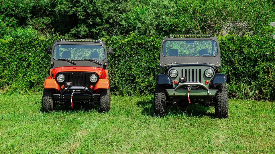

Here is a few pictures of that Shackle Reversal Kit. The black Roxor has the 2.5" leveling kit up front, next to our red Roxor on stock suspension, and stock tires.

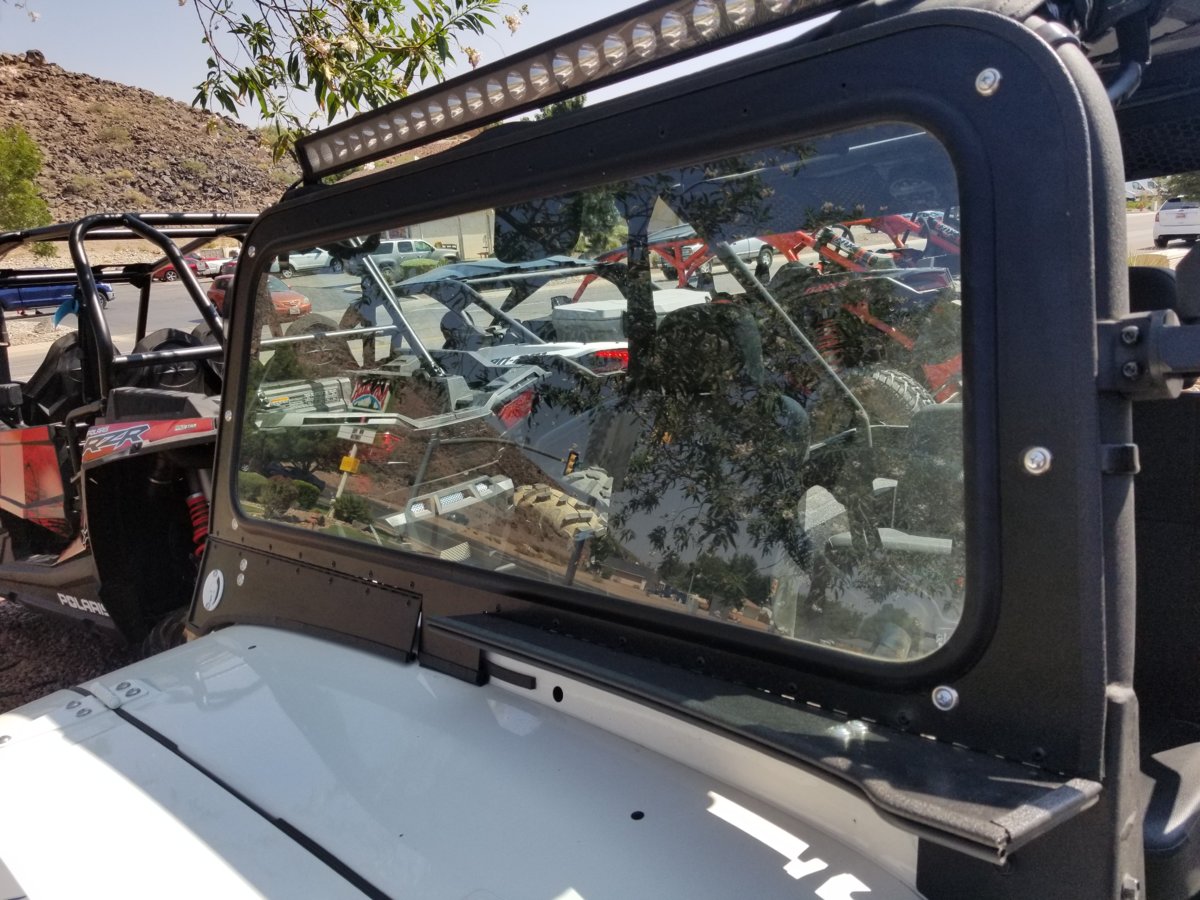

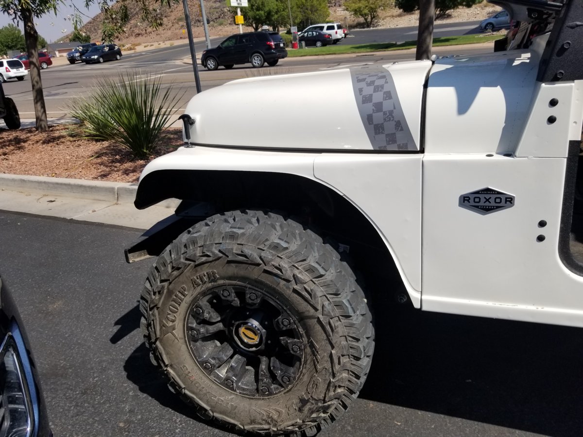

We have a leaf spring add a leaf up front I can ship. We fit 33x10 with spacers no problem we did cut our fenders to get articulation. 150.00 for the add a leaf in front. Attached are all the costs of everything else we have done, windshield is 1000.00 but very sturdy and all glass. Message me for more details.

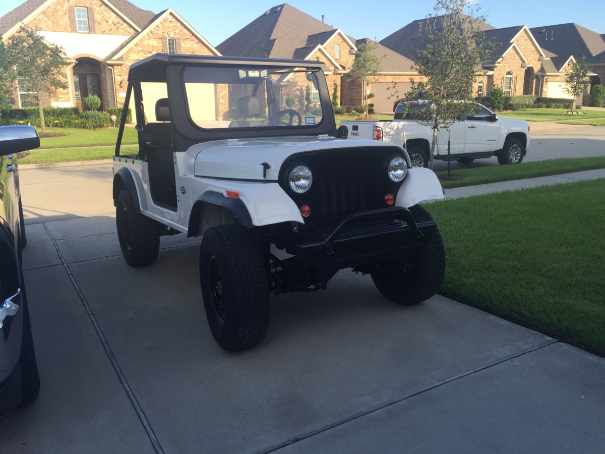

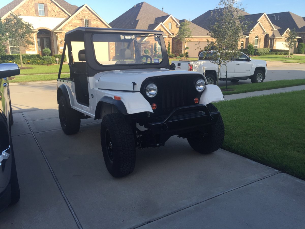

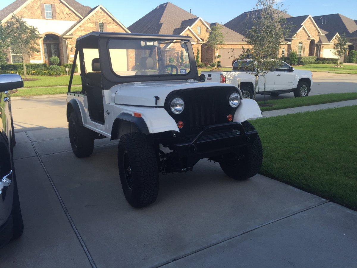

Got my Lift done from On The Rox. Drove it around town today and it rides awesome. No bump steer, smooth ride and I haven't aligned it yet. The parts are extremely tight, which is a good thing. The last thing you want is loose fitting components on your front suspension. It was a lot of work but it was worth it after getting it done. There is a little rise in the front but it leaves room to add a winch with no sag.

There is zero binding. My tires are 265/75/16. 32” approximately. The install is not an easy bolt on affair due to Mahindras manufacturing tolerances. Expect to use your die grinder. Everything fits right and tight which means your Roxor will drive like it is supposed to. Both the front and rear are dropped equal amounts so your Caster will remain to factory specs.
