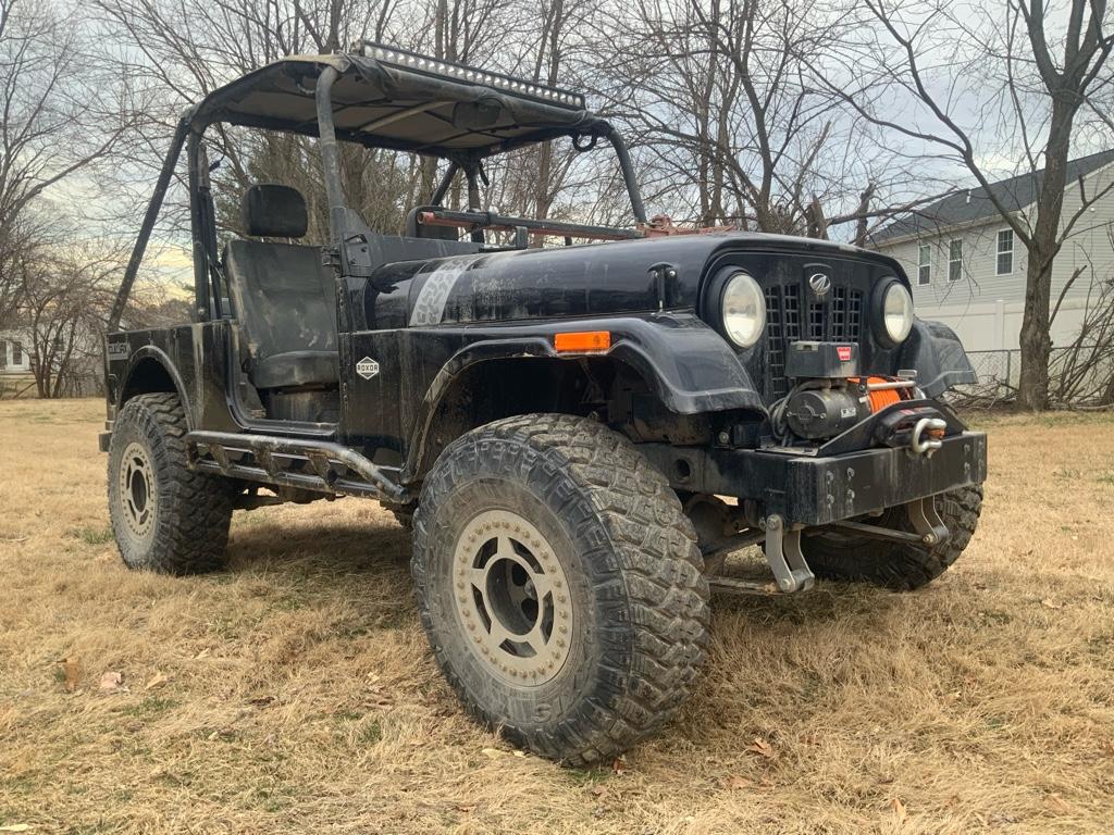

This is my roxor when it was on just a Climaxoffroad.com 1.5 shackle lift. And Bart 3 inch back spacing Bart wheels. I added a weld on bead lock kit. No spacers. 33x10.5r15 maxxis razr tires.
