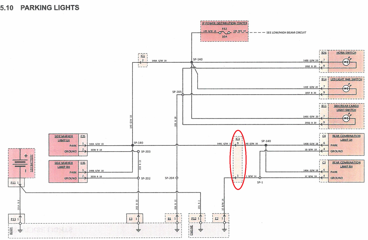

That's just it, the source is straight from the battery and is the same for all the turn signals, only the rear come on with the key not the fronts. Not sure what is up. All function correctly with use of the indicator just the rear stay lit with the key.
me1.0
Aug 6, 2020
29
Lebanon, TN, USA
6136
Just to better show what I did. In the diagram IC3 (red oval) appears to use very little of the actual connections. I cut the yellow/green and red/green and connected to those wires for my turn signals. Did this complete some daytime running light circuit and if so what can I cut to break that circuit? I didn't touch anything else in this connector.

me1.0
Aug 6, 2020
29
Lebanon, TN, USA
6136
With the help of a very knowledgeable friend found out the problem was the indicator (trucklite 900) instructs your to splice into the brake light switch. This is not necessary as the Roxor has brake lights already. Cut that connection and good to go.
