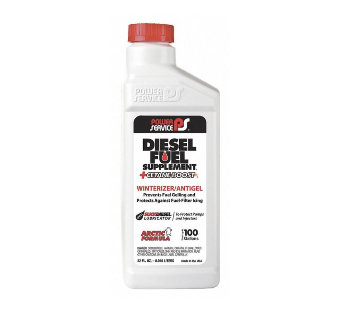

Diesel Kleen w Cetane and anti gel.
I use this in the winter. Couple ounces every time you fill up. Never had gelled your Diesel when using.
There is a summer blend. I use in summer.
difference is the anti gel.
I have absolutely had better MPG when using.
2,287
I have not used it, but I know most Northern/colder climate places sell winterized diesel. I agree with PineCreek I use the same stuff in my Roxor and HMMWV.
