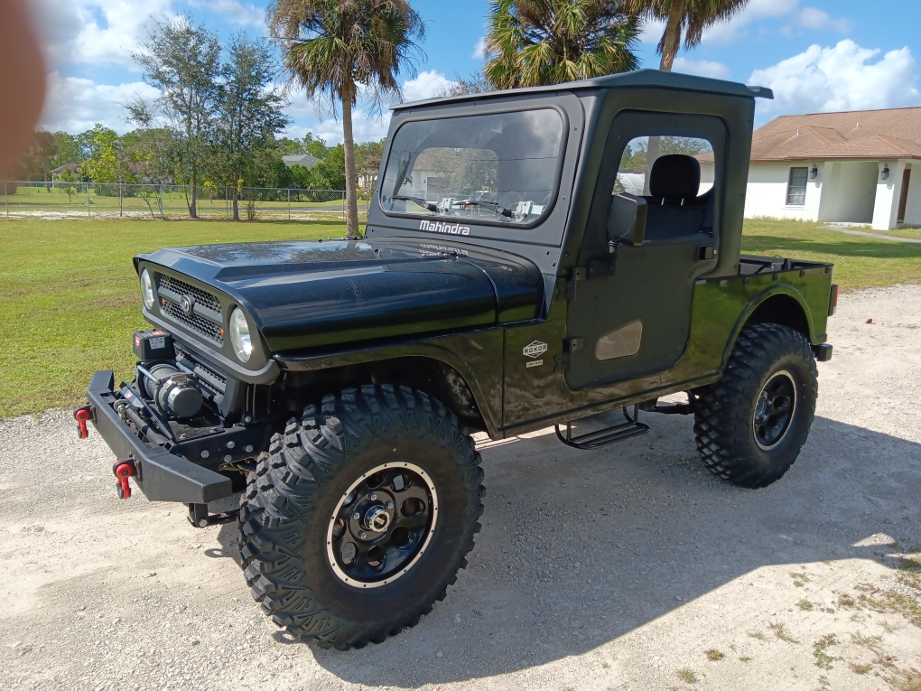

I have an all weather Roxor that came with the cab and windshield. I now have a rally top cab installed with the stock windshield frame and wipers. I am looking for a windshield frame that can use a glass DOT windshield, But I’d like to still use the stock wipers that came on the Roxor. Is there a frame that has holes for wipers that will fit the stock wipers? Or is there a windshield that comes with holes drilled for wipers?

For anyone who is wondering, I spoke to Wade at diesel freak and he recommended I take the roxor to a glass shop, and they can install a glass DOT windshield in the stock roxor frame. He said they have done it a number of times and to have the shop use the plexiglass windshield as a template. Once the windshield is mounted drill holes in the frame below the glass to mount the stock wipers.
