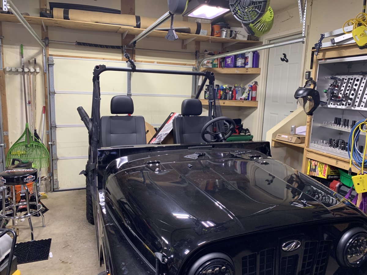

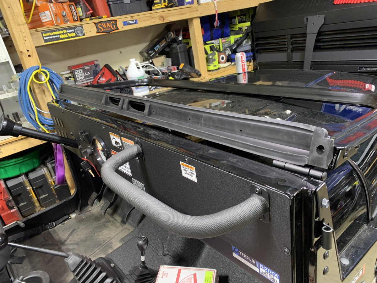

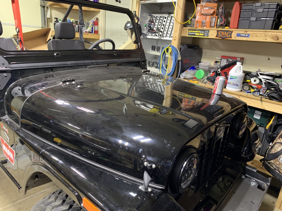

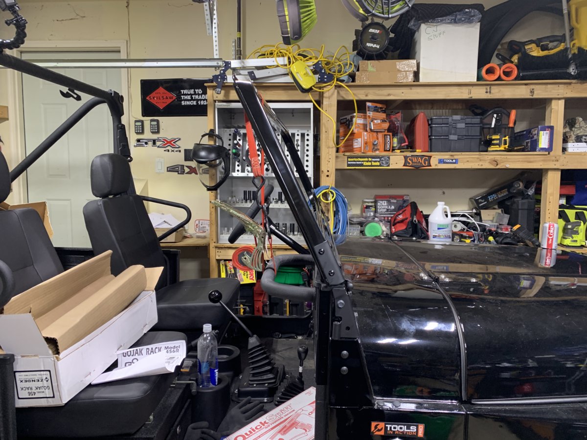

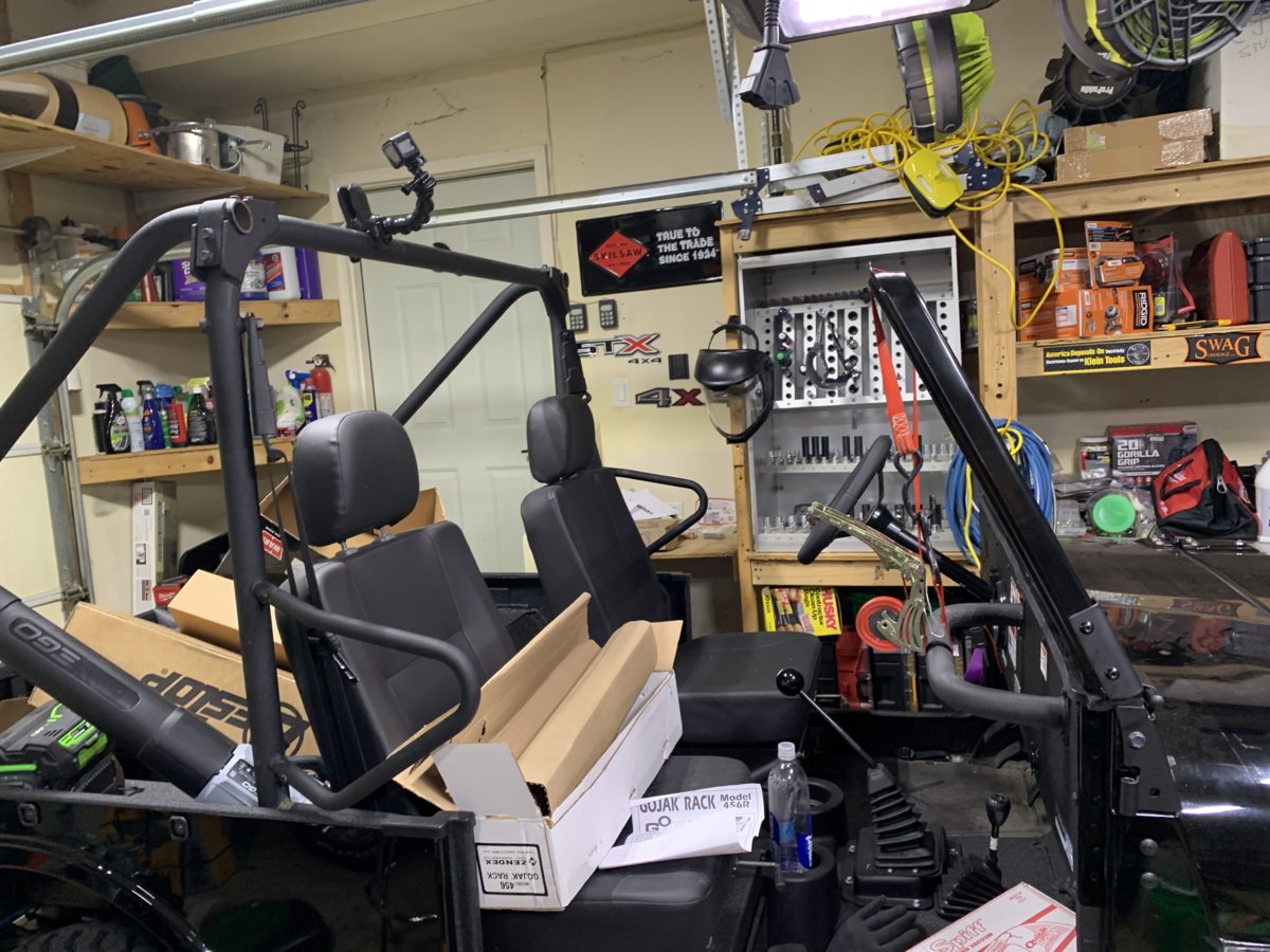

Inspred by @Steve243 I got my CJ windshield. It fits pretty good. I have to do some sheet metal work to line up one of the holes. I'm hoping to do all the cutouts in the dash, install gauges, signals, wheels, tires, paint, winch, lockers, locking hubs, vivid tune, EGR delete, seats, seatbelts, custom roll cage, KC hilight bar, tire carrier, new bumpers and put a radio in it before spring. :}

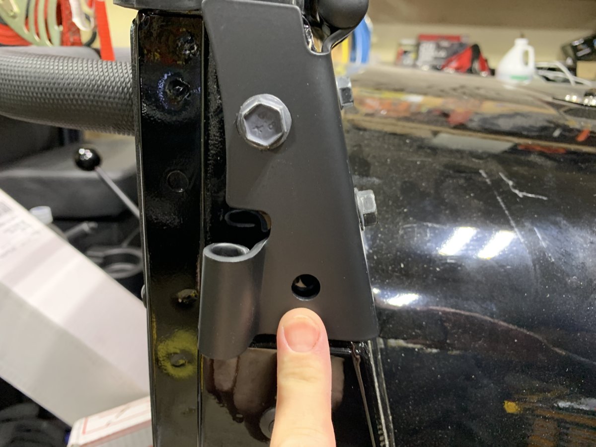

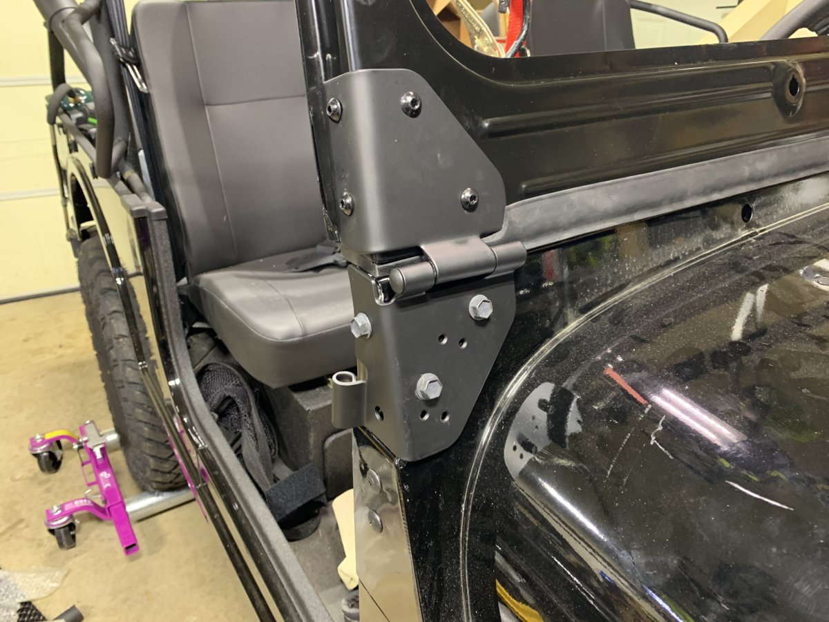

Which of your holes did you need to relocate to mount the windshield? I have all the parts sitting in my garage now, scratching my head, because the holes CJ7 hinges need milling/elongating or re-drilling in 10 of the 16 mount points. My windshield is from Crown, crappy quality as all the reproduction CJ windshield frames are. Hinges are Smittybilt 7403 and look like flawless quality. I'm not sure which holes are in the wrong spots: the windshield frame or the hinges? Yes, I think a couple other folks discovered that the Roxor hole nearest the door hinge flange is in a different location than the CJ7.

Yea I have a crown windshield also not the best but not many options. My Hinges are Smittybuilt also. Look at the pictures it is the lower out bolt that is misaligned so only 2 spots. Im going to have to fabricate and make a new hole I think.

im having the same issue, the windshield and dash are not flush with eachother, the windshield is at an angle creating a space.

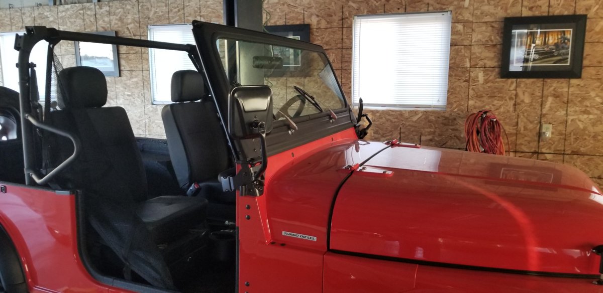

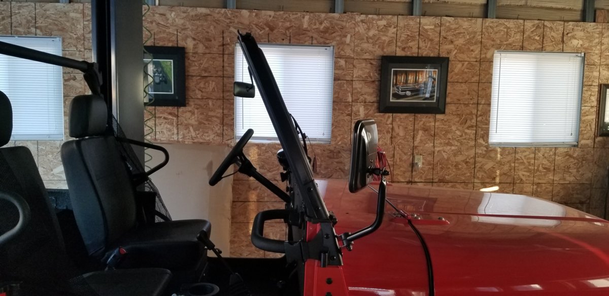

What windshield are you using? The Crown seems a bit too shallow for the ROXOR.
I've been wondering that a lot too. Roxor has storage compartments under the seats. My old CJ5 did not and that's why I'm sure the shorter CJ window is fine. However I'm 6'7" and I'm staying with the Roxor roll bar and Roxor windshield so I'll have enough head room. I think we should have a conversation about that.

FYI some owners have complained that the CJ windshield is too low and if you were to put a top on you'll have less headroom. I think this is mainly because of the storage compartments under the seat. It raises the seats up a bit higher than usual. I'm sticking with the factory windshield and I've painted it to match the body. That's a good result too.
