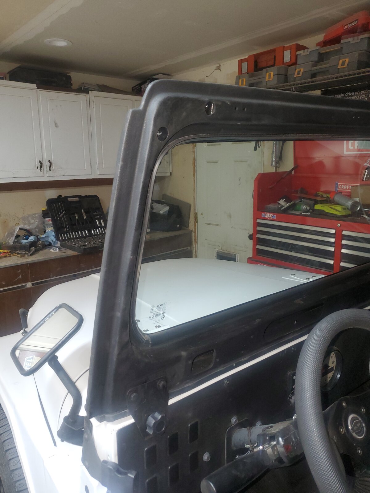

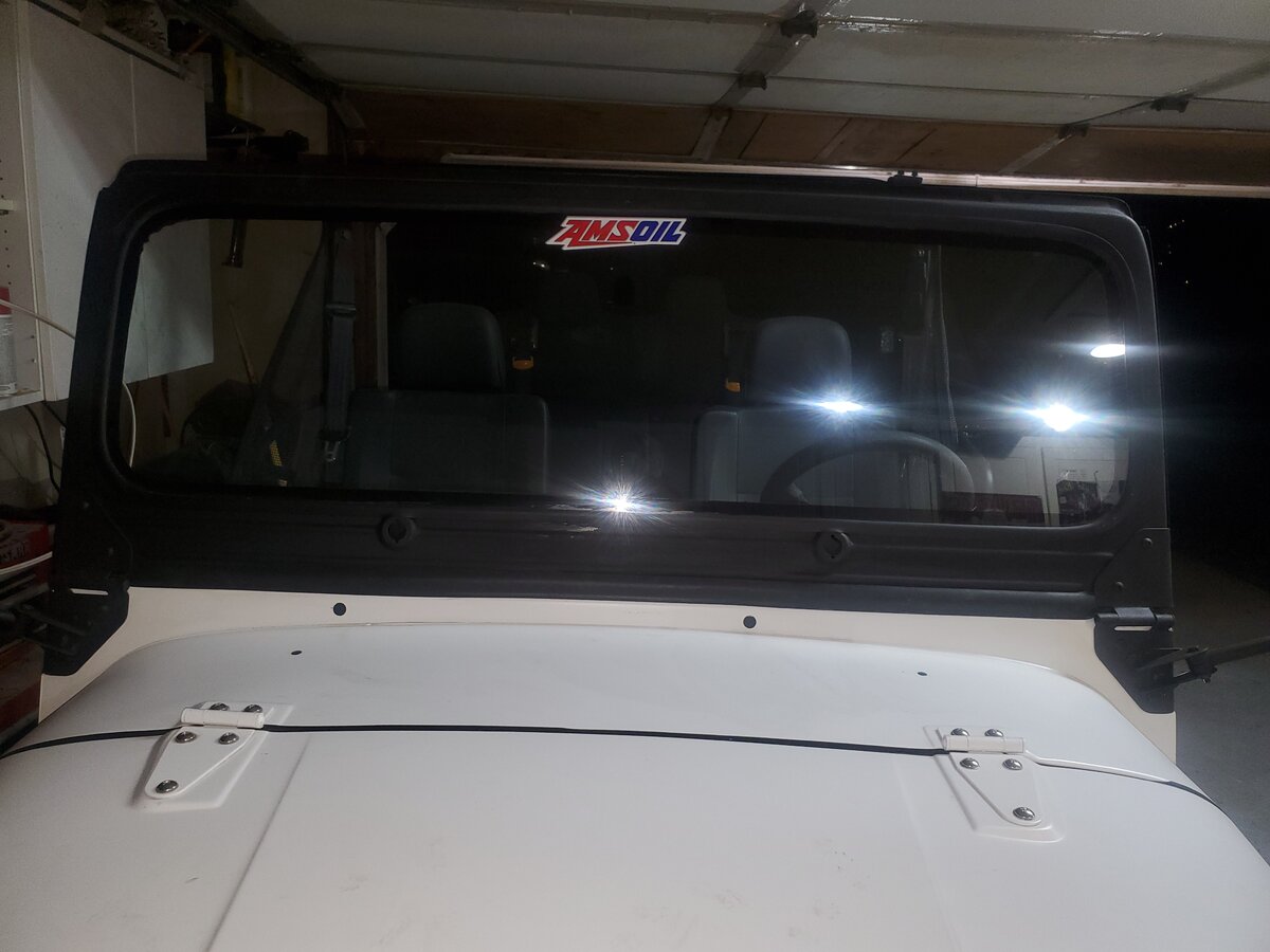

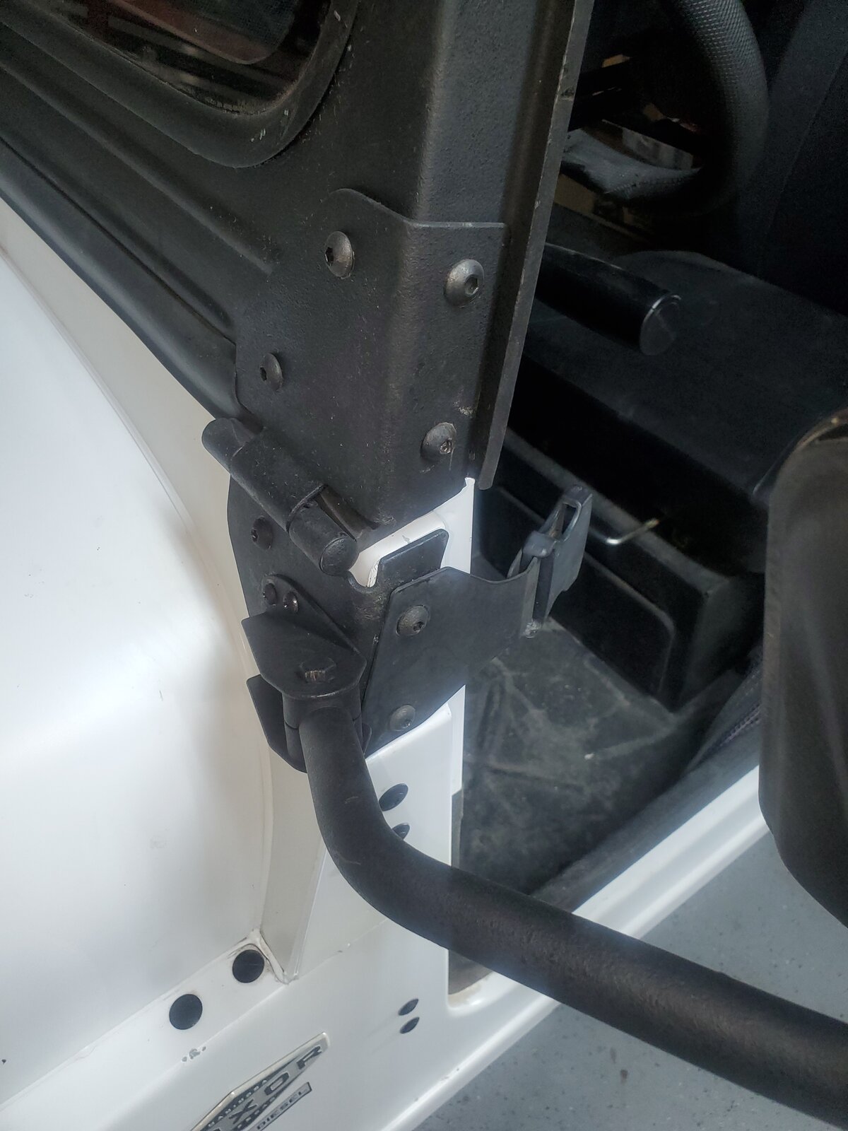

I swapped out Rox windshield and installed CJ windshield and glass. Hinges line up almost perfectly, only cost me $140. Run piece of angle iron at Rops to complete the connection to windshield. Has all the holes for wipers
echo3delta
Apr 14, 2020
34
Great Bend, KS, USA
What year of CJ did you go with?
813
1995

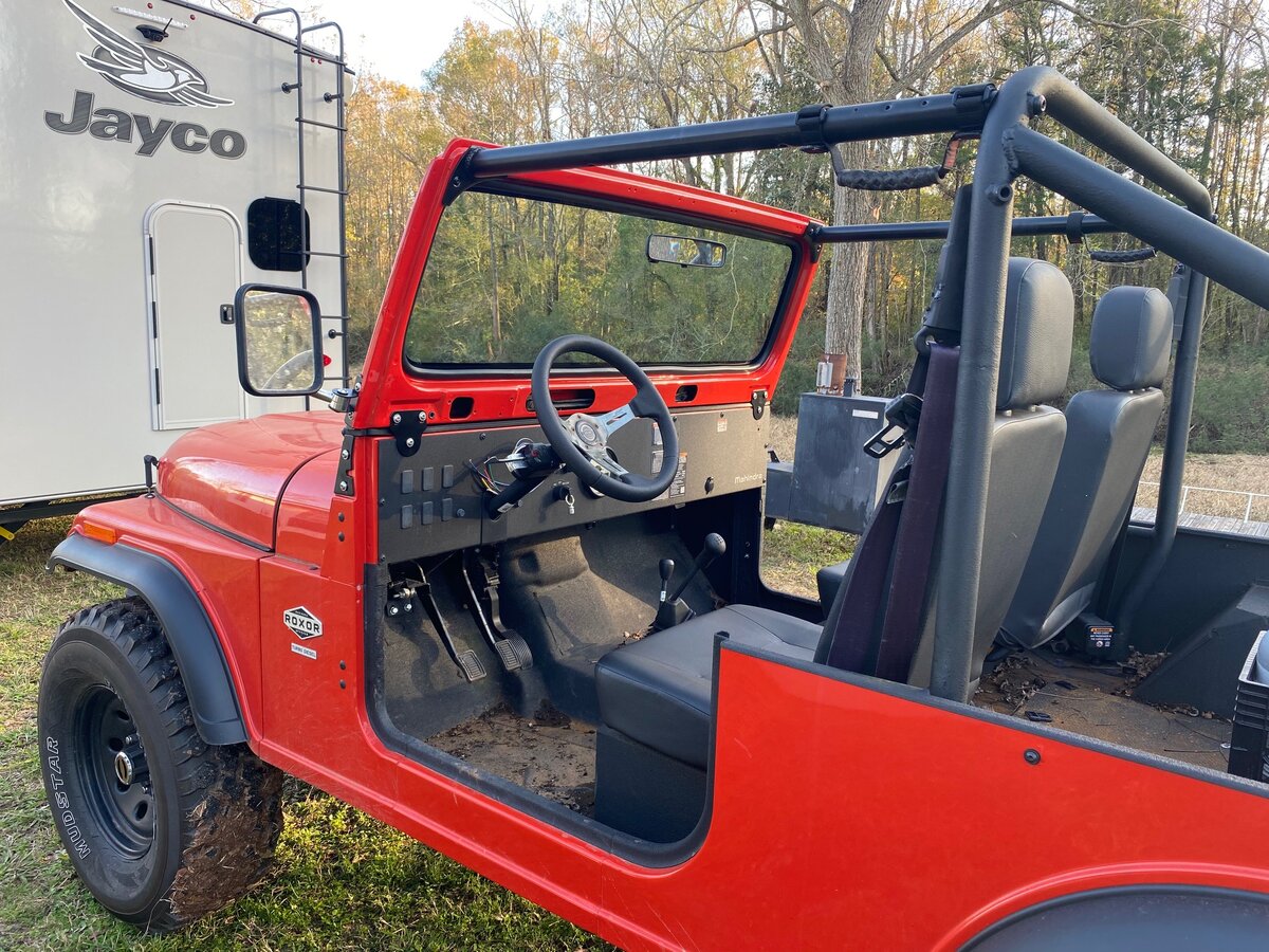

Just a bit of advice on this mod-
If you go with the 1987-1995 YJ windshield frame, you will need to source the wiper linkages from a donor frame, like I did, or find a used set somewhere. They are different from CJ or TJ linkages. As best I can tell, the wiper linkages for YJ frames are not available in new OEM or aftermarket. However, the linkages for the 1986 and newer CJ7 frames can be purchased new aftermarket.
There is really only one reason, that I can think of, to go the YJ route; it has bolting points to extend the ROPS from the center hoop to the windshield frame. This is what I wanted so I ended up finding a donor YJ frame at the junkyard to use when fitting everything up and to get the wiper parts. I bought a new frame and had it painted Roxor Traffic Red and new glass installed. Im very happy with the end result!

I used YJ extension tubes. I have a post on here with details of what I did. Search for "Wroxler".

Not sure I follow you. It is the OEM center hoop, I just cut off the brackets at the corners and cut a little less than 4" out of the vertical sides to drop it down.

How did to straighten out the two bent pieces that go from center loop to windshield

They are YJ extension tubes. If you check out the posts in the link I attached above, I think it will make sense.
