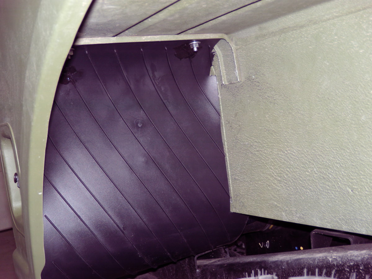

I was surprised how noisy the wheel-wells were with rocks and debris clanking in the fender wells. I power washed the underneath of fenders and made sure all was super spotless. Then bought a gallon of Flexi seal. Used a 4 inch wiz roller and coated the underside. Taking off the wheels is easier but this can be done without removing them. The next day I coated them again. The more coats the better. Now the clatter is so much quieter. And the inner wheel looks better blackened out. Keep riding, bro's

A pic would be great. Curious to see how long that will hold up? They sure tout it. I made homebrew plastic liners for my rear wells. Mainly to protect the fuel filler hose.

It has held up pretty well for being on for two years. A few spots here and there chunked out probably from limbs. Planning on re washing and another coat. Remember it has over 6000 miles on it too!
