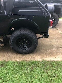

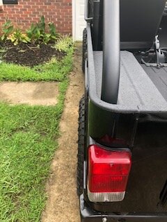

I bought my 106.5 mm from Sixityauto. The only positive difference between the 108 mm is the open slot in the 106.5mm is narrower by a little.

I bought mine direct from sixitys web site. I was in my usual rush and didn't even know there were different size through holes available. They probably also have the 108mm. Lol.
The 106.5 clear everything fine sept the washers under the warren hub screws. I can't see taking the spacers off once on except to do brakes. So in 10 or 15 years? Lol. ILL BE DEAD BY THEN.
As far as the 106.5MM clearing or fitting, they clear any hub or brake drum component shapes 100%. Zero fit issues.
