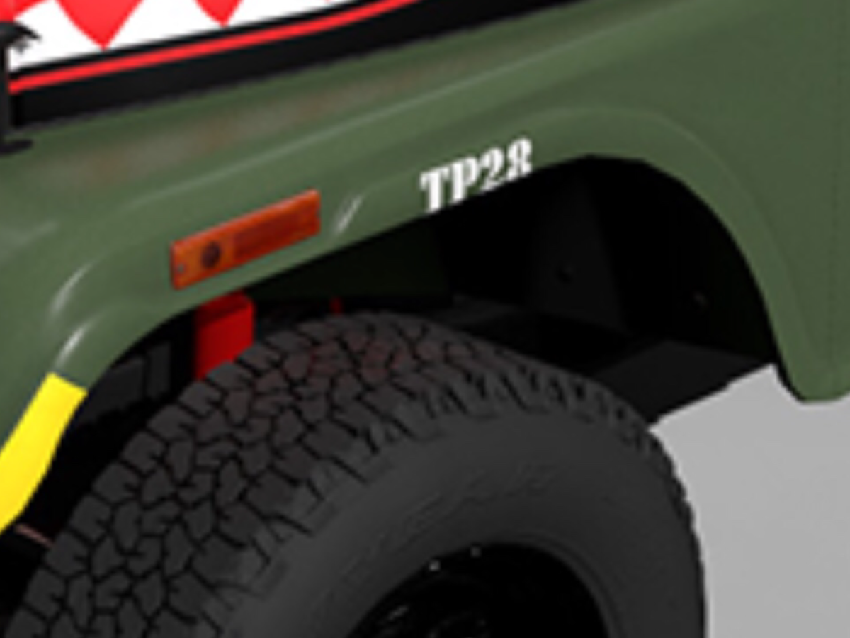

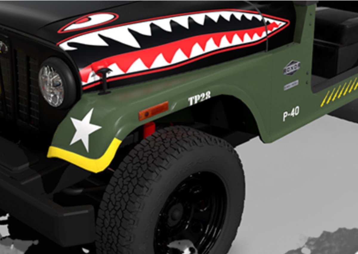

the P-40 graphics confirm the suggested tire pressure, just noticed it today. TP-28
