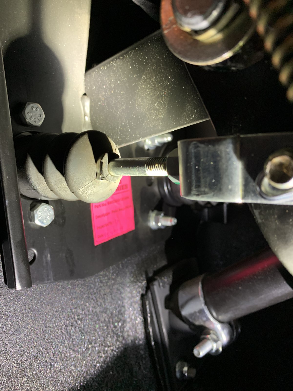

Thanks a ton to kyle at Roxor support he went way above and beyond on this one!! That being said if you all have a squeaky throwout bearing in the back side of the clutch petal there is a turn buckle adjustment if you lengthen that rod it holds alittle pressure on the bearing and keeps it in place like it should be. The Speedo is now fixed too the dealershit when they pulled the tranny to do the throwout bearing they unthreaded the speedometer sensor instead of just in plugging it when they put it back in they did not get the spline lined up so it did not turn

That makes sense, since the slave cylinder doesn’t have an adjustment

Can you take a pic and post directions on how you made the adjustment. I know a couple people that are having the same issue. Thanks realy good to hear.

shawnr, thanks for the update. Pics would be nice if it is possible to photograph.

Super old threat but is it this adjustment?
