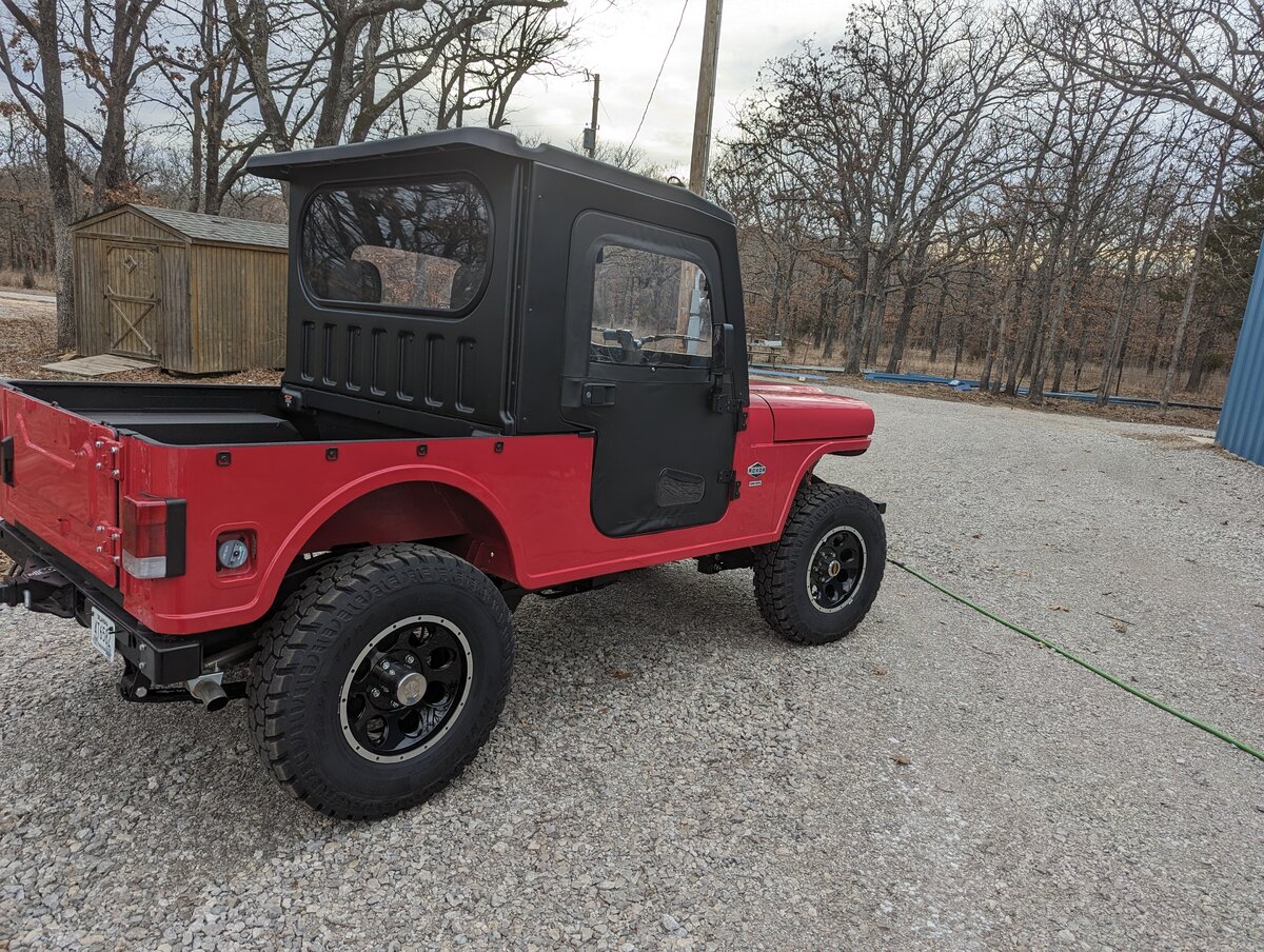

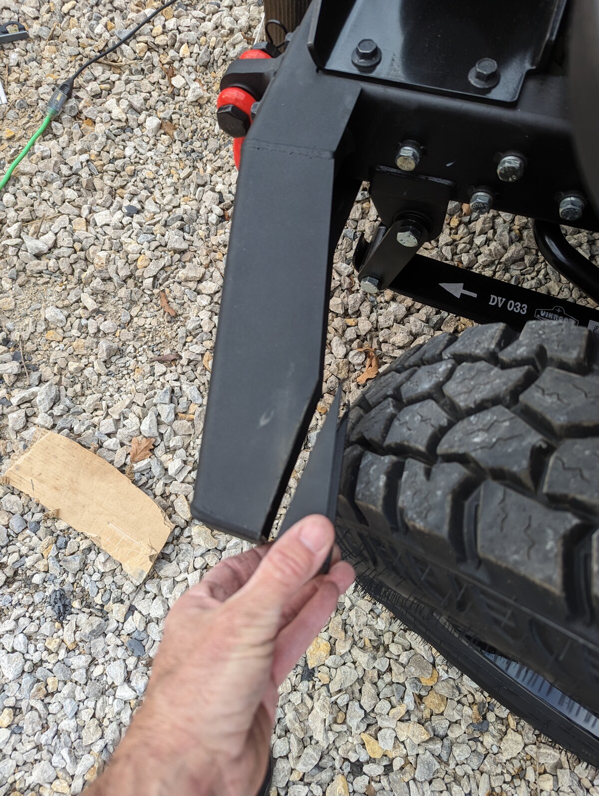

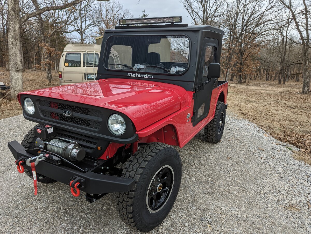

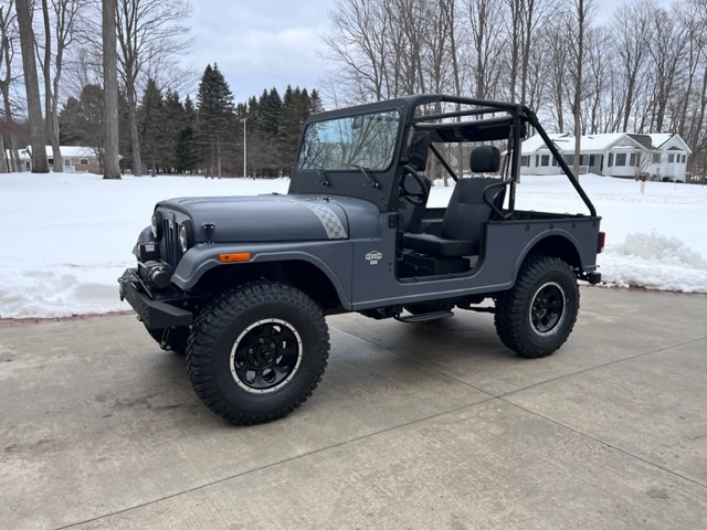

I went with the 235/85-16, 2" front level and l.5" spacers. I did have to trim the bumper just to be safe. These 2022 all weather bumpers wrap around a bit. It actually rides better with the lift and tires. Surprisingly the speedo doesn't seem to be off compared to gps. Not sure why that is. Stage 1 tune is next.

You checking speedo at road speed or low speeds? Cause it’ll be off a percentage and you won’t see a big difference til, you get to higher speeds.

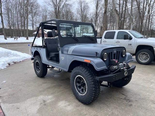

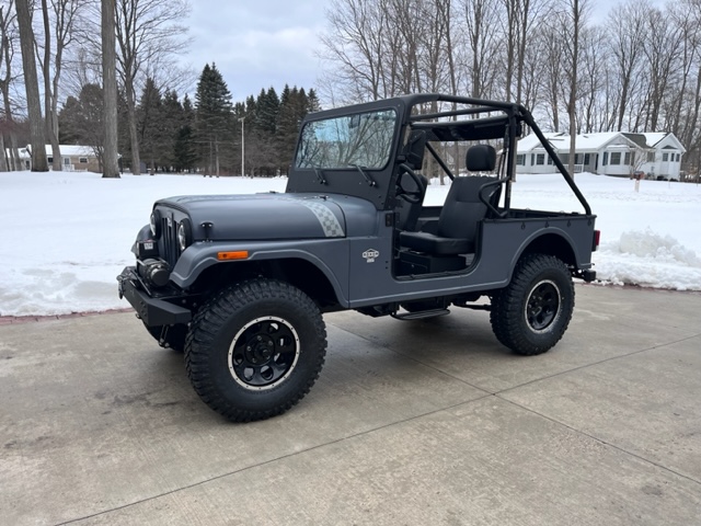

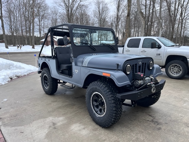

I think yours are basically 33”. Mine are 255/85/16 Wild Peaks, yours are just a bit skinnier at 235. I didn’t trim anything, just used the 1.5” wheel spacers.

Need to install fender flares and the lockout hubs, and then, done……for now.

I was concerned that much bigger would cause fitment issues with just a front level. Maybe next time I need tires I can lift the rear and try the 33" tires if you don't find any issues.

What 33” tires do you have mounted? I’m lost on what size 33” will fit on stock rims.
He has 255/85-16. There are online tire charts to help you with options. I'm running 235/85-16 which is a 31.7". I will try 285/75 32.8" when these wear out.
