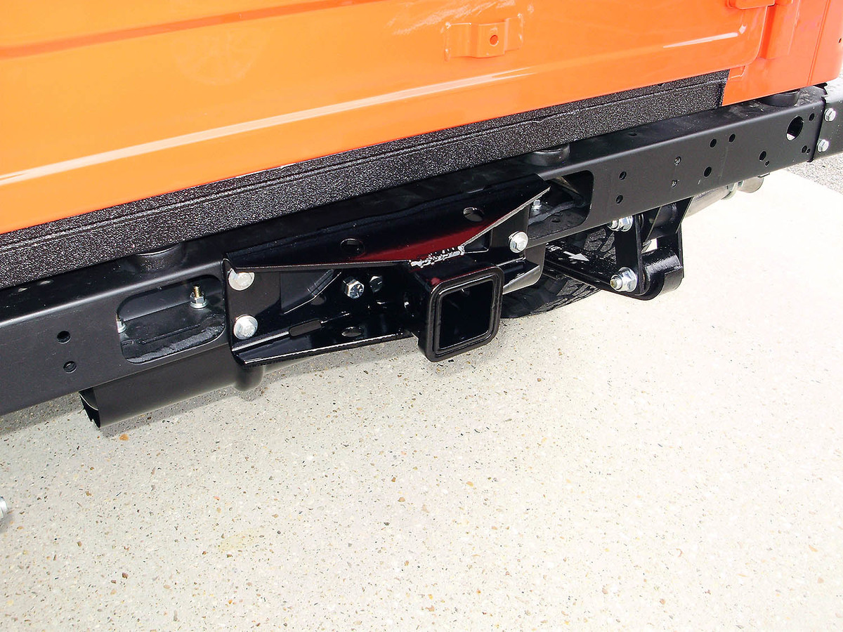

Not sure about the powder or paint but I have one and it’s definitely beefy
Jake16
Oct 5, 2018
2
Cambridge, Ontario, Canada
It looks good. will any draw bar with ball fit on it? The reason i ask is it looks really shallow like the bar wouldn't go deep enough into it to pin it.
Shortbus
152
Phoenix, AZ, USA
1247
That’s what I thought too so I bought the one they make for it. Come to find out I have another one at the house from Curt that fits just fine.
BradsRoxor
Aug 2, 2018
47
Springfield, MO, USA
1426
I have one. I believe it is power coated. My drawbar fits fine.
My original reaction was it was too shallow, but it is not.
You may need a deeper drop on the drawbar, it sits higher on the Roxor than my Superduty and JD tractor.
If I remember right is it around 2” or so higher.

This receiver broke the roxor bumper it is mounted to. it is beefy but does not distribute the weight well enough to not damage what it is mounted to. roxor would not warranty the damage. Strongmade.......?

By just looking at the picture, it seems it only twists for turning. Going over a hill or dip would try to pry on the bumper. It needs flexibility in both directions like a universal joint.

Using a ball takes care of that. Keep it as close to the reciever as possible to lessen leverage on bumper.

i got one too -- bent what its mounted to --- i was pulling a boat ---- now i have an anchor for that boat---

I am sure some after market outfit will come up with a decent bumper with some strength in it.

Cecco racing has a rear bumper/hitch that actually ties into the frame.
