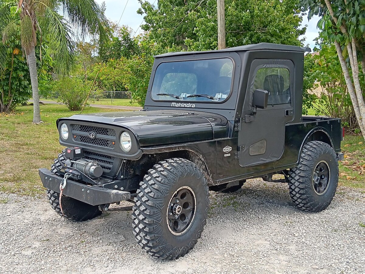

Just Received an OEM Parts Catalog for the 2018 - 2023 Roxor.
