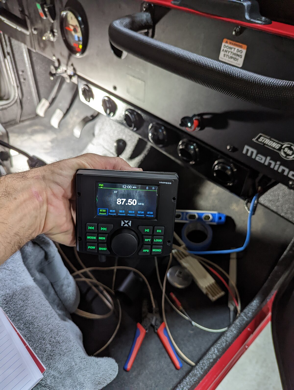

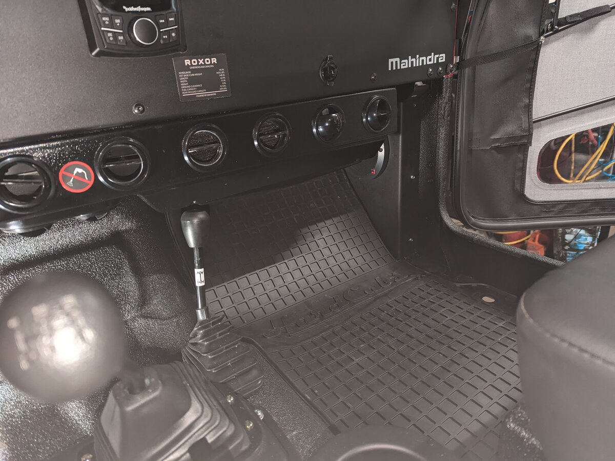

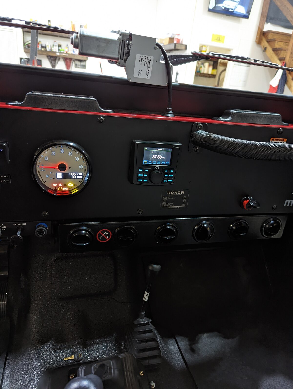

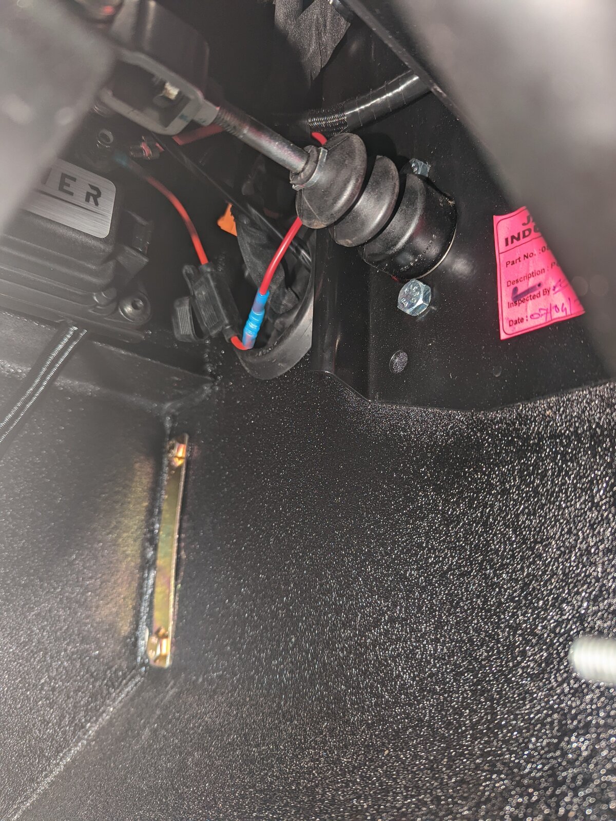

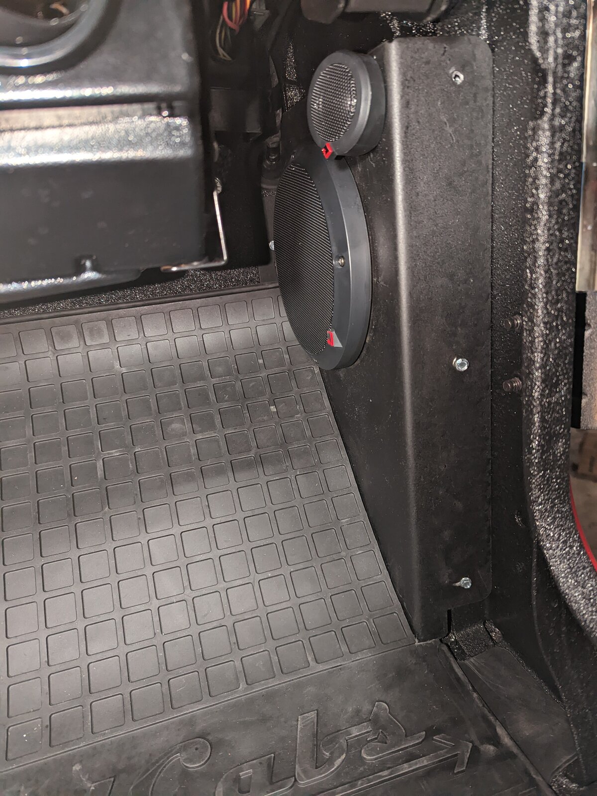

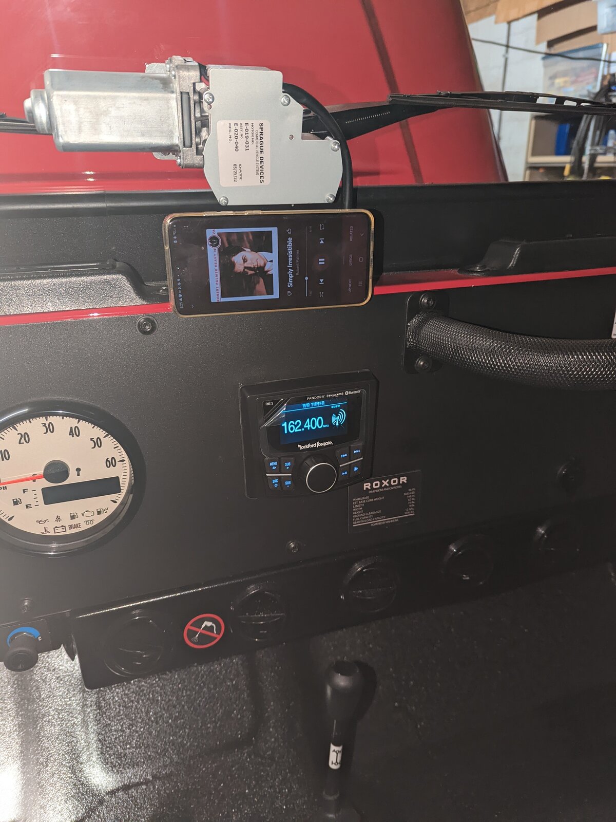

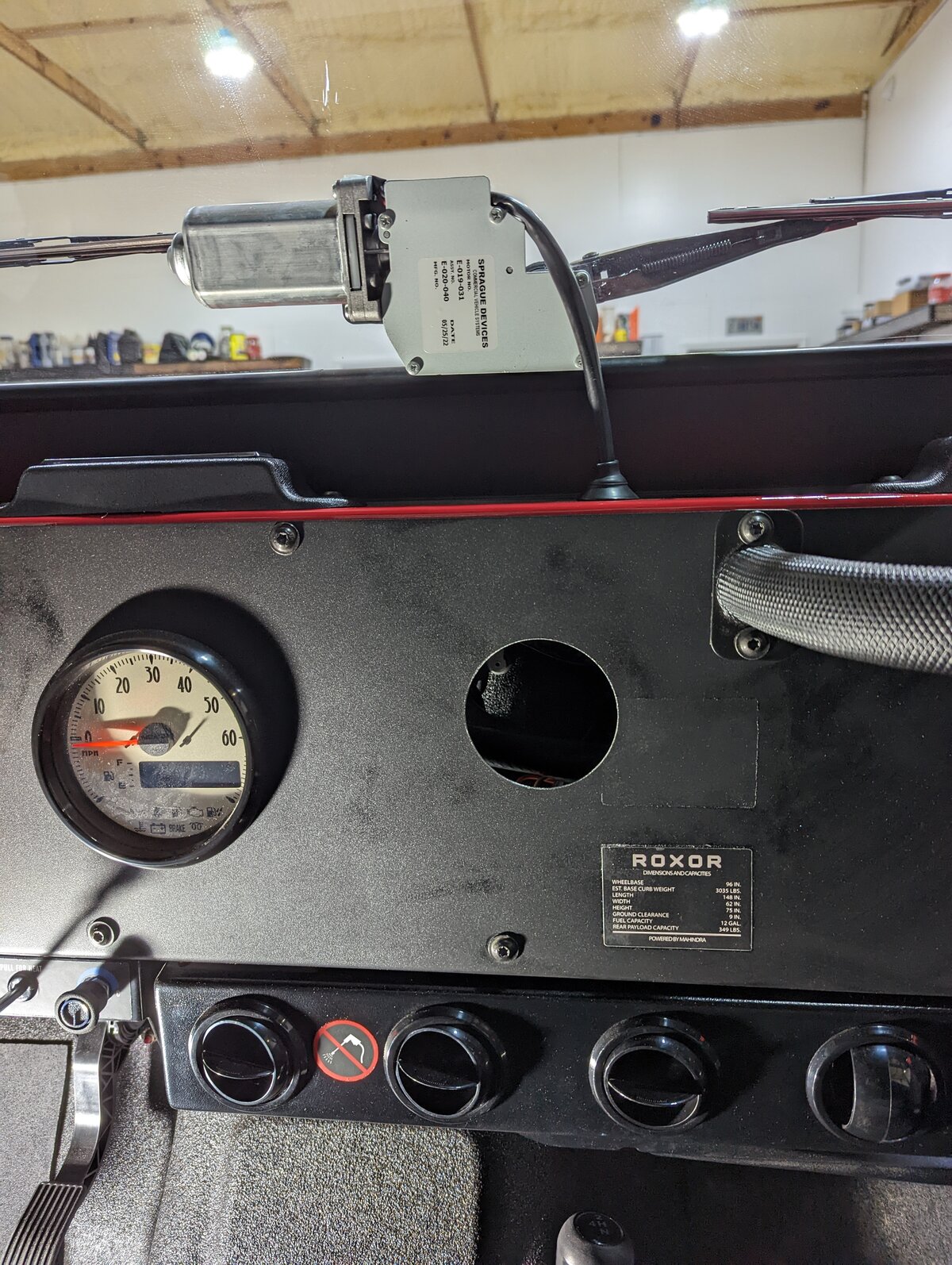

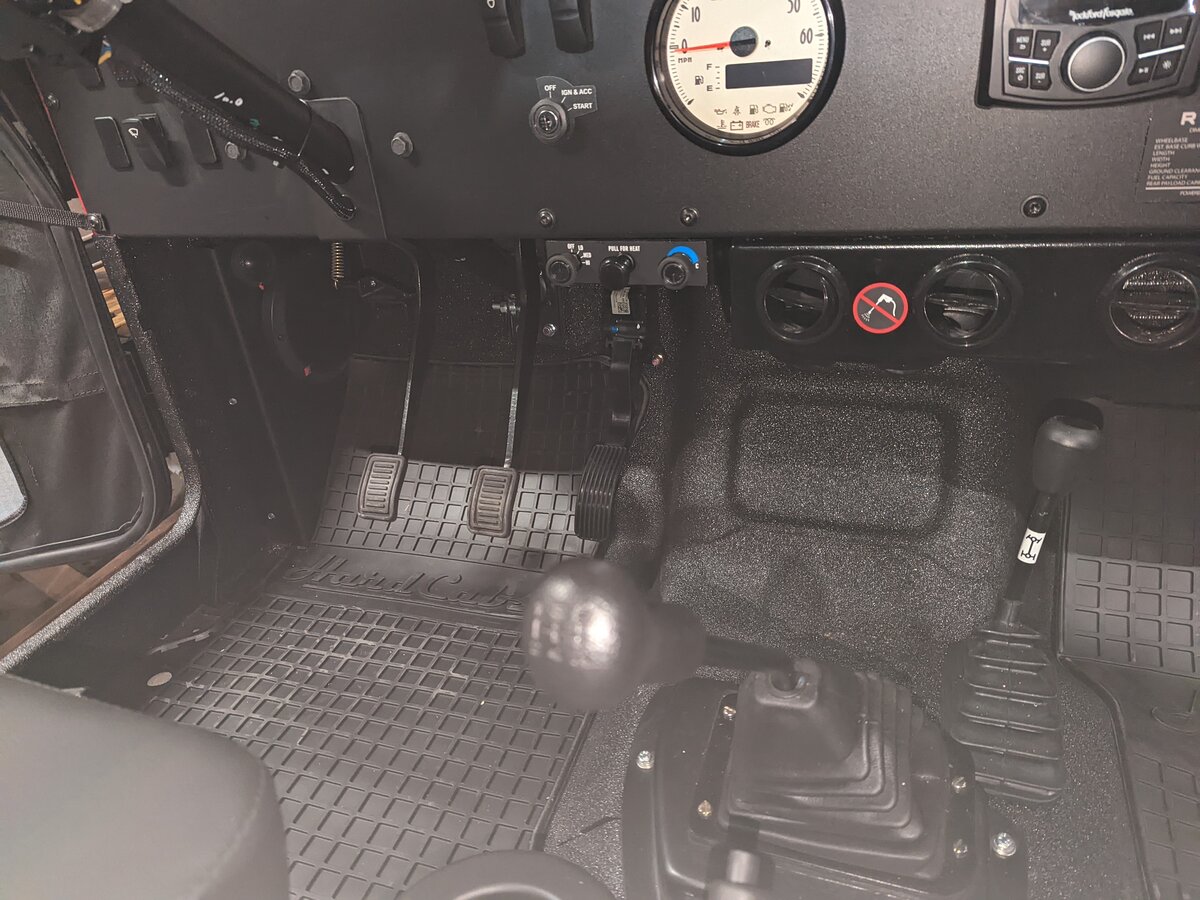

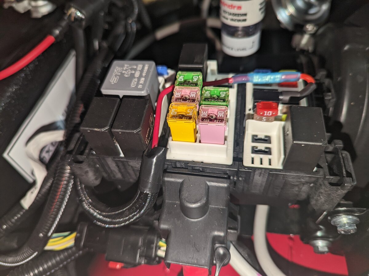

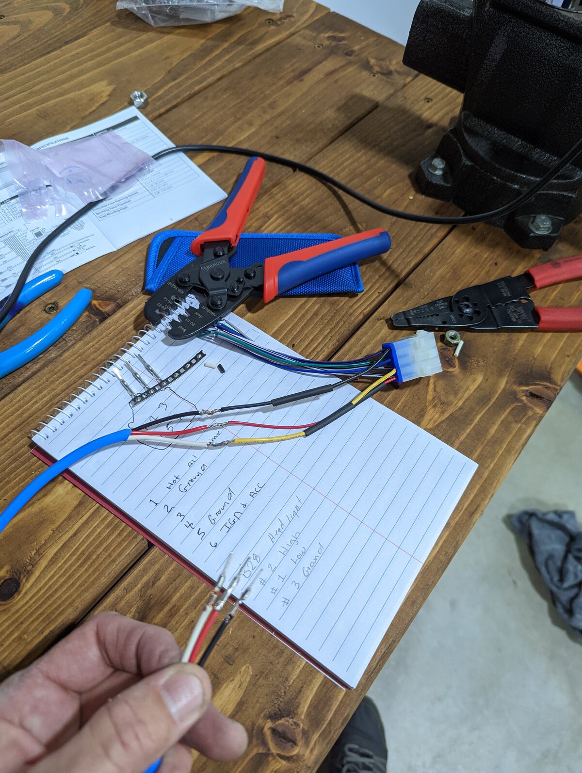

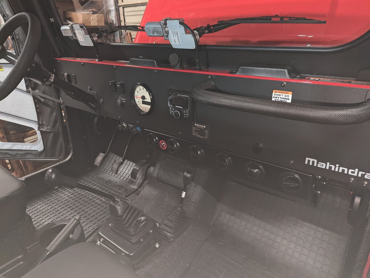

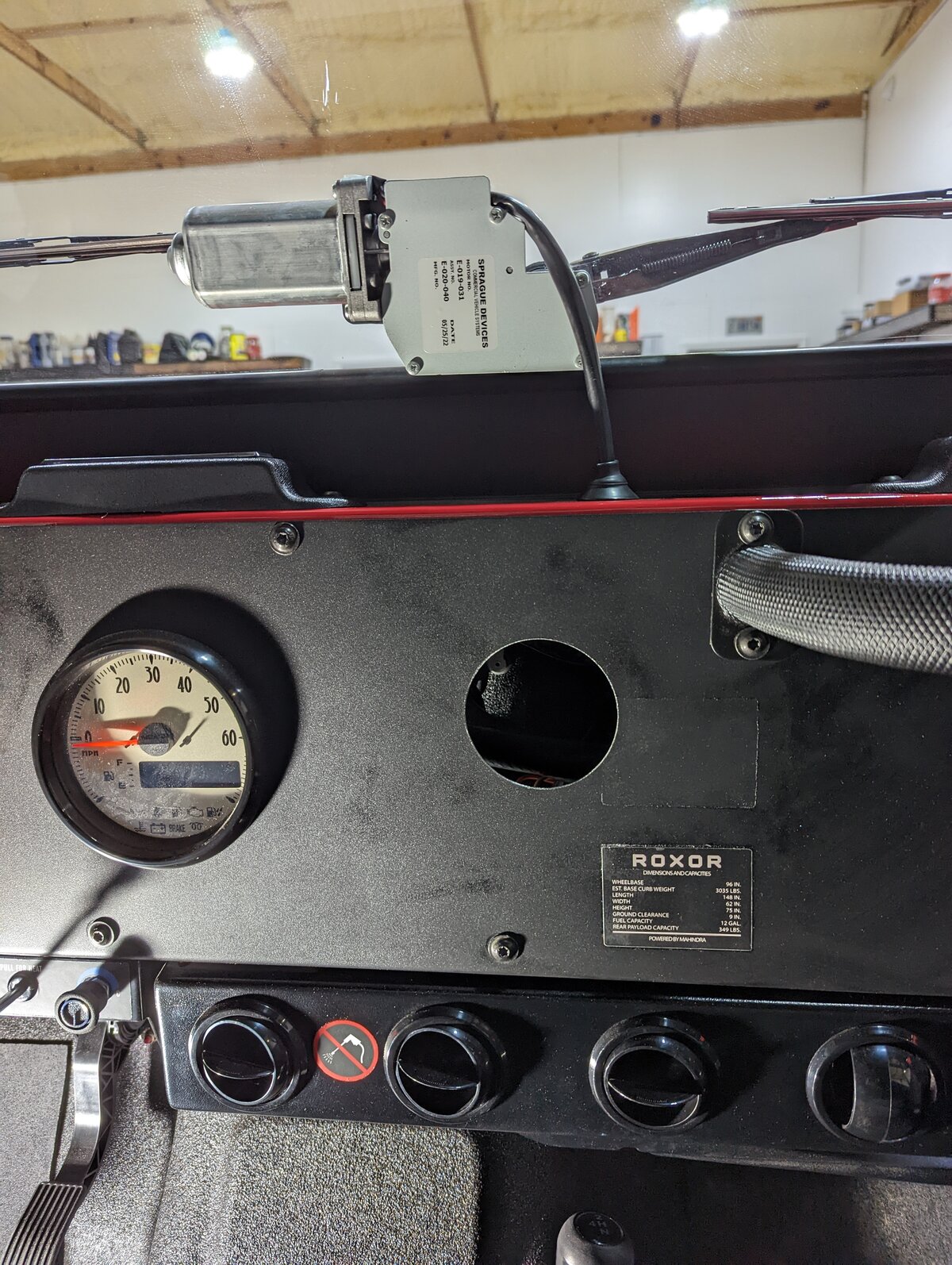

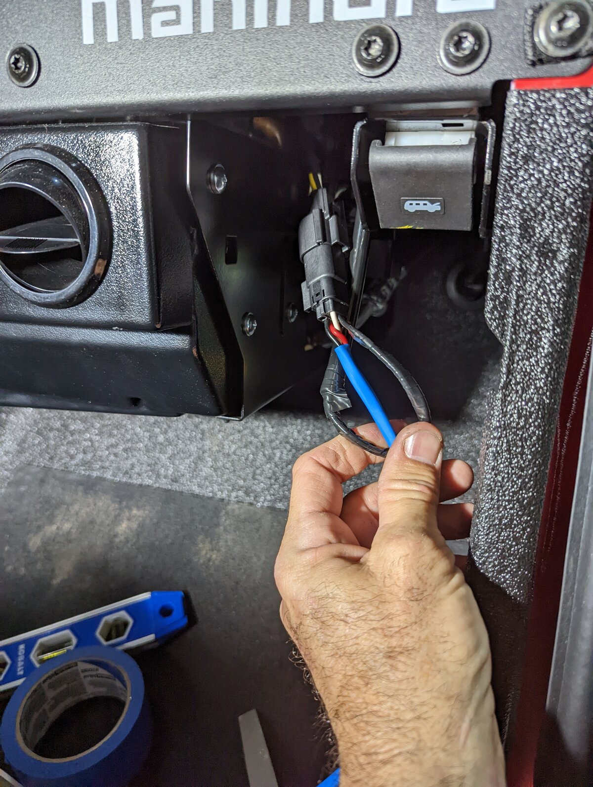

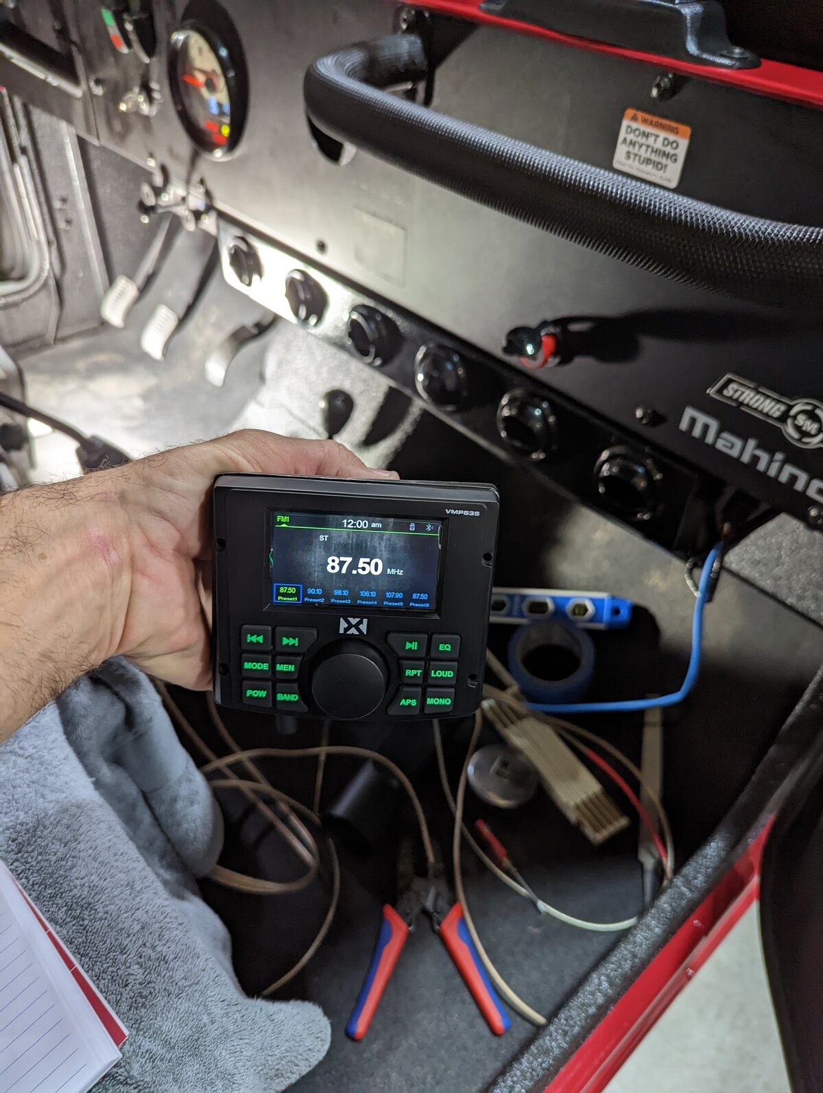

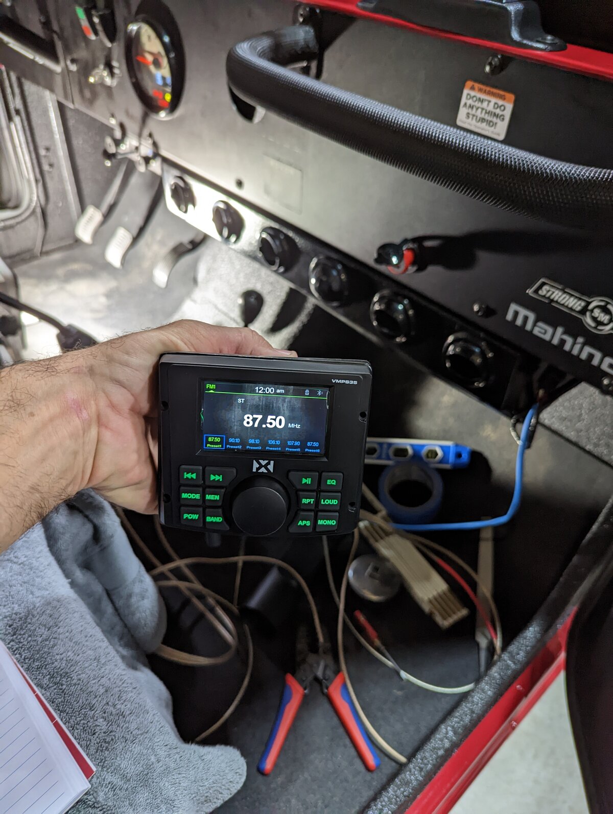

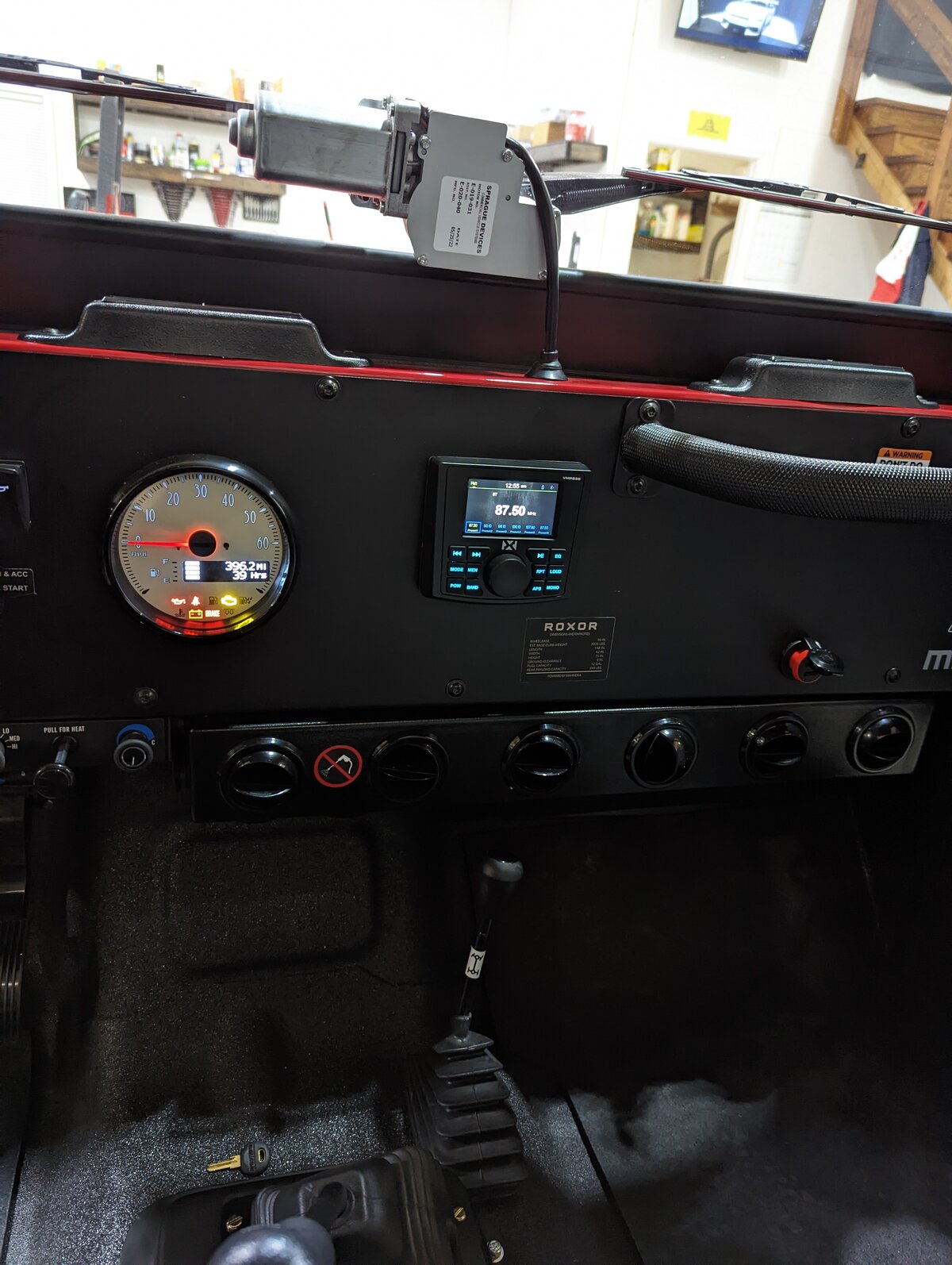

I just installed a guage style radio in roxor all weather
couple of key pionts of install

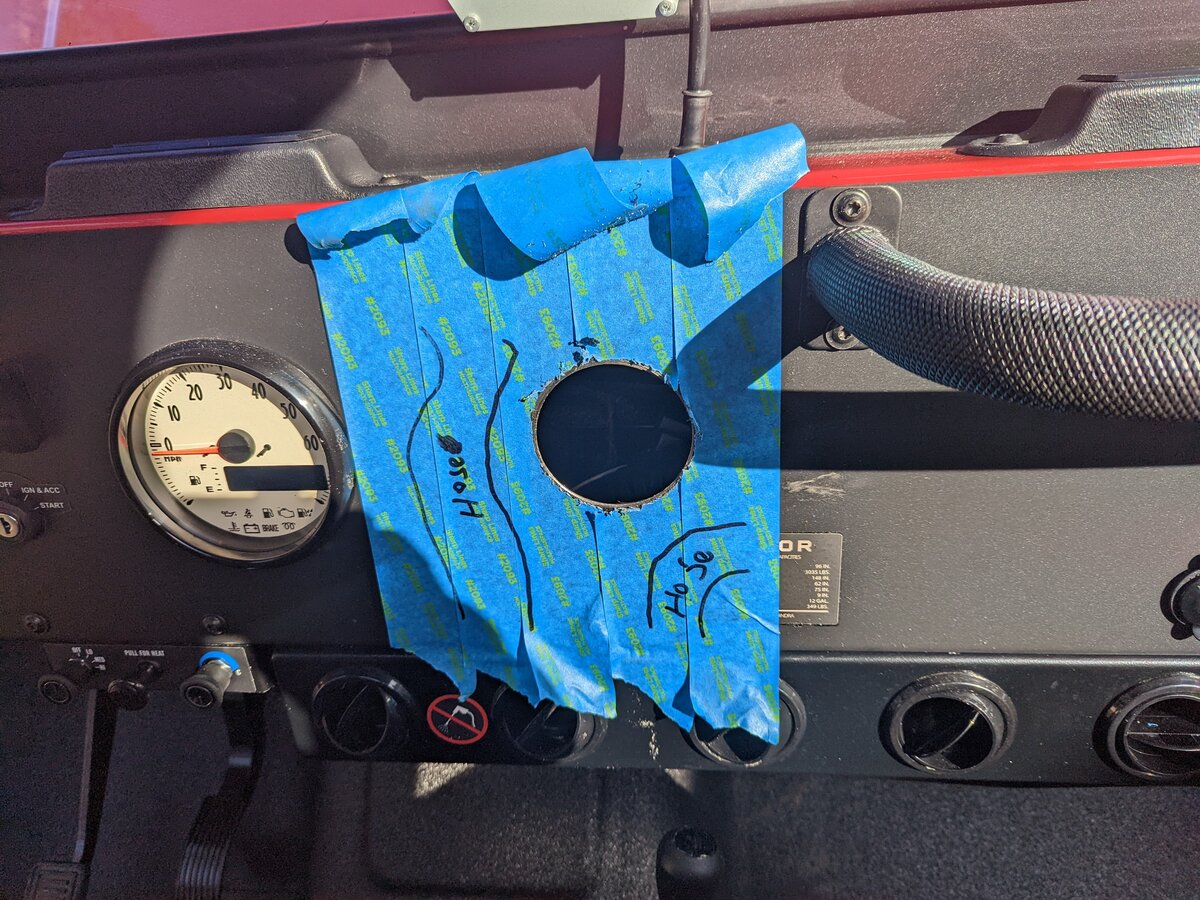

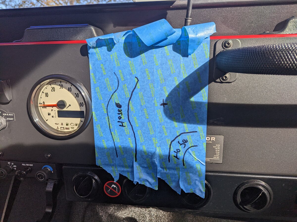

1-was going to do a double din but with the way the def. vents hose goes up behind the dash it was going to be a tight fit ,beside I have a mag mount for phone and tablet i just move from motorcycle,slingshot etc.

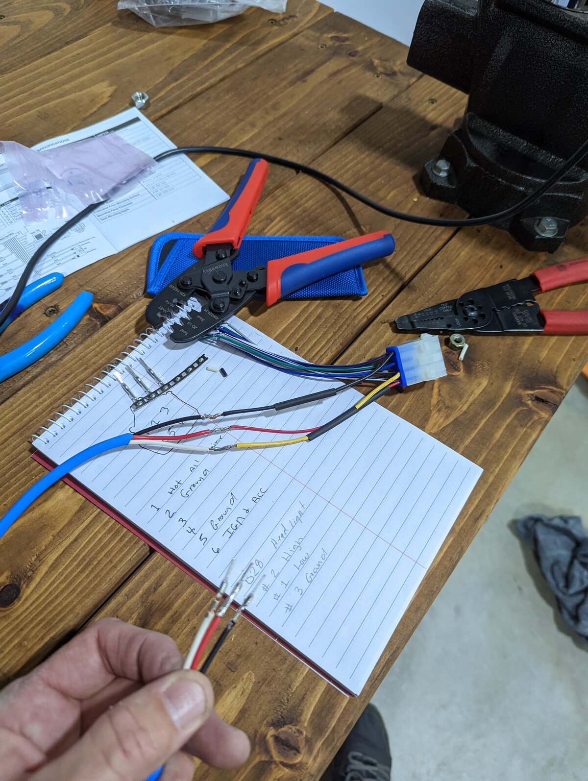

2-used toggle switch to give me power if key off

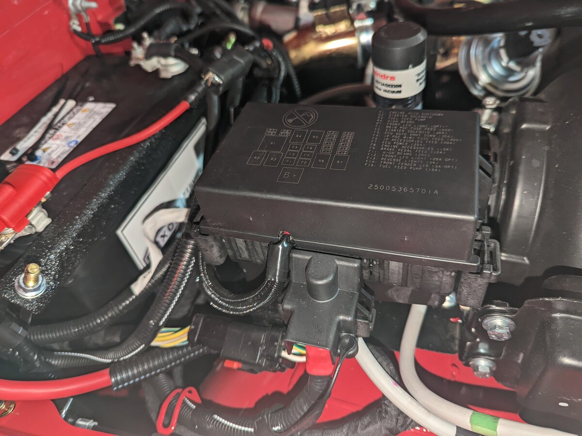

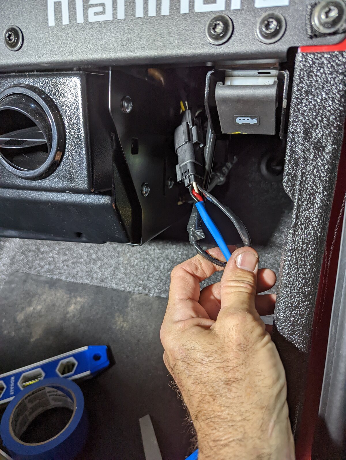

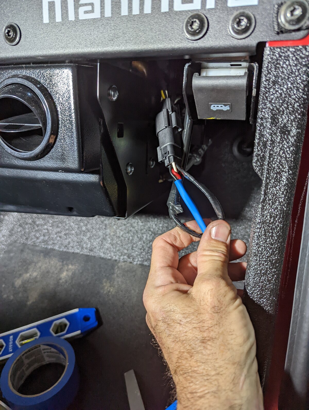

3-1 side of toggle tired into roxbox acc fuse box and fused it for constant power side and other side ran wire in wire loom from ac pressure switch (lol i think)ended near fuse box under hood and used piggy back fuse to get acc (keyed) side of toggle

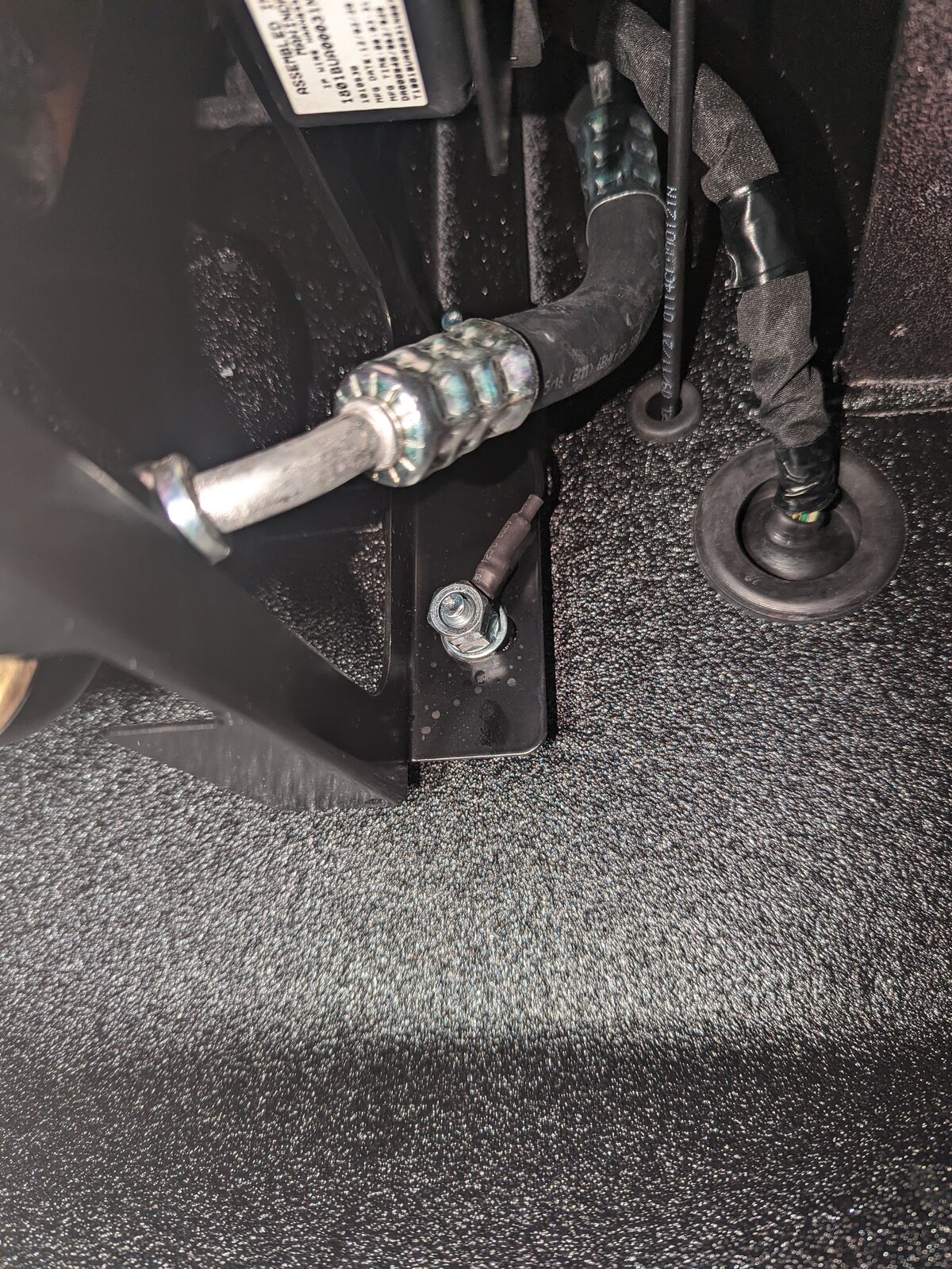

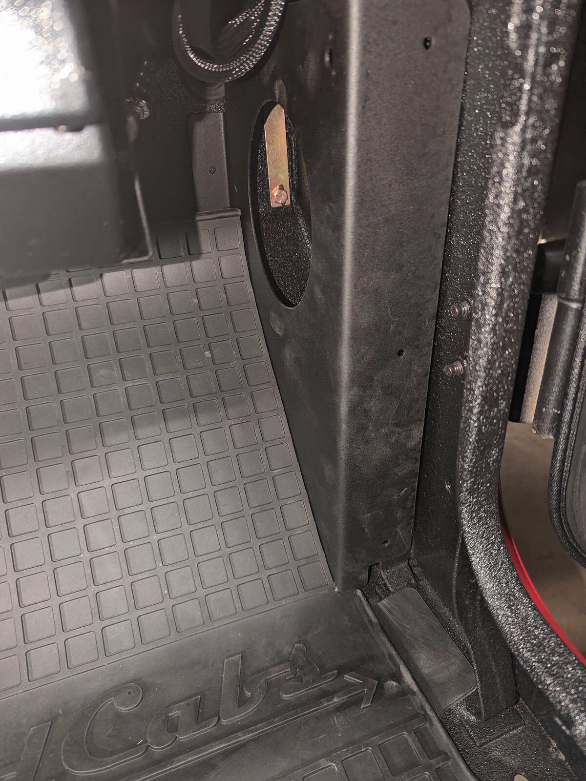

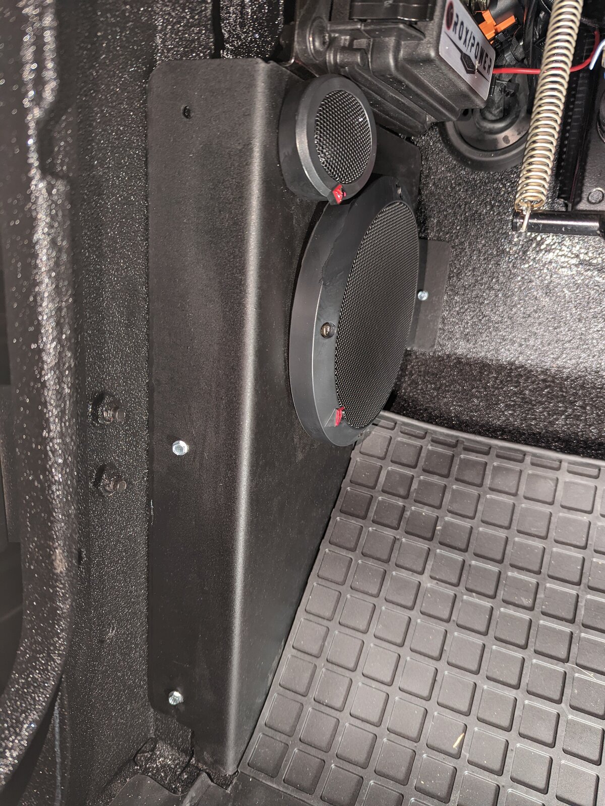

4-kick panel speakers worked out great ,had to trim rubber mats around them , would hane been nice if 1/4 shorter so mat could slide under(I know the same comp does not make mats and kick panels but there sold at same place and with this small of community it would be nice if looked at other companies items to work togather
5- every thing rapped in wire loom
6-it was to cold to paint kick panels to match inter. will do that in spring and hook rear view camera prob at same time

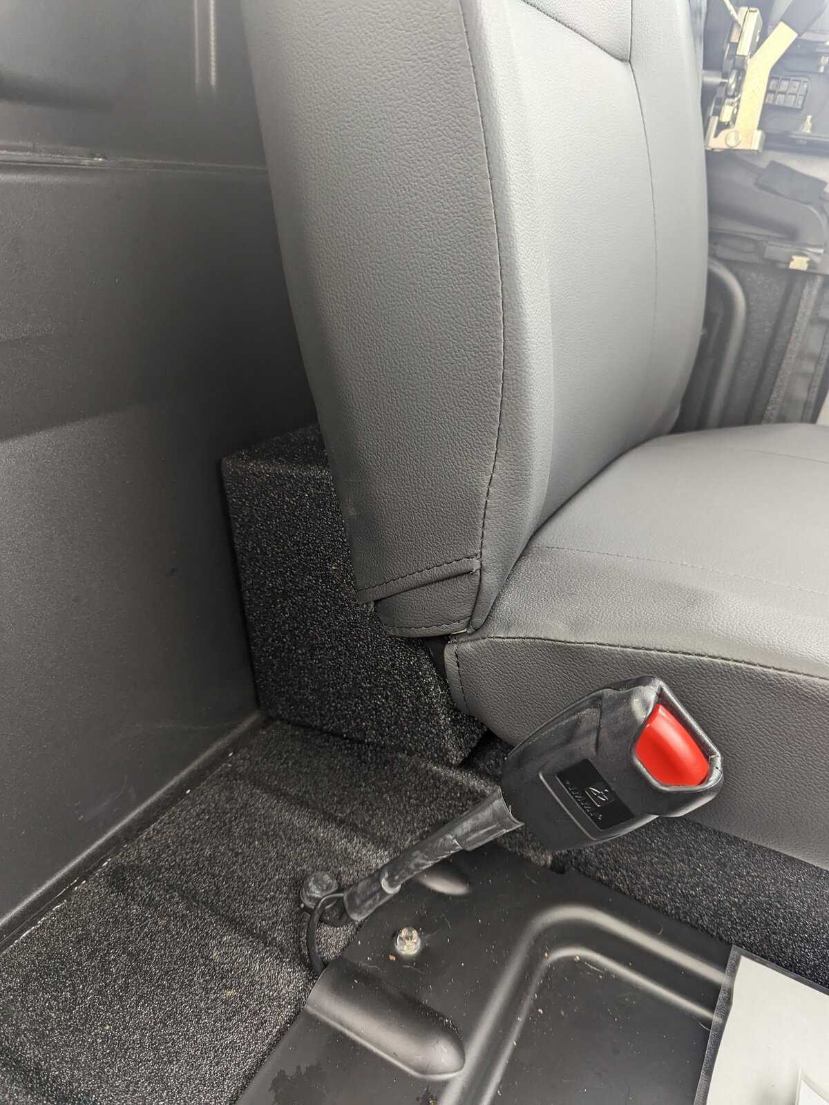

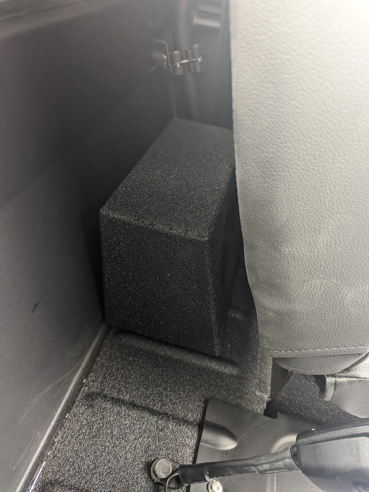

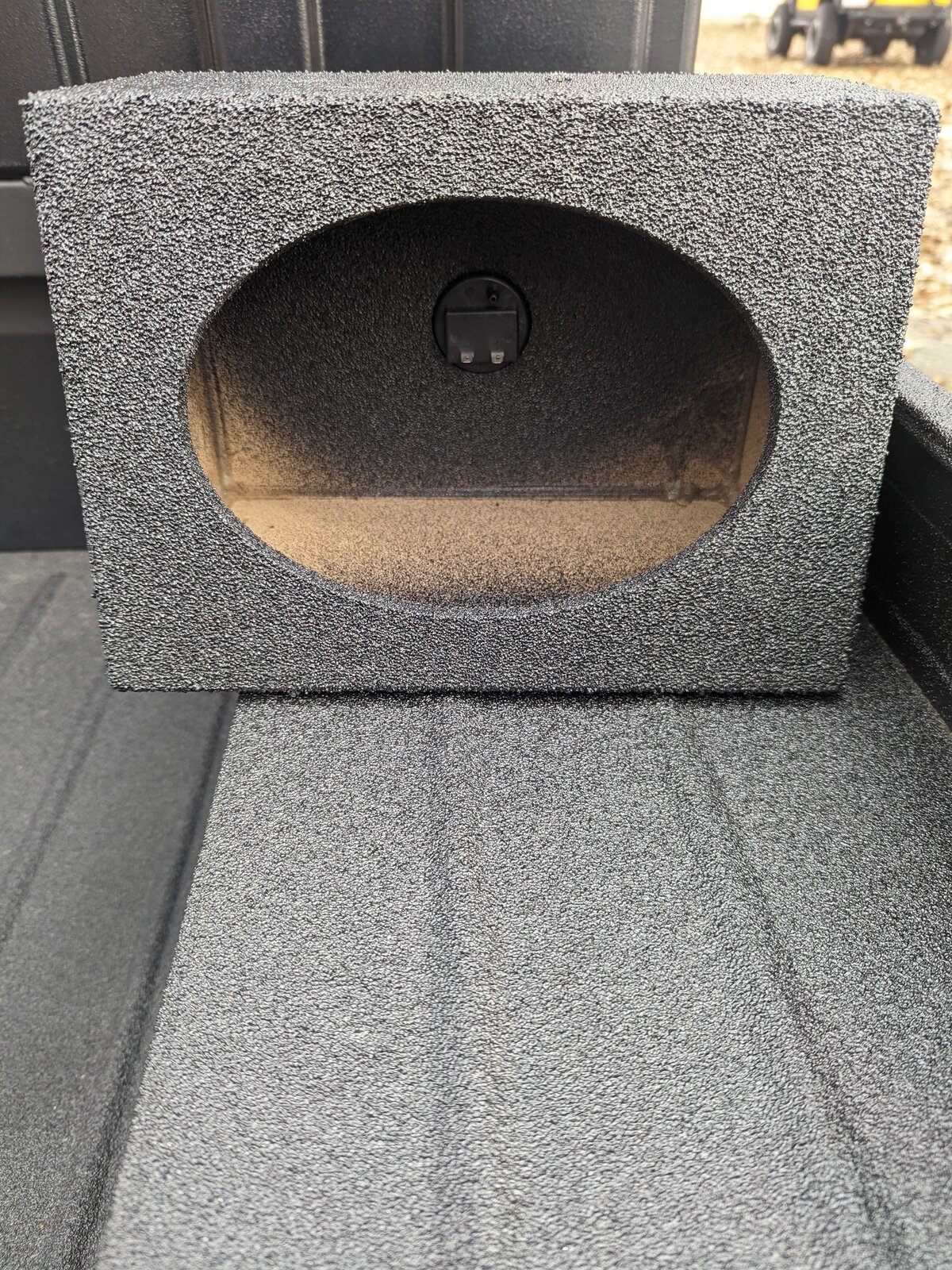

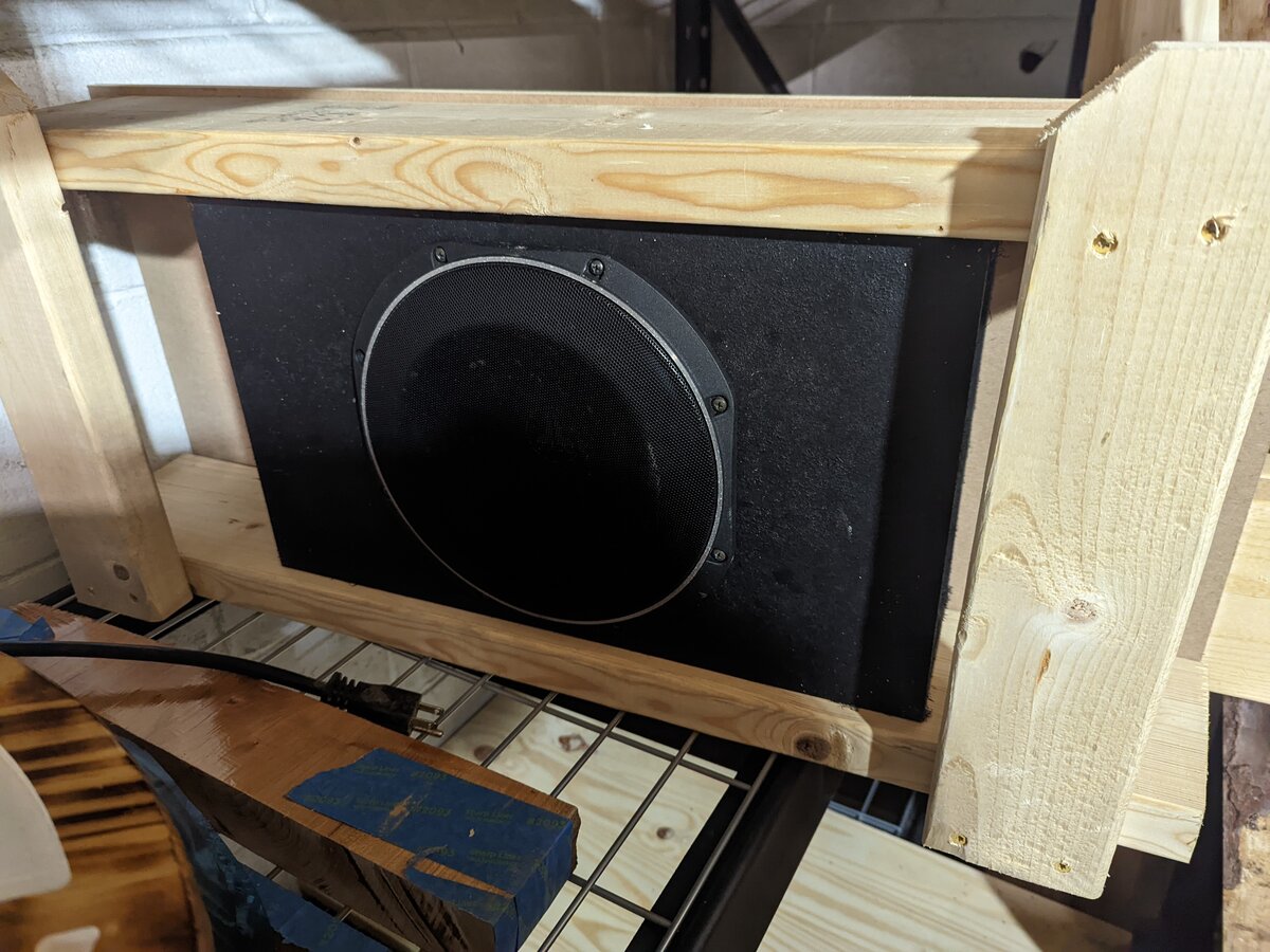

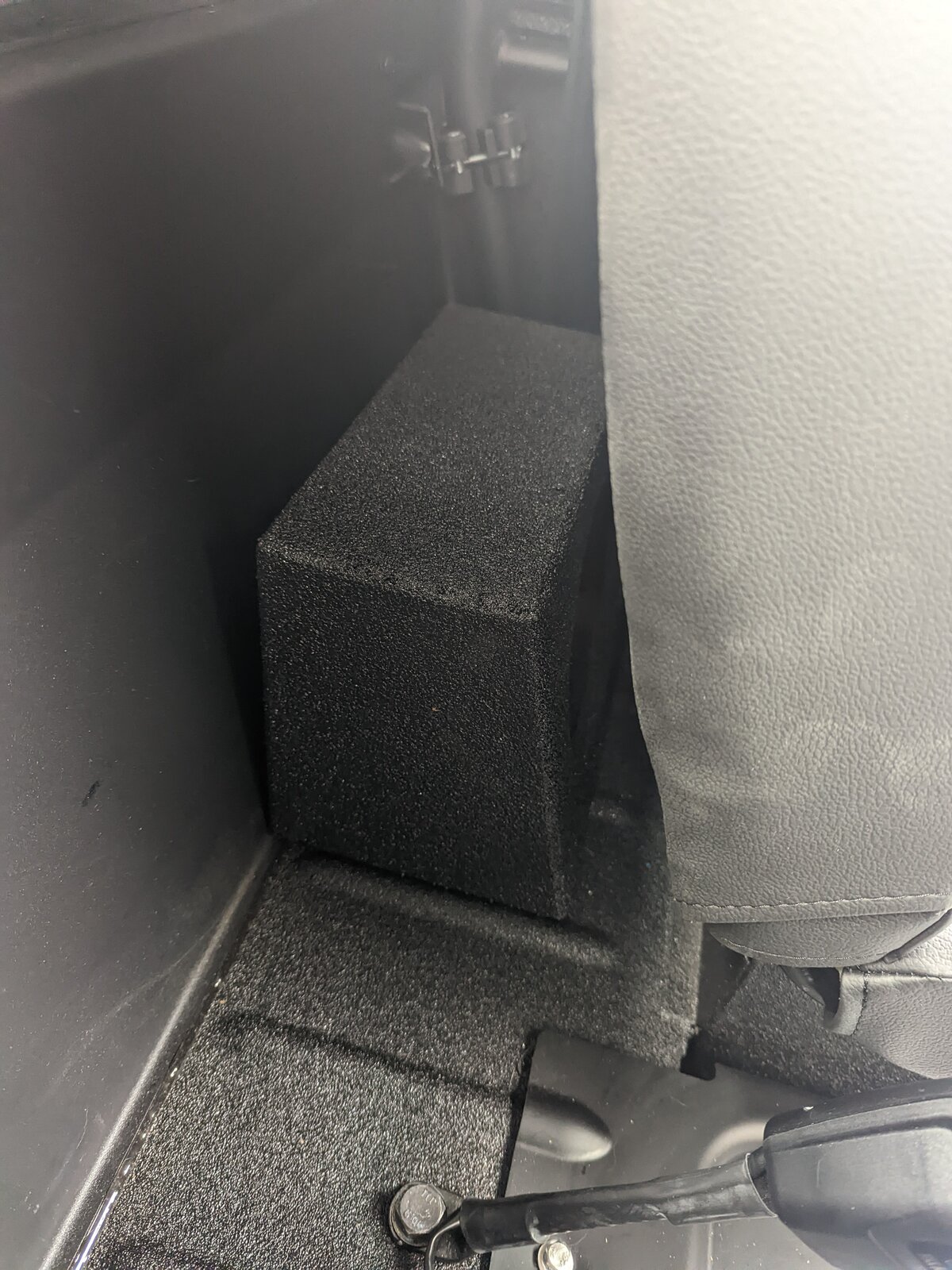

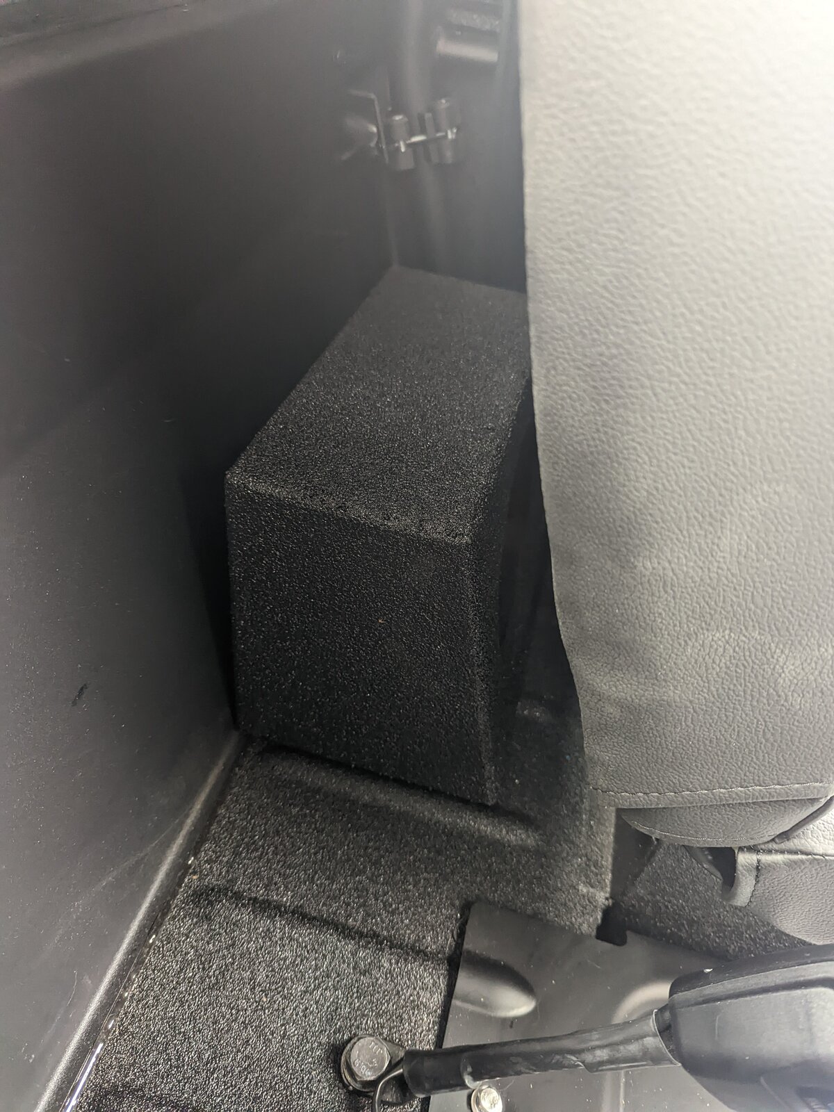

also prob will be install 6x9 beuind seat and jl aidio pre loaded box with built in amps(the jl box with built in amps runs at very low ohms which makes amp draw a hell of alot lower)
and i think that is about it let me know if anyone has qny questions
added quick video
ramrod
Nov 5, 2022
44
north carolina
Here are some pics
PXL_20221121_221024424.jpg PXL_20221121_220938310.jpg PXL_20221121_220929161.jpg PXL_20221114_195005839.jpg PXL_20221121_195853231.jpg PXL_20221114_193057499.jpg PXL_20221121_221043467.jpg PXL_20221118_215817673.jpg PXL_20221118_222547127.jpg PXL_20221118_221636445.jpg PXL_20221118_215900228.jpg PXL_20221121_205323438.jpg PXL_20221118_213501530.jpg

no they are the ones they sell for 95.00 everywhere every nice made and thick,for the price its not worth tring to make your own in this case,i got mine from diesel freaks and mats

It's works great ,hotest day since I got it prob high 80's and could not go above fan 1 speed it was so cold and I have had heat on in temps in high 20's and same thing in heat, once it warmed up just left it in 1 and it's great ,to get defrost to work good just barely turn on ac to get compressor to come on

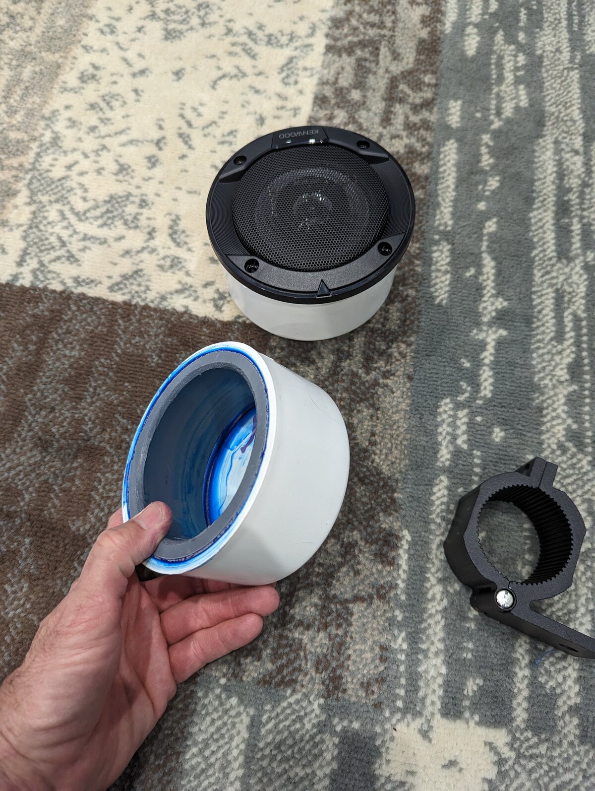

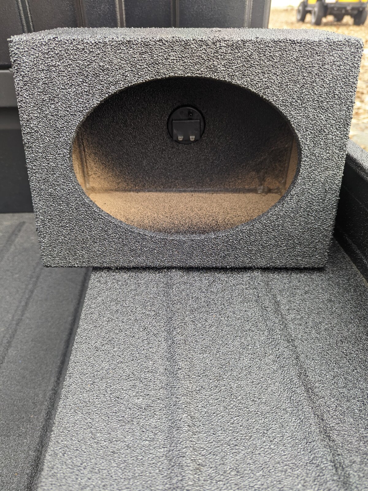

looks good barnboy ,I got in some 6x9 pods already have the bedliner spray on them looks like a good match ,I will post pics when i have a chance

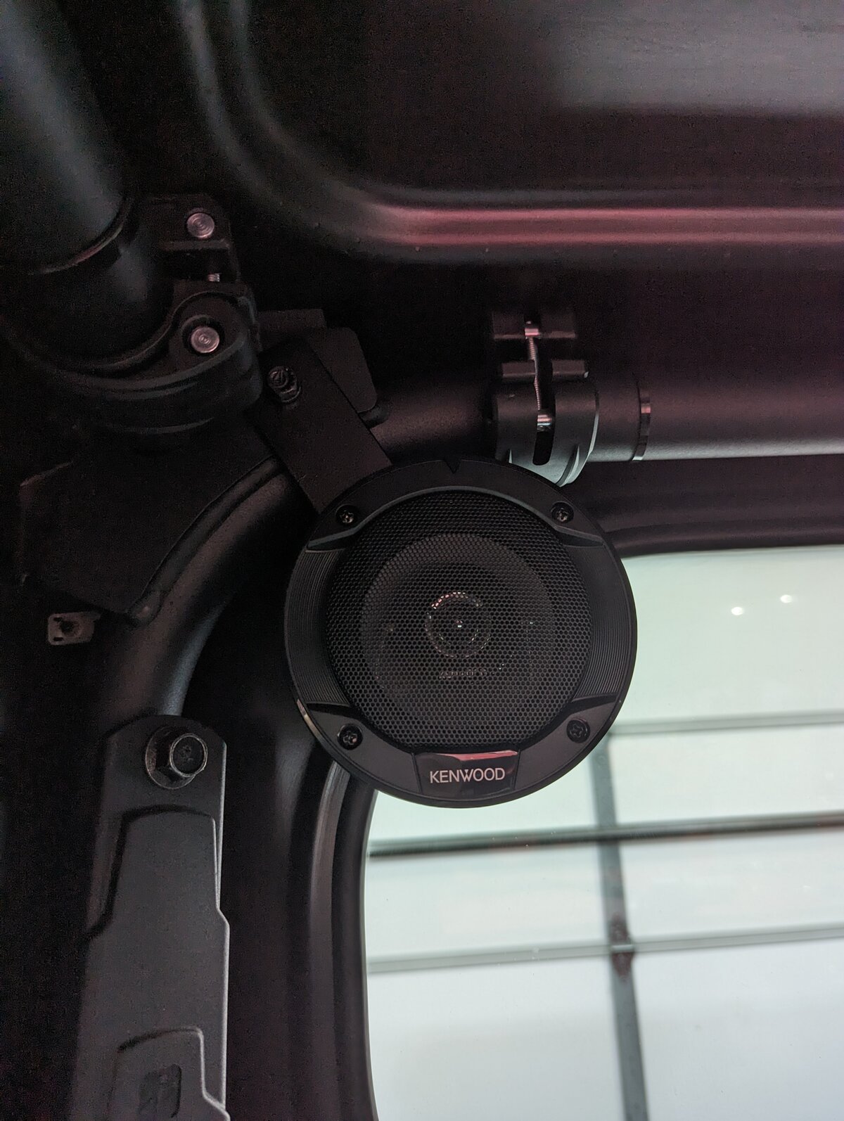

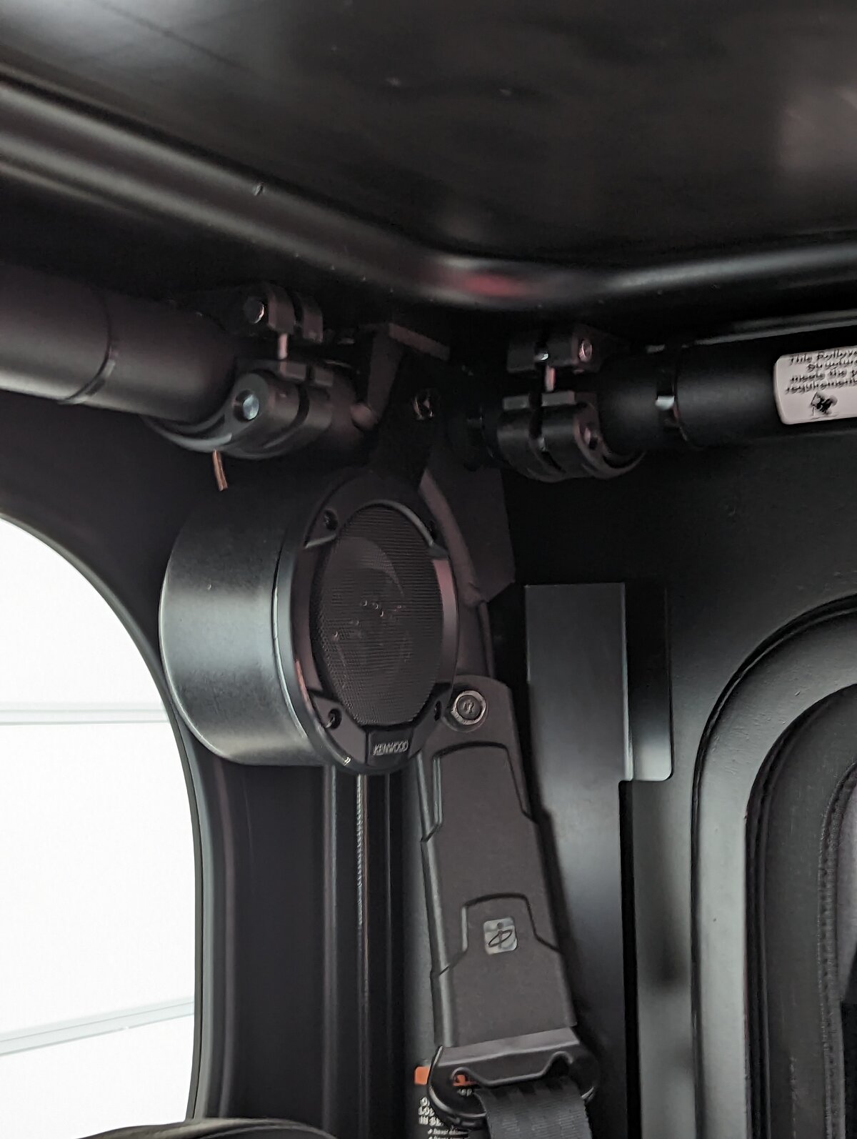

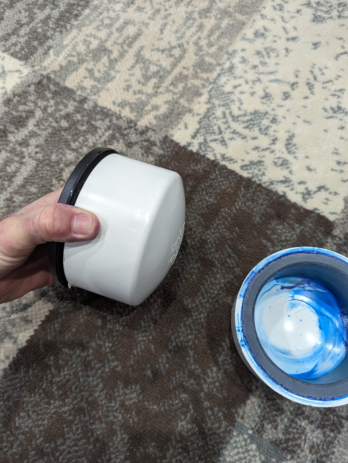

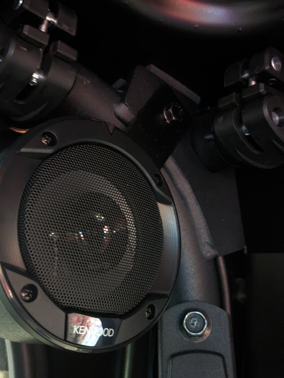

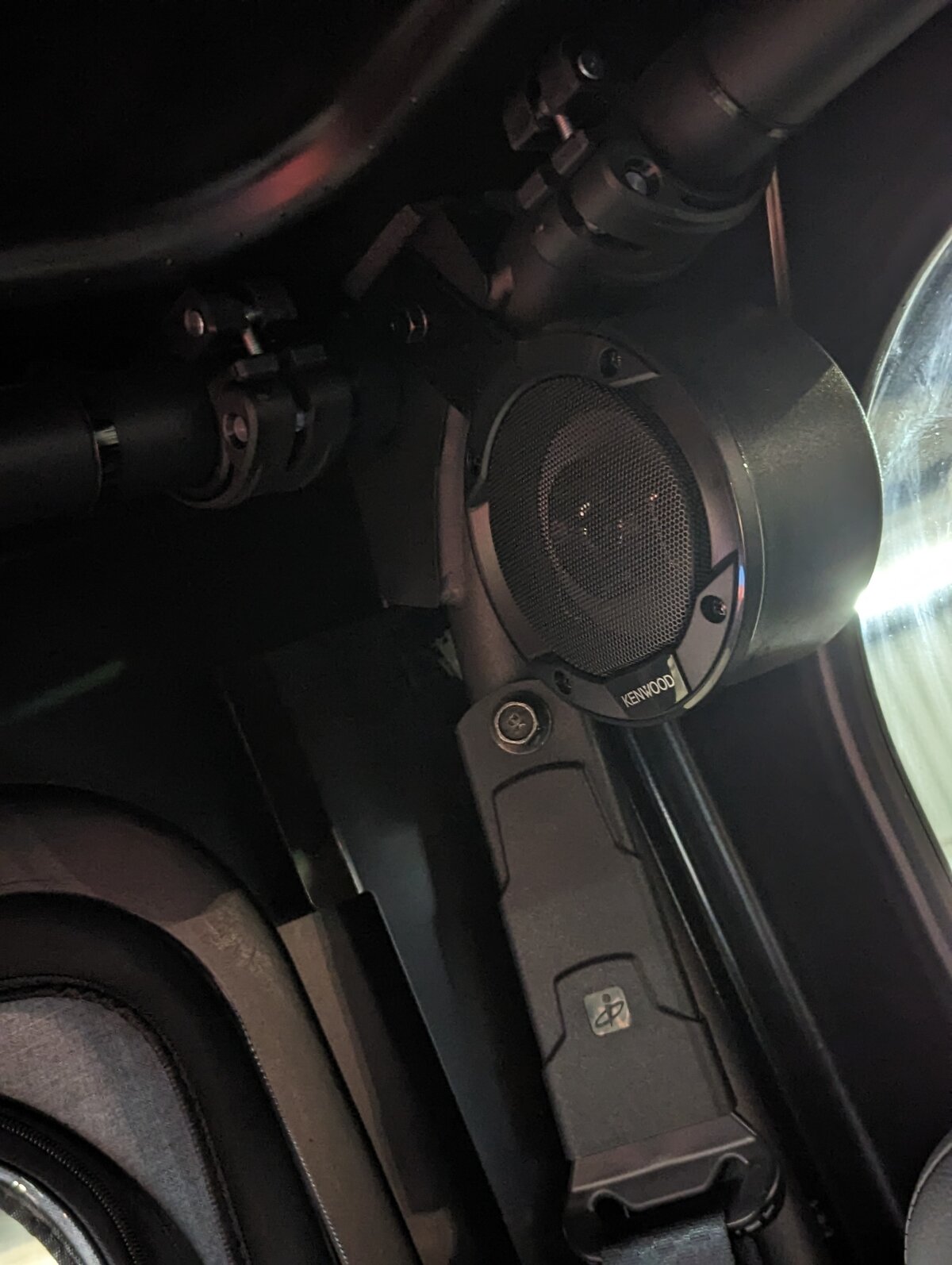

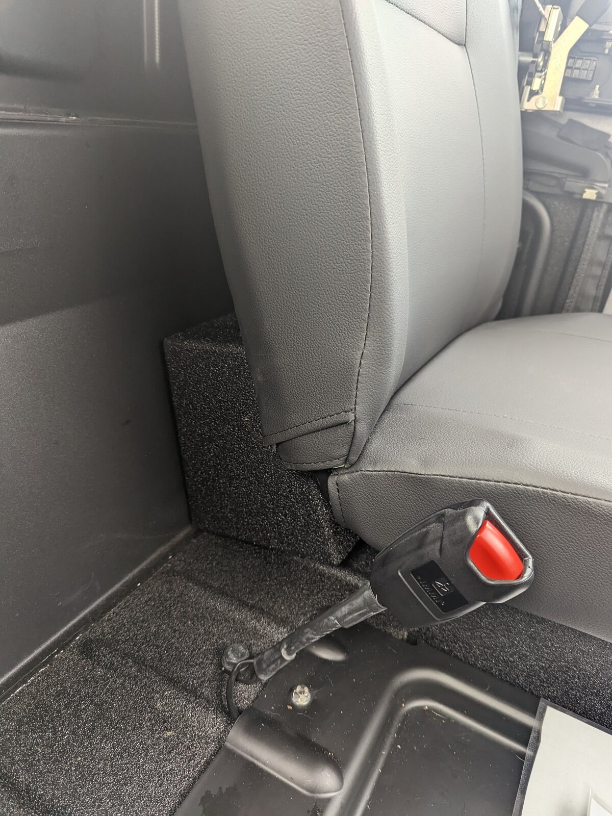

I added some 4" speaker pods to the roll bar. This helped with highs. Just having 6.5's in the kick panels didn't sound very good.
PXL_20230109_001353767.jpg PXL_20230114_014101510.jpg PXL_20230114_014111540.jpg PXL_20230109_001410899.jpg PXL_20230114_024740932.jpg PXL_20230114_024757726.jpg

I did the same thing with pvc pipe before for by sxs they sound good and looks like they are suppose to be there once painted
Barnboy
Nov 2, 2022
82
Cleveland Oklahoma

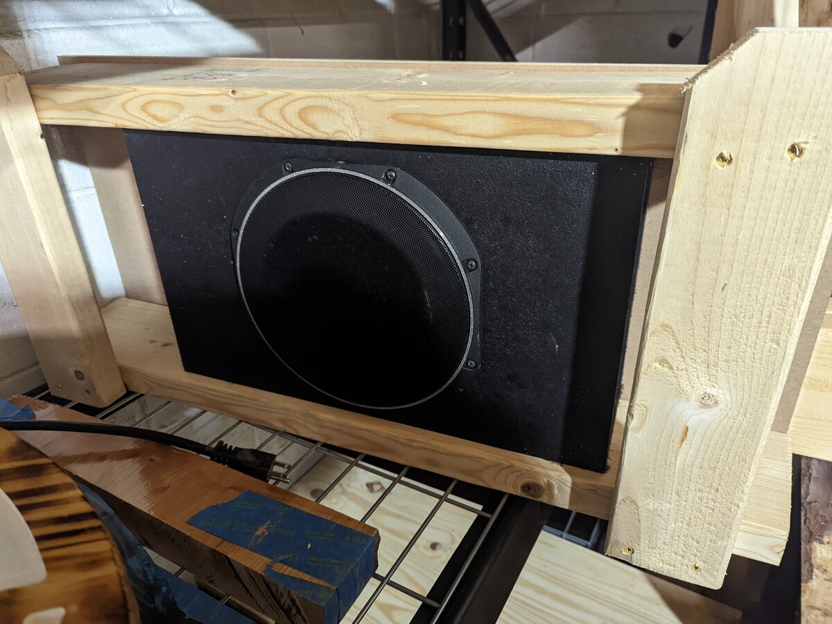

I'm still lacking mid bass. I think your 6x9's behind the seats would be good. I'm going to try a subwoofer and see how that sounds.
