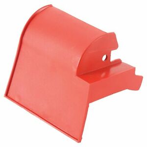

For you guys who uave mud etc issues could this starter cover be adapted for you?

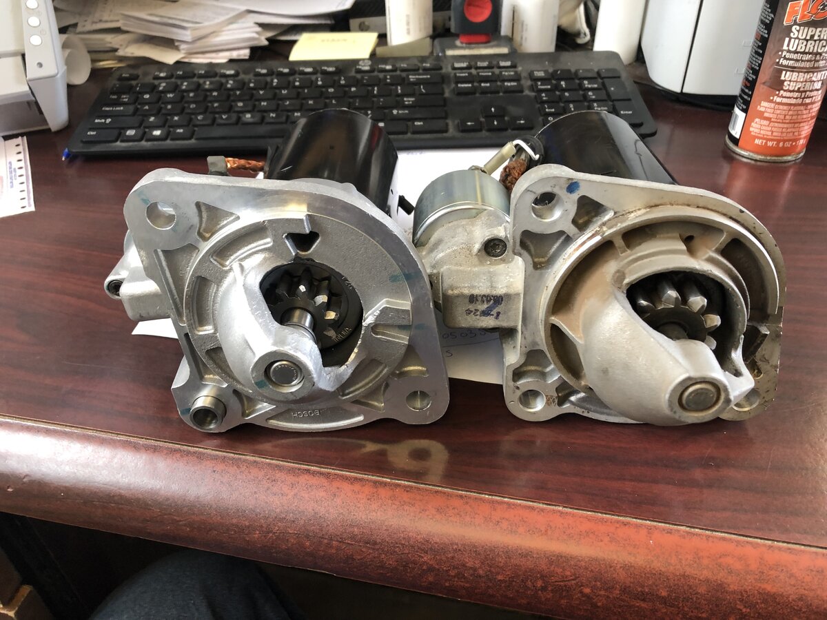

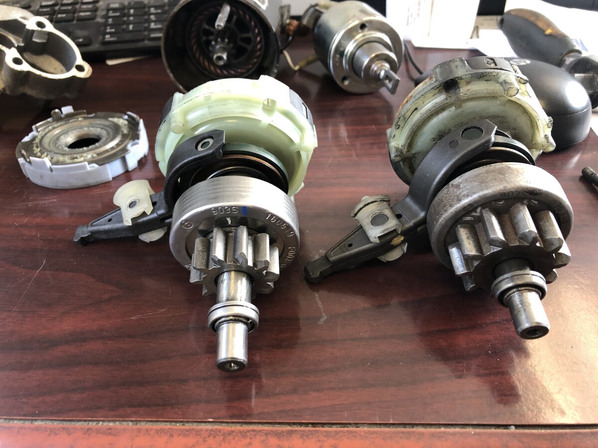

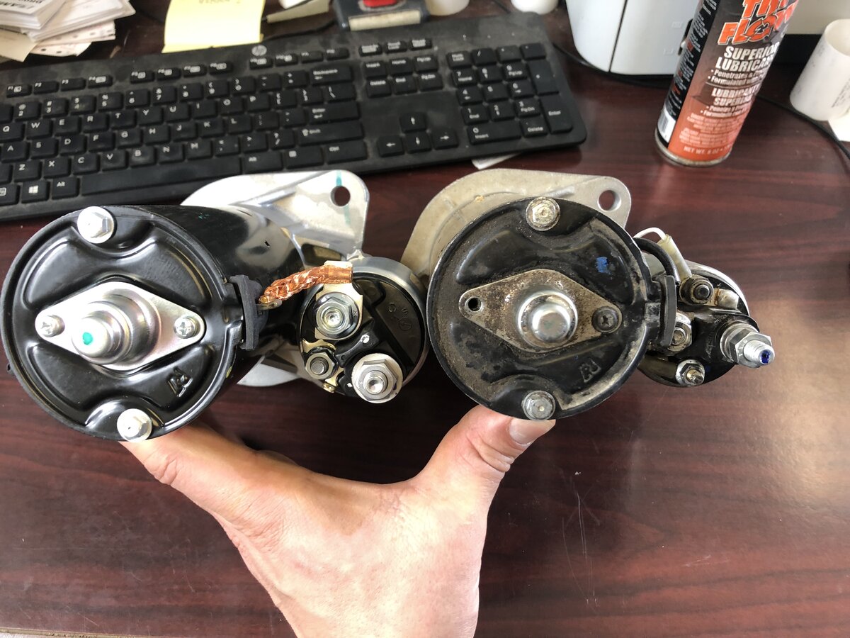

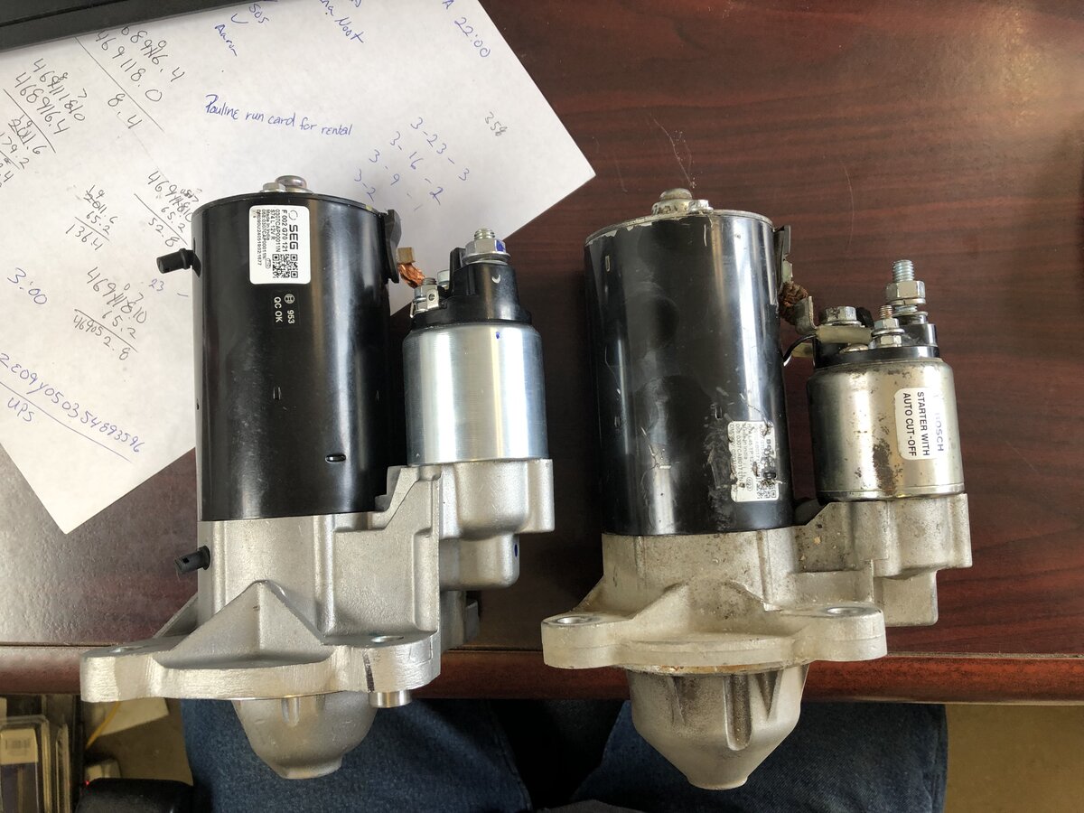

In the post above you, Kake America shows that the guts are the same between manual and automatic starters, just different housings, so you could buy one and swap them out. I just checked, and Diesel Freaks is showing auto transmission starters in stock

I ordered a starter from Leaders RPM a few weeks ago, they were showing them in stock. I received an email the next day that they are back ordered. I ordered one from Diesel Freaks yesterday, and although it’s for automatic transmissions, I can make it work on mine. I received the tracking number a few hours after I ordered it: it should be here by Monday. So if you need one, they are in stock

I received mine I ordered from Diesel Freaks, then the next day Leaders said they’d sent theirs I now have two if anybody needs one to get theirs going
