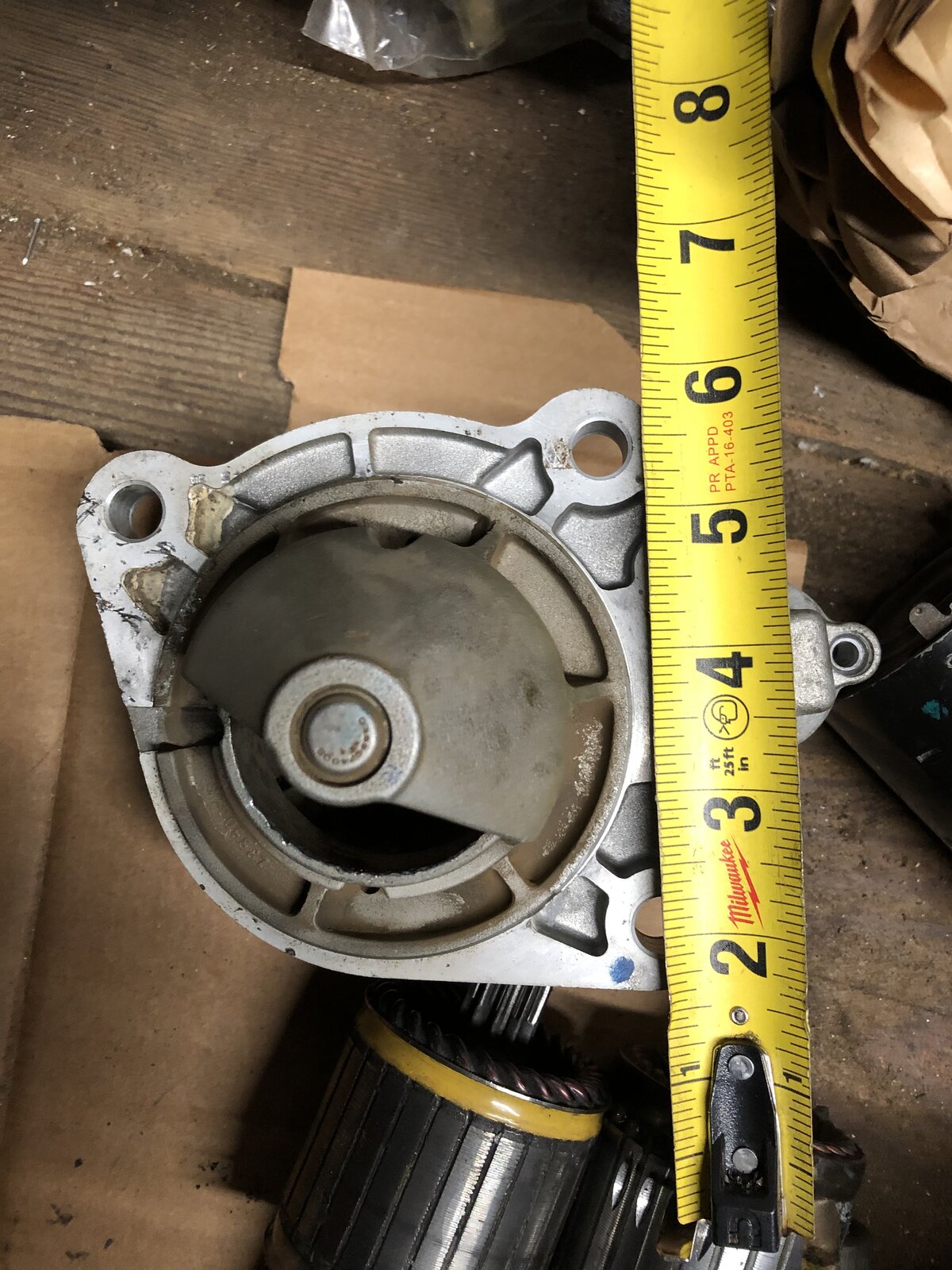

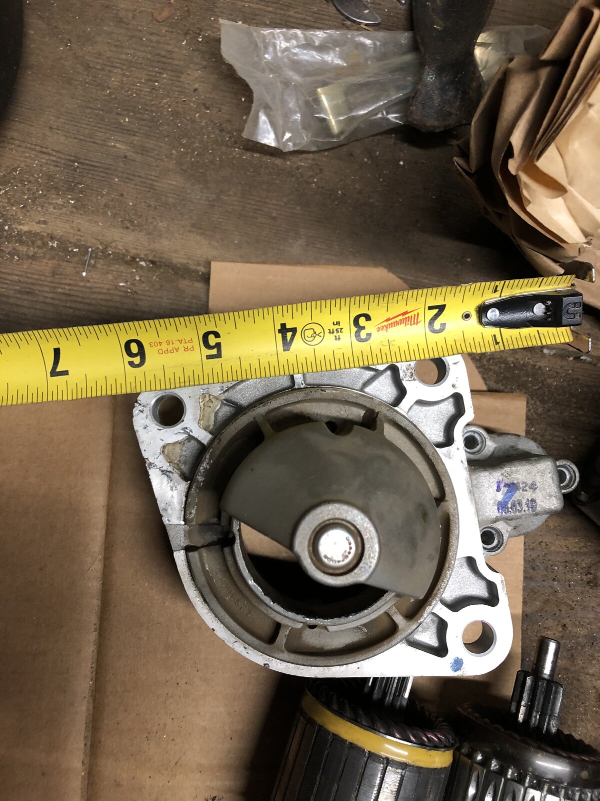

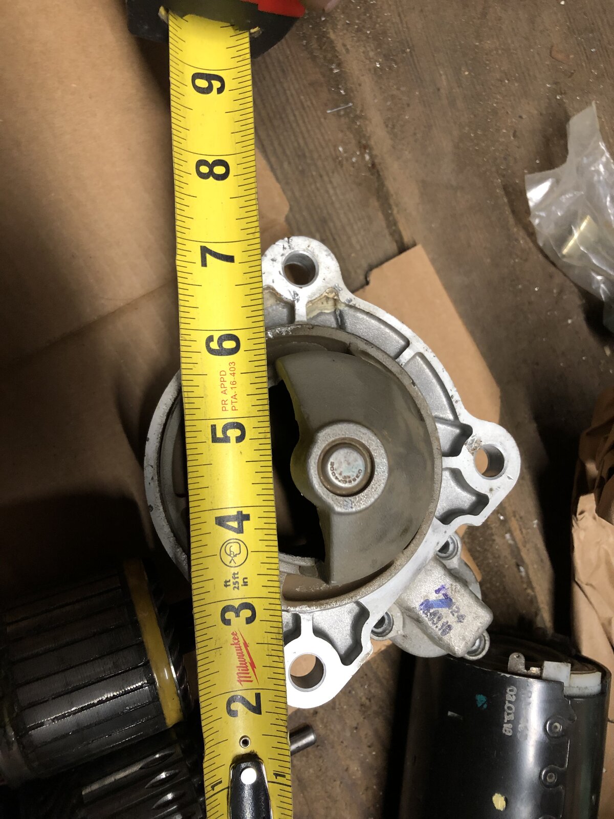

I just wanted to compare the different bolt pattern between a manual and an automatic starter .....how different are they?
I cannot say for sure but normally the difference is in depth of the nose cone. The bolt pattern should be the same but the gear will not engage properly with the ring gear on the flywheel

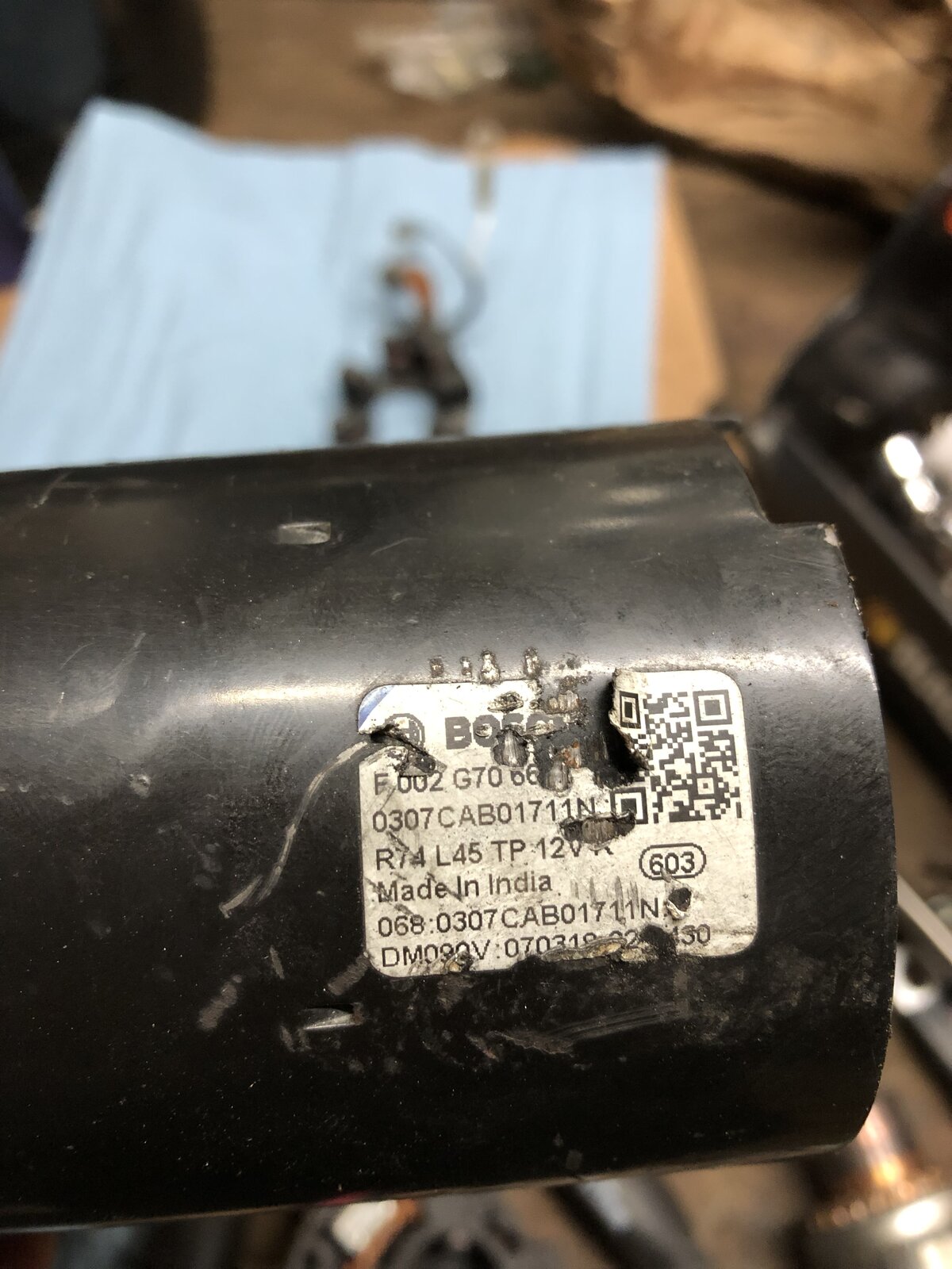

1,281
You have the part number on it?

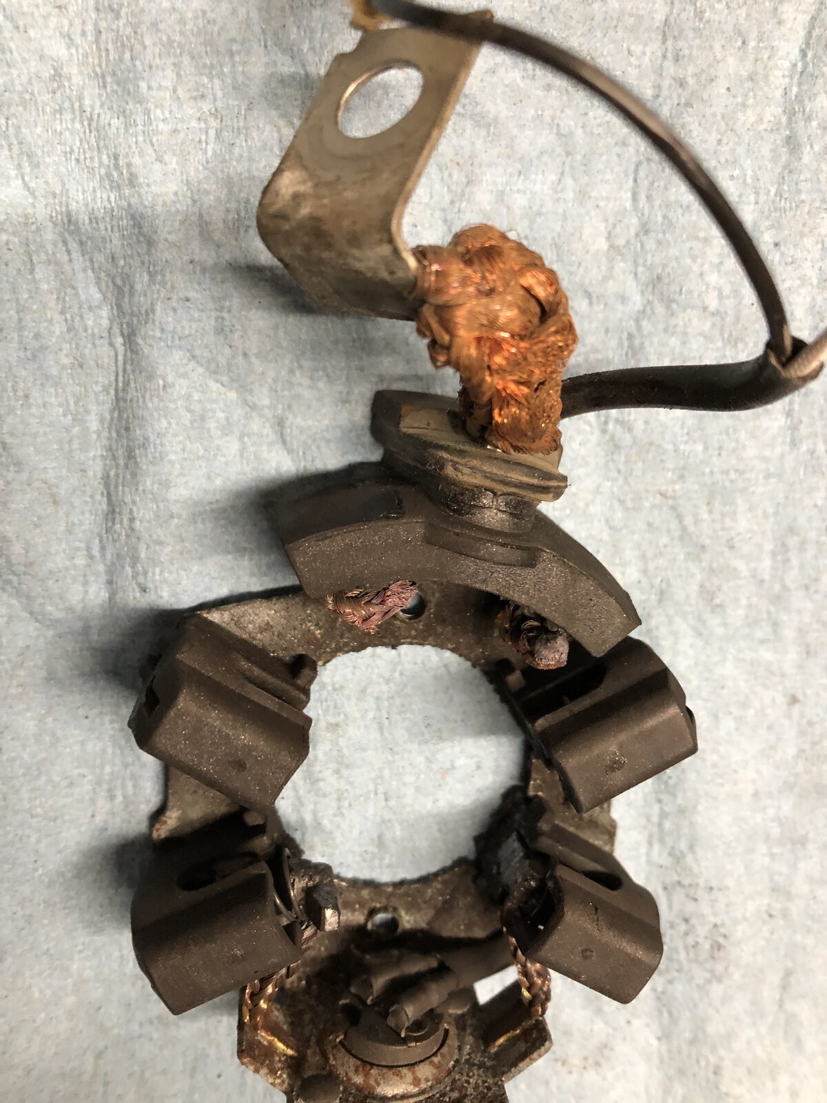

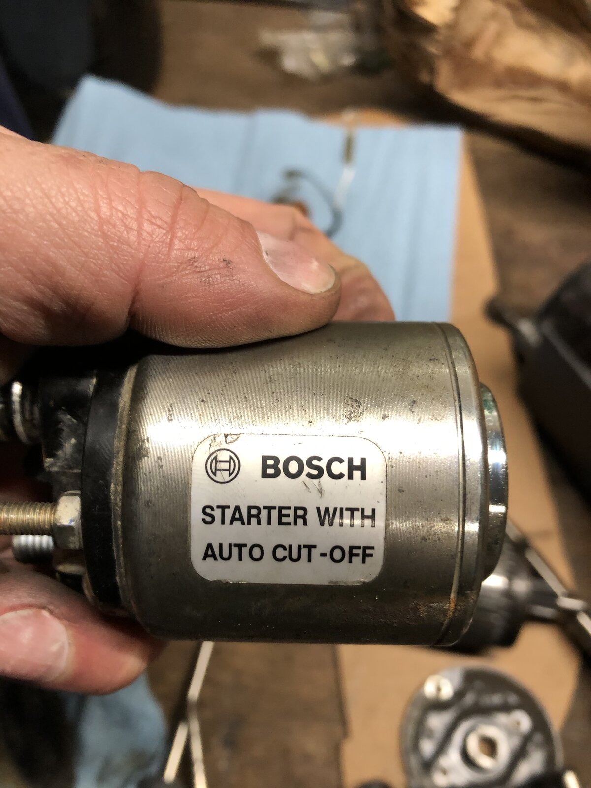

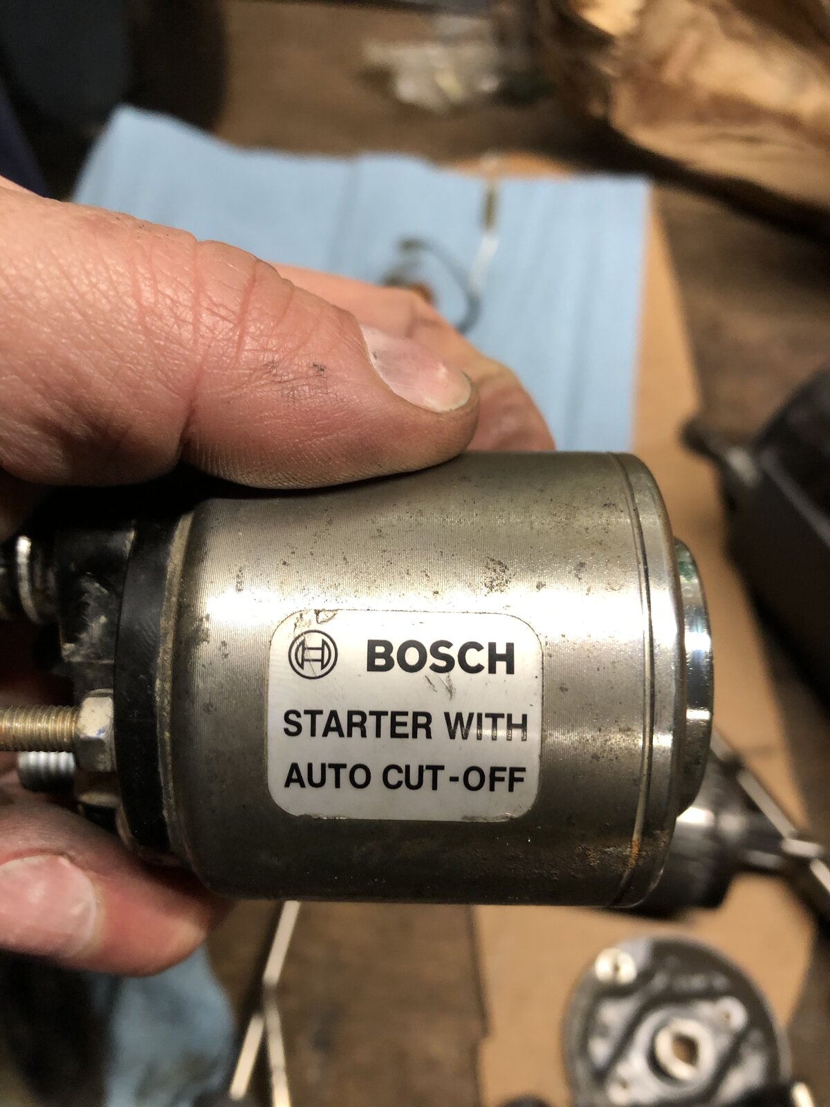

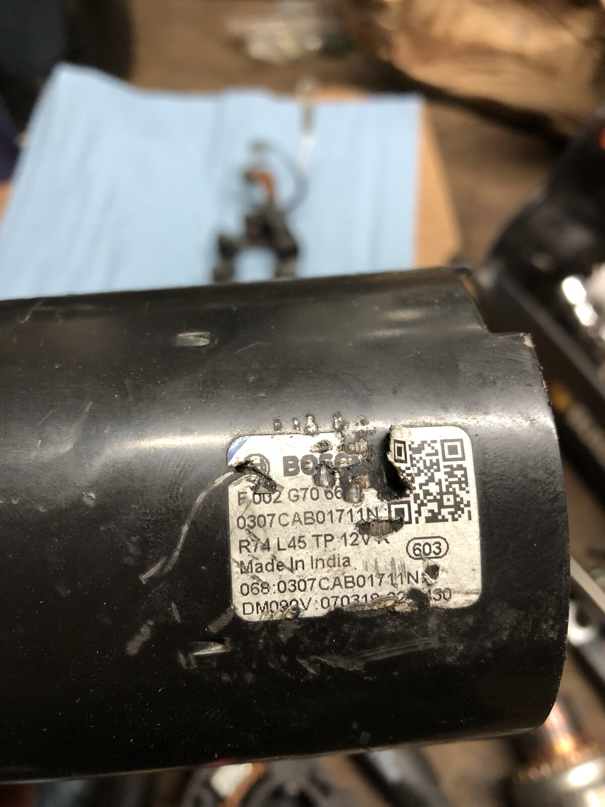

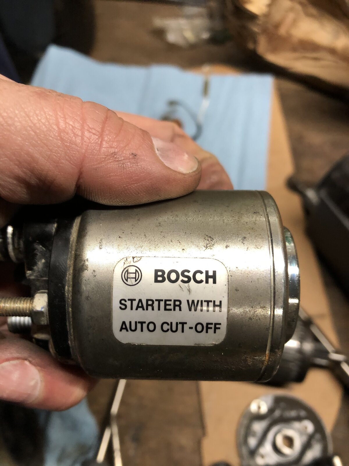

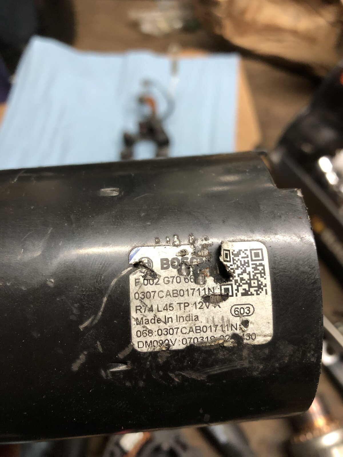

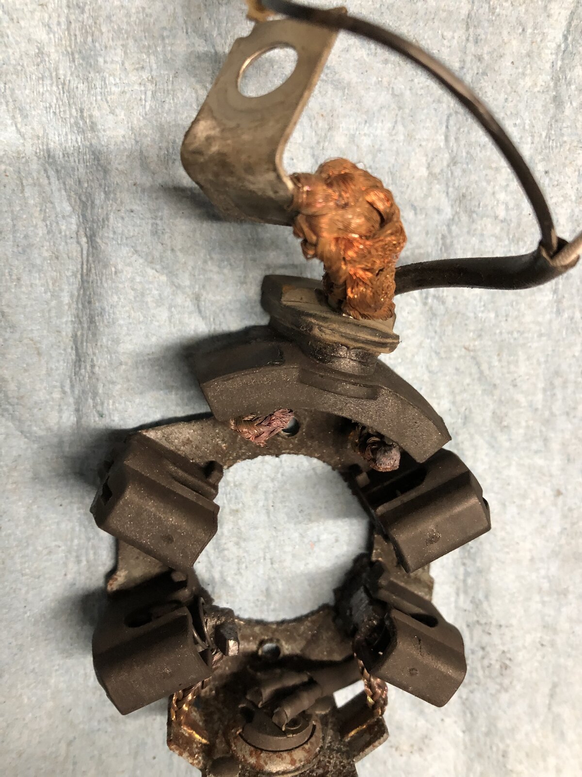

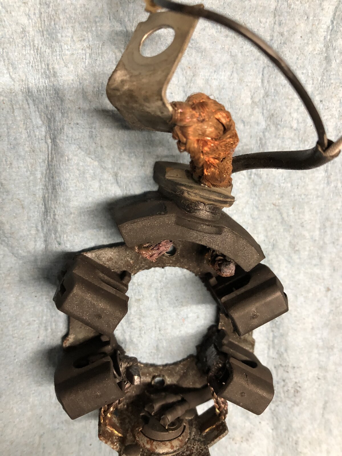

I guess that is why my starter isn’t working any longer. Brushes are completely gone.
8528A7CC-7A79-4796-BBD0-97B49F67B58E.jpeg 961DB819-1869-4562-BC70-DE46F2E2BA17.jpeg FF66621A-C011-464C-8F52-7E6A8B5F40E7.jpeg
1BB
Nov 9, 2019
62
Church Point, LA, USA
View attachment 10545 View attachment 10546 View attachment 10547
You know, I bet a dollar to a donut that the brushes in that Bosch starter, are the same across the board, and if you did a little searching, you'll find them online. I did a quick search just from what I could read off your starter and I bet this brush set will work. If not, I know the brushes will, so just take them off this one and install them on your brush housing. I used to rebuild starters and alternators all the time, and brushes are brushes across the board, and your housing and springs look fine.
I will say this though, if you can call and ask around if anyone has a "GROWLER" to check for shorts in the armature, do that before ordering parts, because if your armature is shorted, which rarely happens, then there's no sense in going any further. Clean up your commutator with fine emery paper, add a little high temp lube to the bushings and call it good.
