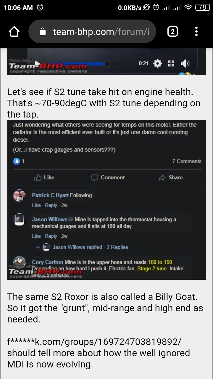

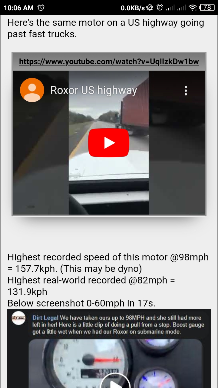

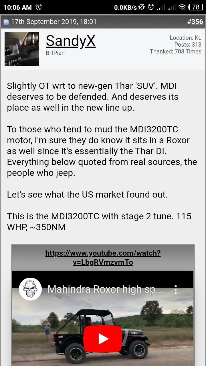

FWIW, some real world info on the stage2 tune I gathered for somewhere else.
876
That Diesel Freak speed test makes me definitely optimistic.
