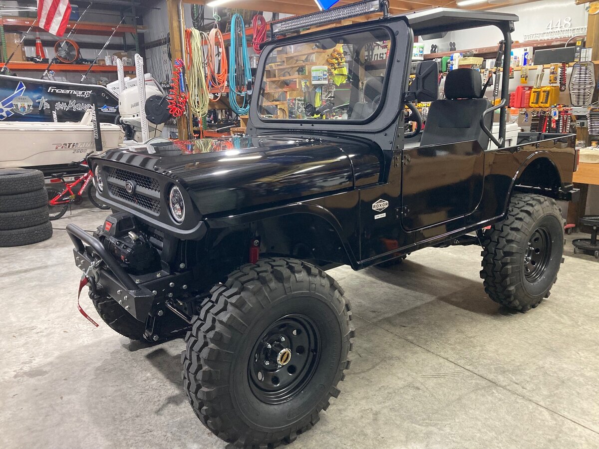

Ok, so I've spent the last hour reading thru threads about lockers.
My initial thought was to put the spartan lockers in the front and a limited slip in the rear since I'm about 80% off-road & 20% on-road.
So here are my questions:
- if I did spartan lockers in the front and rear and will this be horrible to drive on asphalt?
- who makes a limited slip for the rear?
- does anybody have 1st hand knowledge + feedback of the Spartan in the front and rear, when driving on asphalt? Is it solid (full posi-trac off road)?
- does anybody have feed back on a limited slip for the rear?

I have the spartan lockers front and rear. I installed the mm hubs at the same time so on road drivability is only impacted by the rear, and is very minimal. The rear is a bit noisy, and will cause a bit of lurching at low, constant speed cornering. I've gotten to where I anticipate it most of the time and can avoid it by pressing the clutch and coasting through the curve, or mildly accelerating. Bang for your buck they serve the purpose extremely well, and I couldn't justify the extra price for a bit smoother experience from a high end locker. I cover a lot of uneven mountain trails and never feel the need for 4wd. In sand and snow the 4wd is amazing with them. I've put about 7k miles on them so far, and have nothing but good to say about them.

Spartan Lockers are on order for front and rear.
I'll post a video when I get them installed!!
