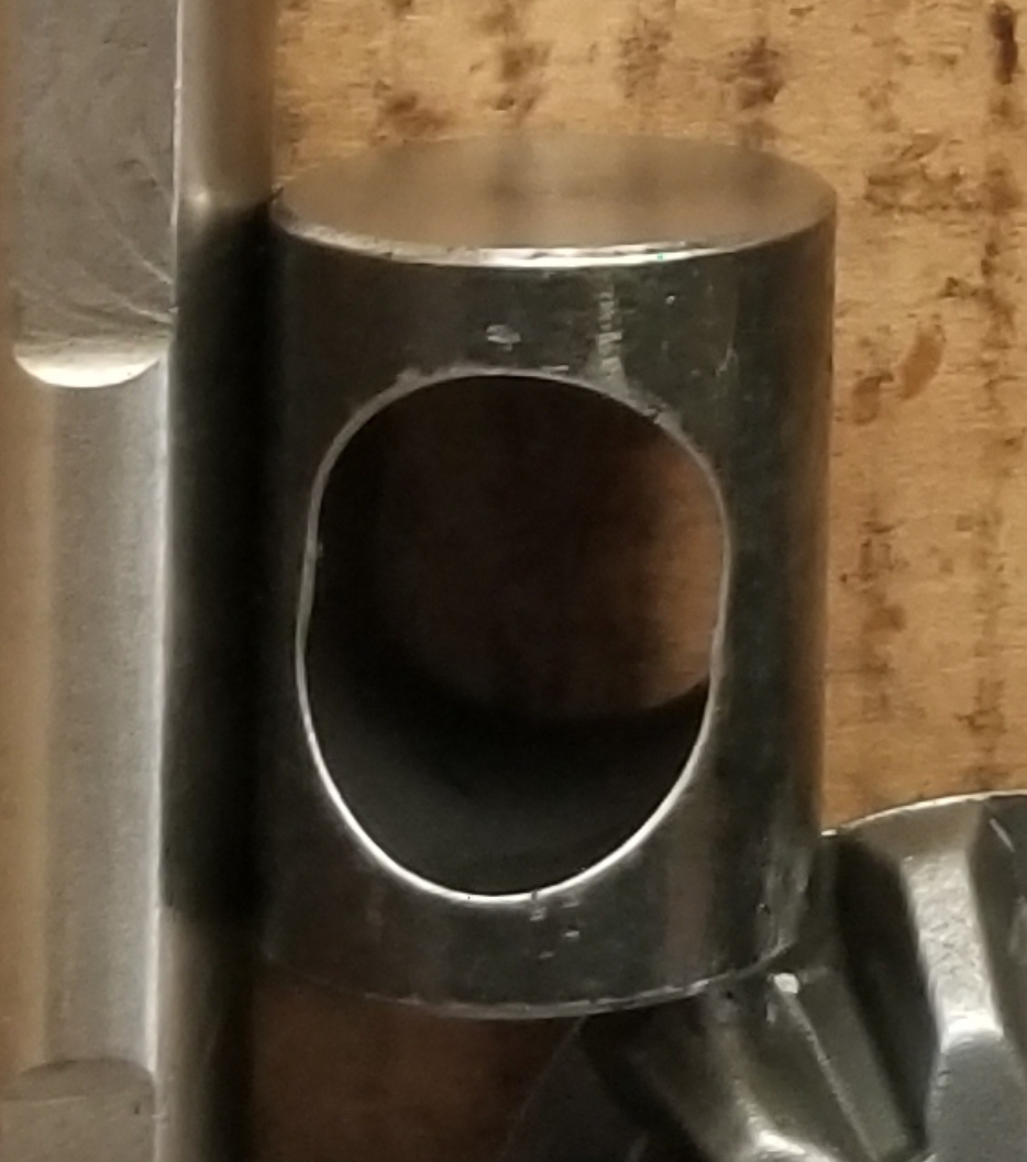

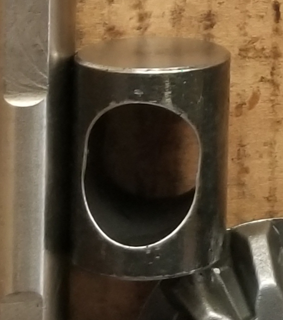

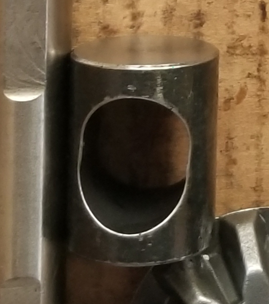

So what was the problem? I have the same issue, Just installed the spartan. Seems to work fine but has a scraping noise.
2,194
99% of the time they forget to put the org. spacer back in. Did they give you a box with the org. parts? It is a cylinder shaped spacer with a whole in it. I will try to port a pic of it. I posted it in the past.
2,194
Here is your culprit my friend. They need to put this spacer back in.
That has happened to a few folks. Some more details in the install instructions might help. I had mine front and rear done at 2 different shops, both put it back in. It came up online that it is not required in the front (unconfirmed) due to how the axles are held in, but I don't mind it being in there.
