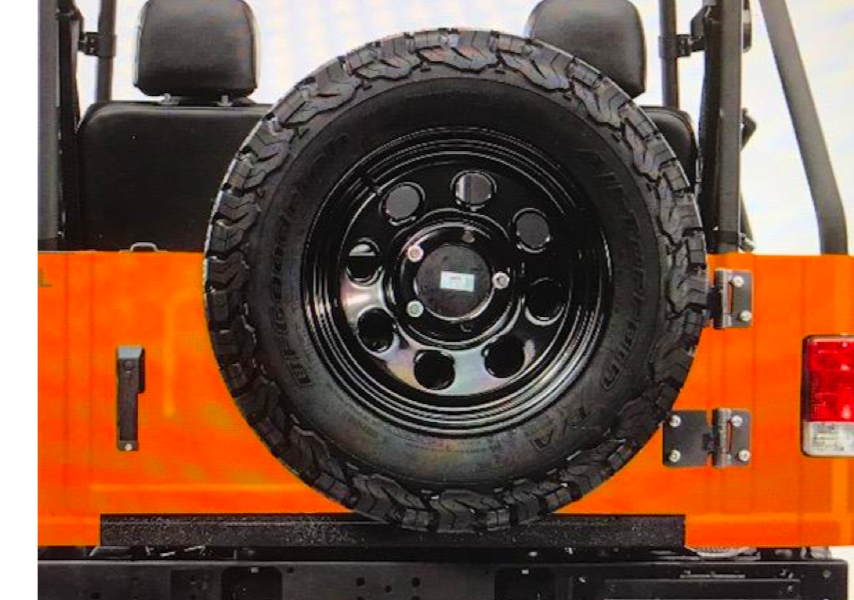

I noticed that I could not hook up my log splitter with the spare tire on, could not push the lock lever down.
JonBoyK
May 2, 2018
42
Factory size or did you go bigger? I dont have an issue with my factory spare

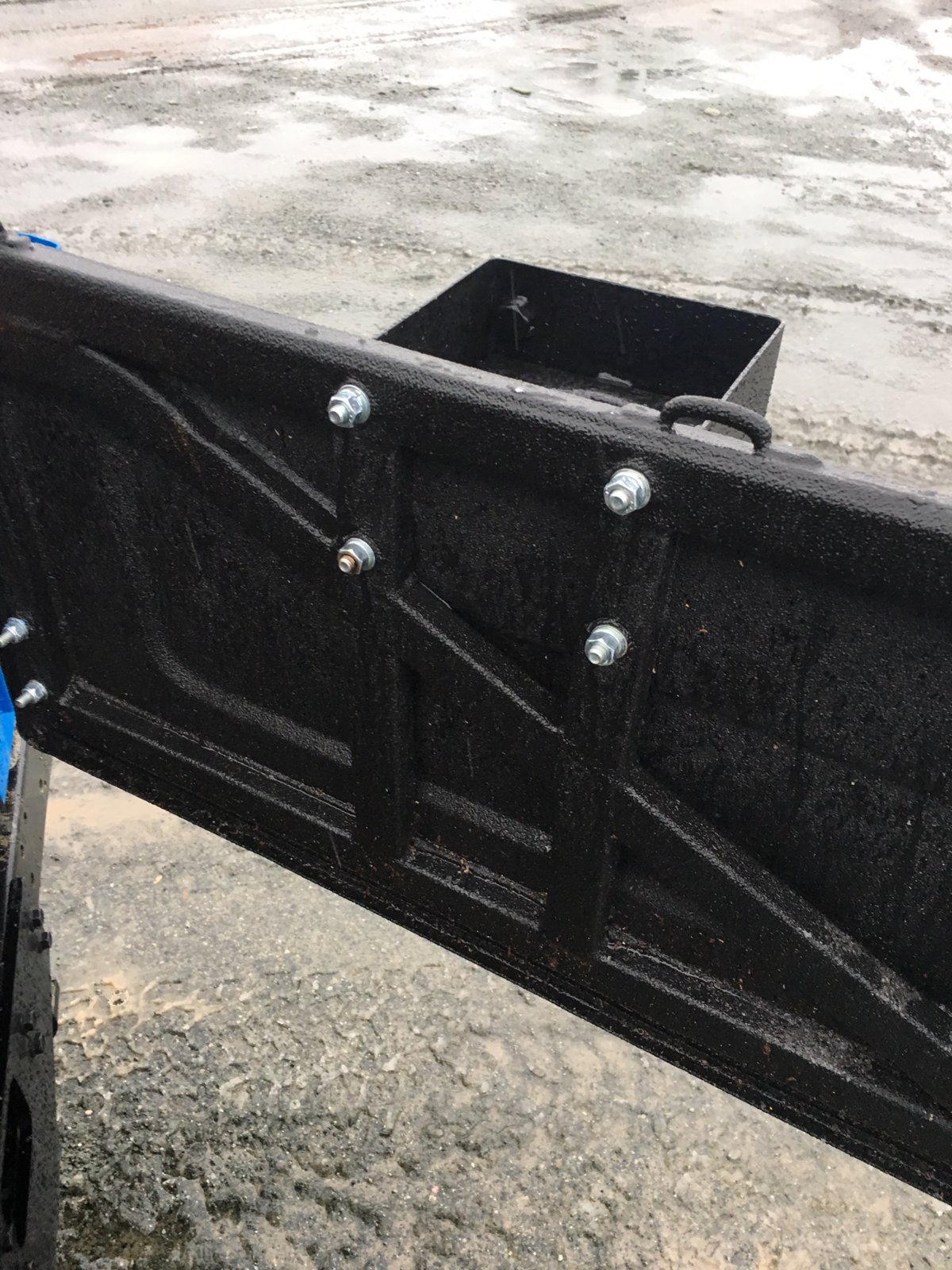

I’ve had the same issue hooking up my splitter. It’s a pain. Have to hook it up with tailgate open just right...till I spend more $ on receiver hitch bumper.

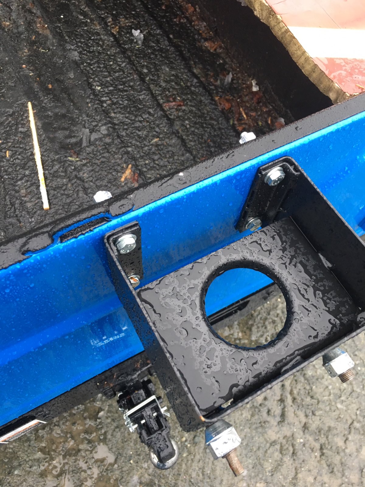

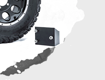

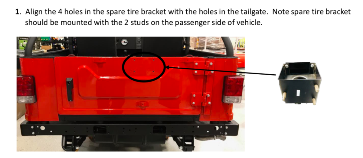

I been trying to find a few pictures and I read the install instructions. It looks like the way you attach the mount to the tailgate might change the height. They suggest the 2 bolts to the passenger side, not sure why, but maybe they have a reason. I don't have a mount and can't find any really good pictures, but it looks like if you flip the mount so the 2 bolts are to the drivers side (like it is sitting in the picture), it might raise the tire. I wonder if the guys here that have no problem, if that is the way your mount is.
If you guys can take a picture of your spare tires and post them here, we might see if there is a difference. Just a thought.
PS: I could be completely wrong on this, I'm just going but what I can see mostly in the attached picture.

Yes, now that you bring that up that is the issue. The 2 bolts are to the pass side right now with the angled side of mount facing down on mine. Looks like it should be easy to flip over. Not sure what their reasoning would be for it the way it came. I’ll try it tomorrow. I should’ve noticed it before but never studied it.
The way it is is the recommended installation according to the instructions.....but I don’t know the reasoning behind it. The picture in their installation guide shows them to the drivers side, opposite of the written instructions.
Let us know how you make out.
Flatlander
Feb 7, 2019
26
Morris, IL, USA

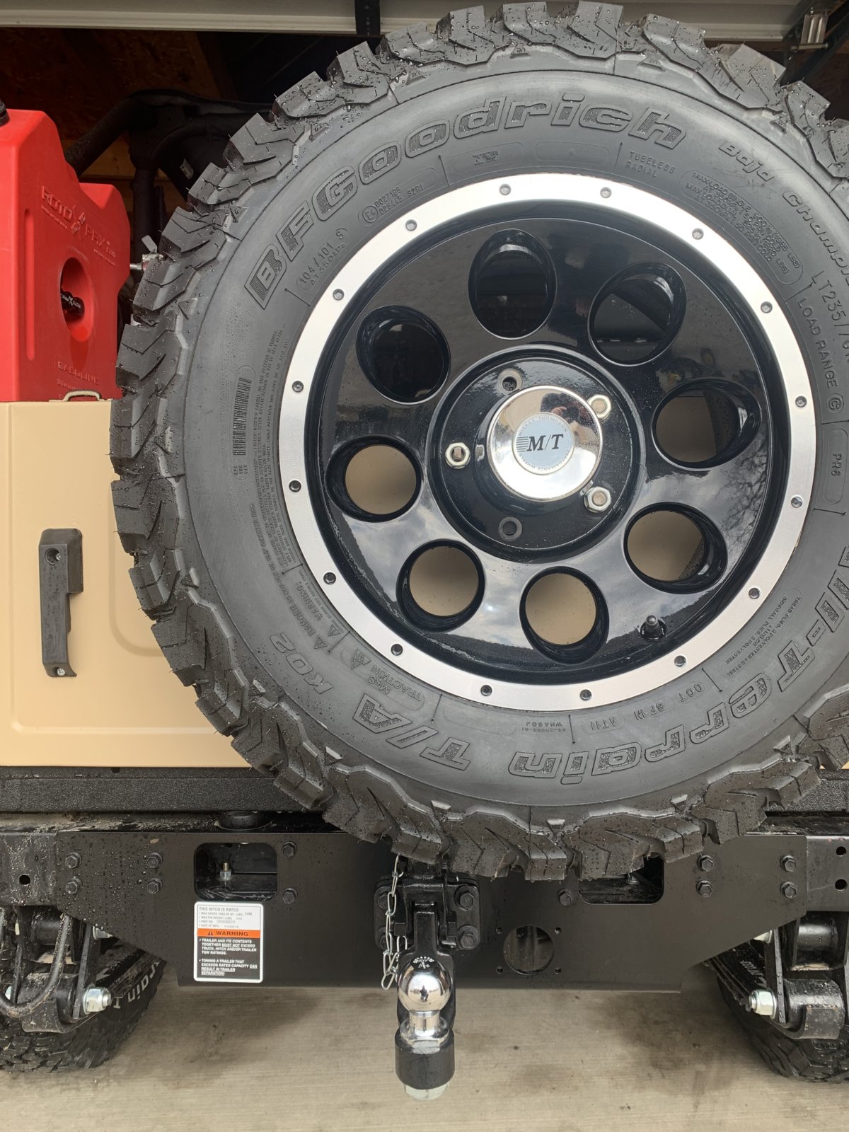

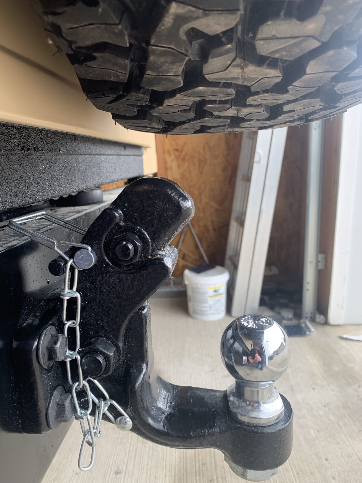

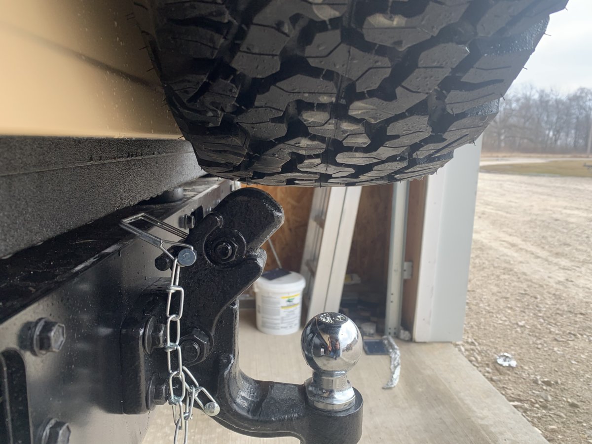

I flipped the mount over and gained 1-1/2” between the top of the trailer ball and the bottom of the tire. Went from 4-1/4” gap to 5-3/4” gap. I haven’t tried hooking it up to a trailer yet but looks like it should work now. My trailer hitch style that’s been causing an issue is 6-1/2” high with that latch sticking straight up but should be able to sneak it in there. Here’s before and after.

Thanks for the update. I wonder what the reasoning is in the 'official' instructions are for having it the other way? It really doesn't make sense if it impedes the hitch. I wonder if someone made a mistake or they know something we don't.....

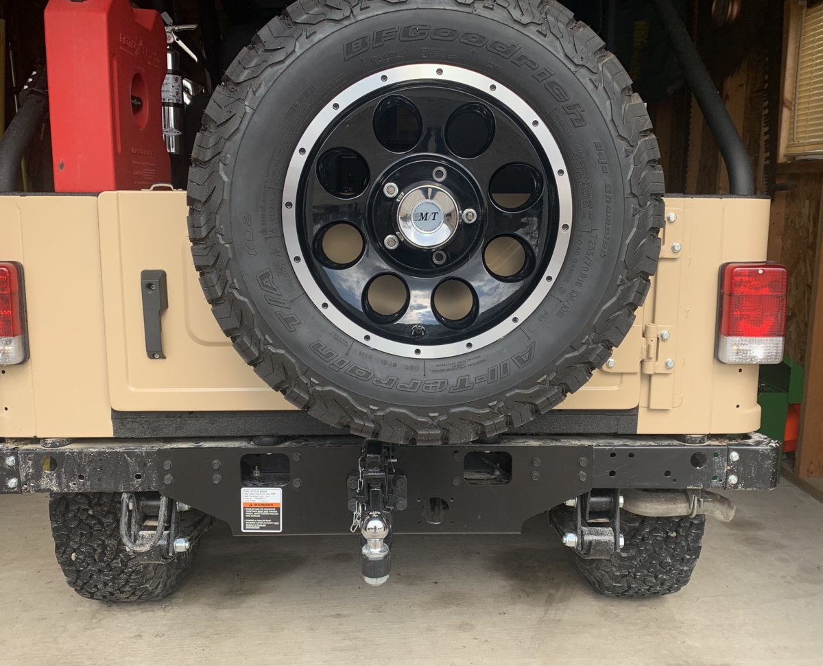

That is the way the factory instructions say to mount it, but then the picture in the instructions show it the other way. I assume the picture is wrong. Just an oops on the picture I assume.
If you flip it around you will gain some clearance, I have no idea if it will fall off if you do or why Roxor has it mounted so close vs higher. lol
