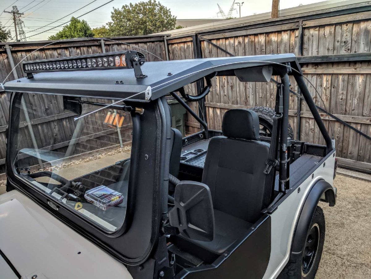

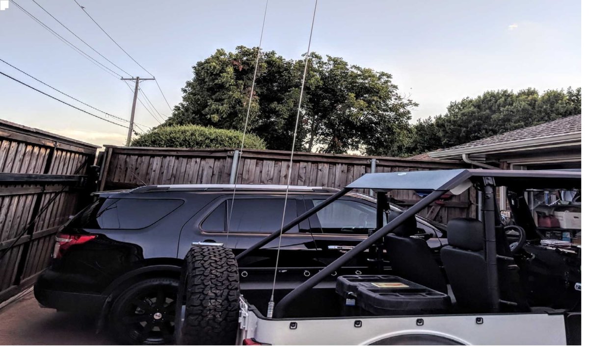

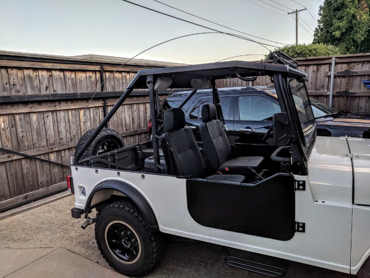

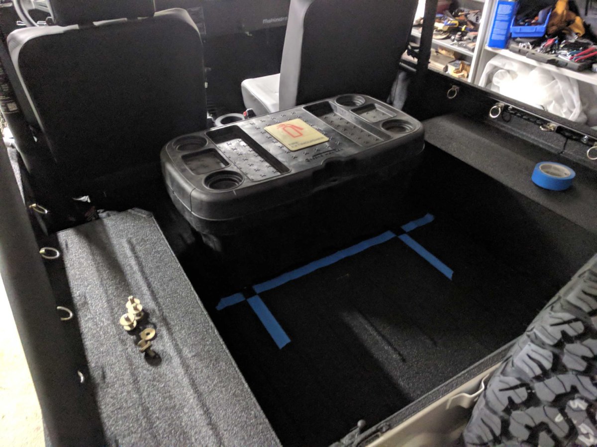

I gave up on anything in there that makes a s h i t staying dry. I mounted a GEAR BOX behind my seats. I mounted some track to the floor and used some old aircraft seat studs from an old G III I had laying in a box of track fasteners I had.
It's bolted down solid. Takes 2 minutes to spin off the threaded retaining washers. Pull the box and the track fasteners slide out if you need the floor for other items. I store, jack, tire pump, plugs, rain gear, tools, come a long, rags, coolant, oil and lots of stuff. It's full! Lol.
Here are a few pics with it installed. I basically plan on it being there 100% of the time.
roxor truk trak 3.jpgRoxor Antenna 3.jpgRoxor Antenna 4.jpg Roxor Antenna 2 - Copy.jpg
