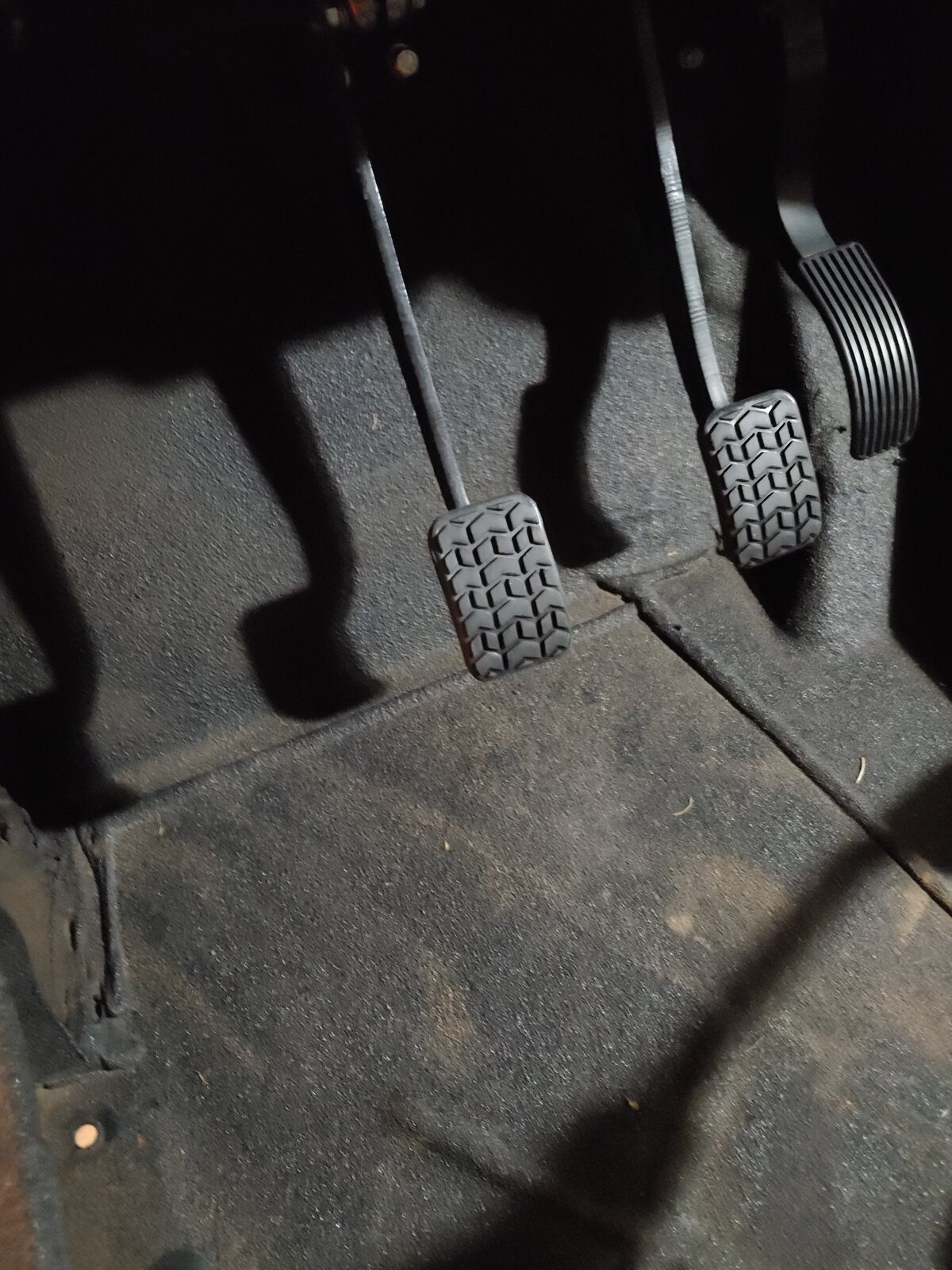

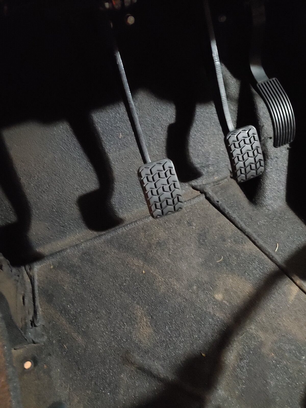

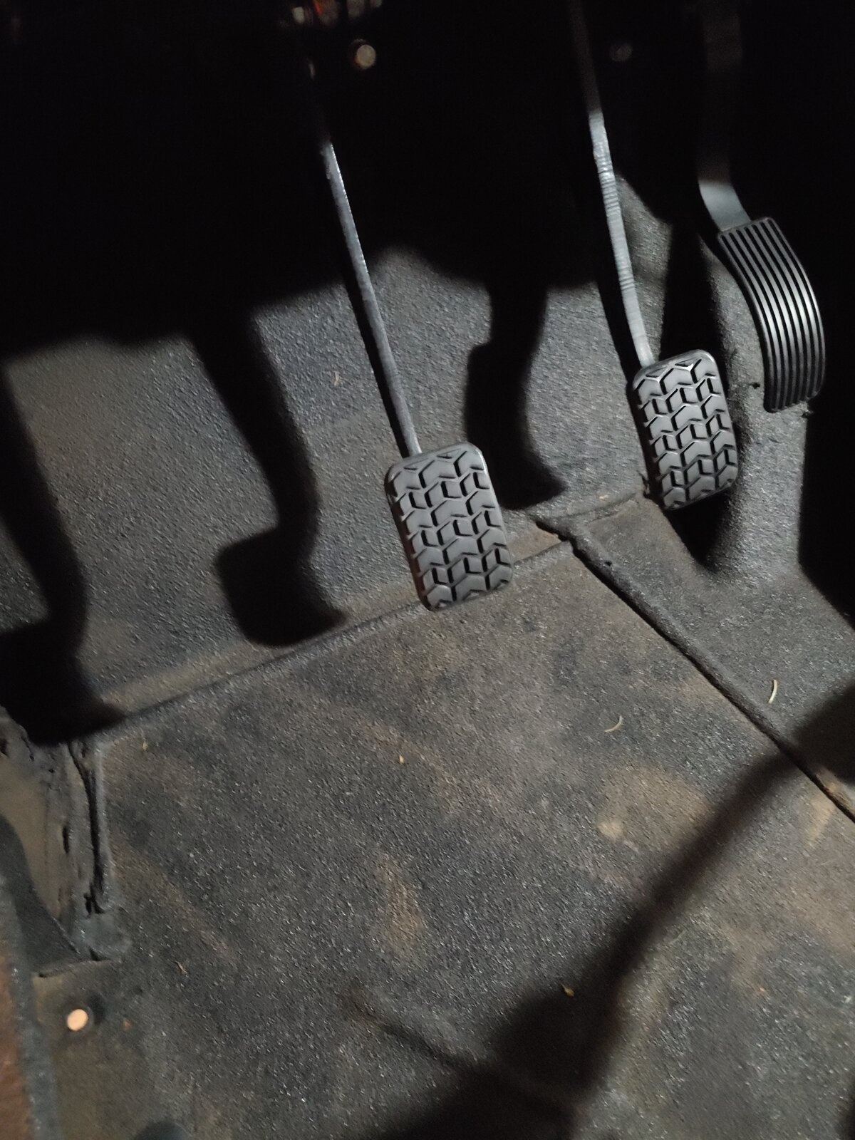

I just put these on as well, they fit perfect.
2,266
Honestly, it was super easy I slid the top on first and then gently pulled the bottom and slid it on as well took seconds and they are on solid, now we will see how they hold up.

Yep. Just put mine on. And yes, I would also like to thank the guy who figured out that the Mazda part would fit.???

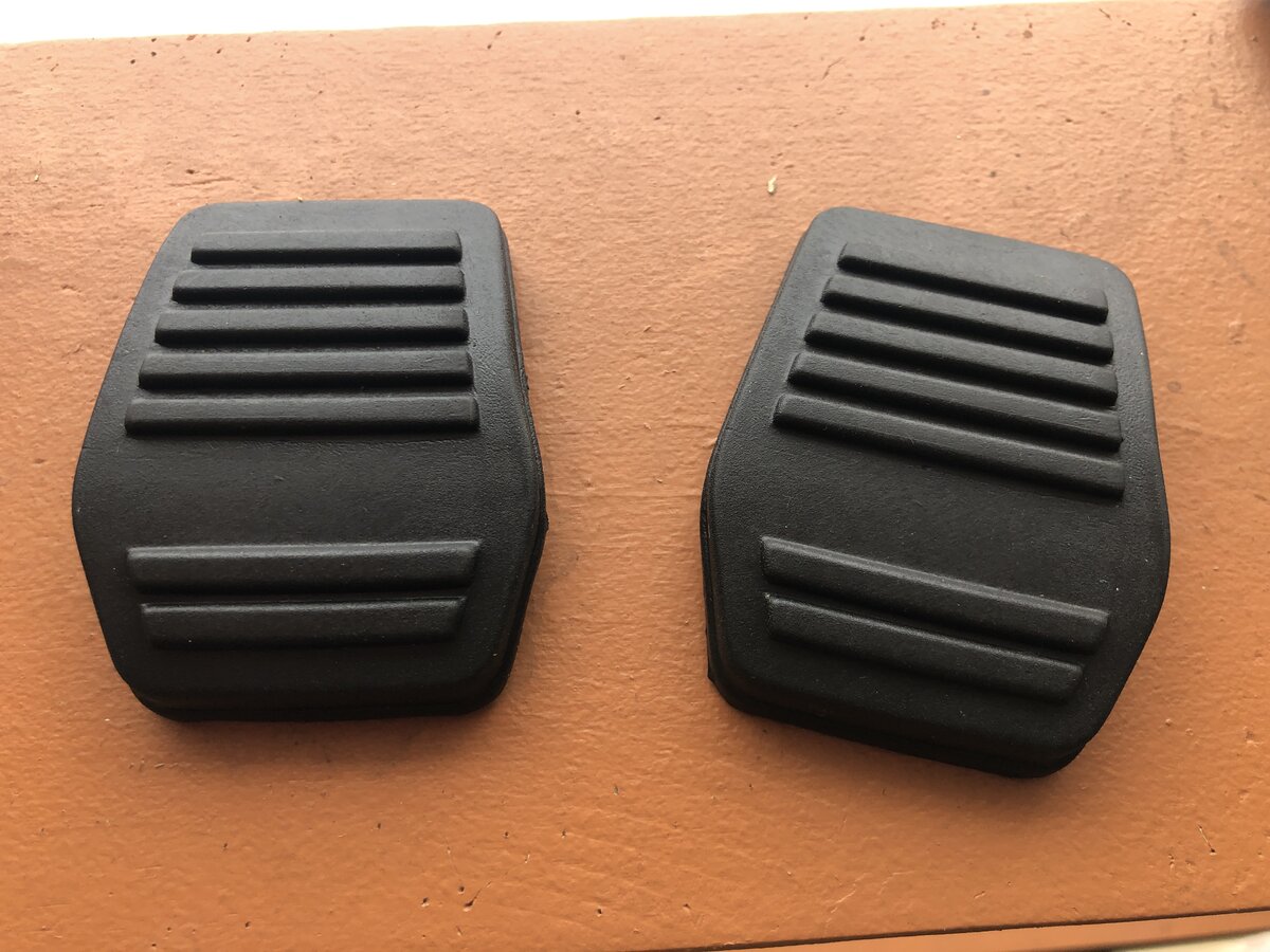

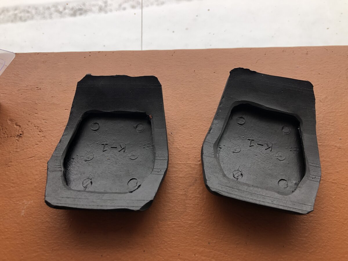

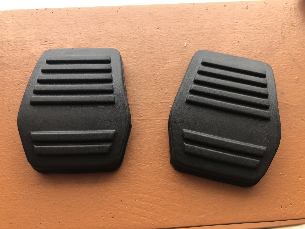

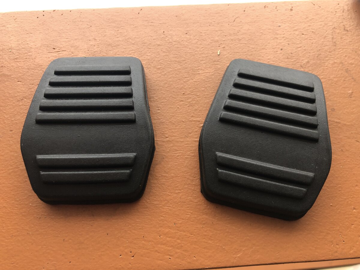

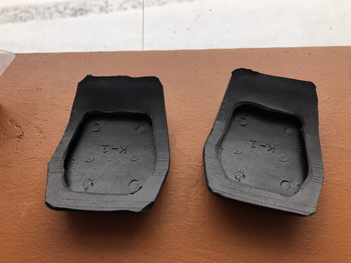

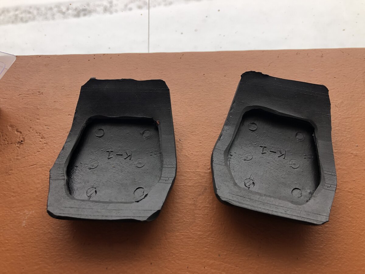

These are the new ones I got from Mahindra. They are like $2. I guess we will see how they hold up. Seem to be a lot harder. Right now they are lasting awesome sitting in my shop.
View attachment 7936View attachment 7937
I replaced my original rubber peddles with these ones a couple weeks ago. No issues noted so far.

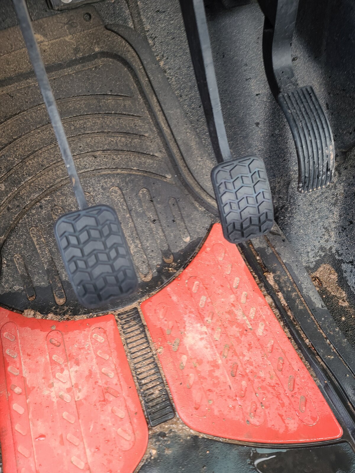

I'll bump this one up since it may help another guy. This worked awesome! Way easier to work with than those rock-hard OEM replacement ones! Easy install.

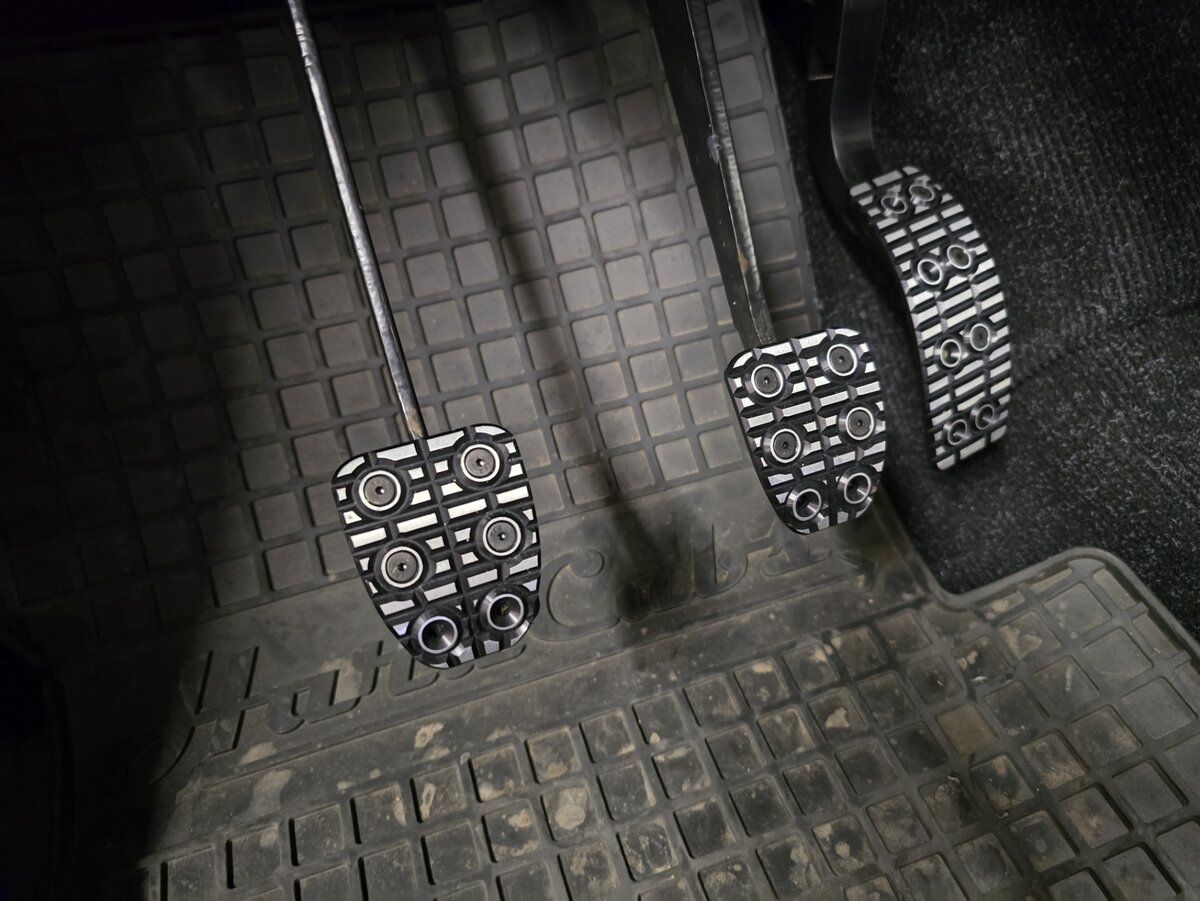

Just installed these today:
There are also ordered for a Miata, but full aluminum. Comes with the bolts. The throttle pedal needs to be formed to fit the acelerator pedal as the Miata pedal is not quite as rounded, but not too hard to bend with a rubber mallet. The brake and clutch pedals fit well also, just need to keep tightening the bolts on a circle to pull the pedal flat to the factory backer pedal.
