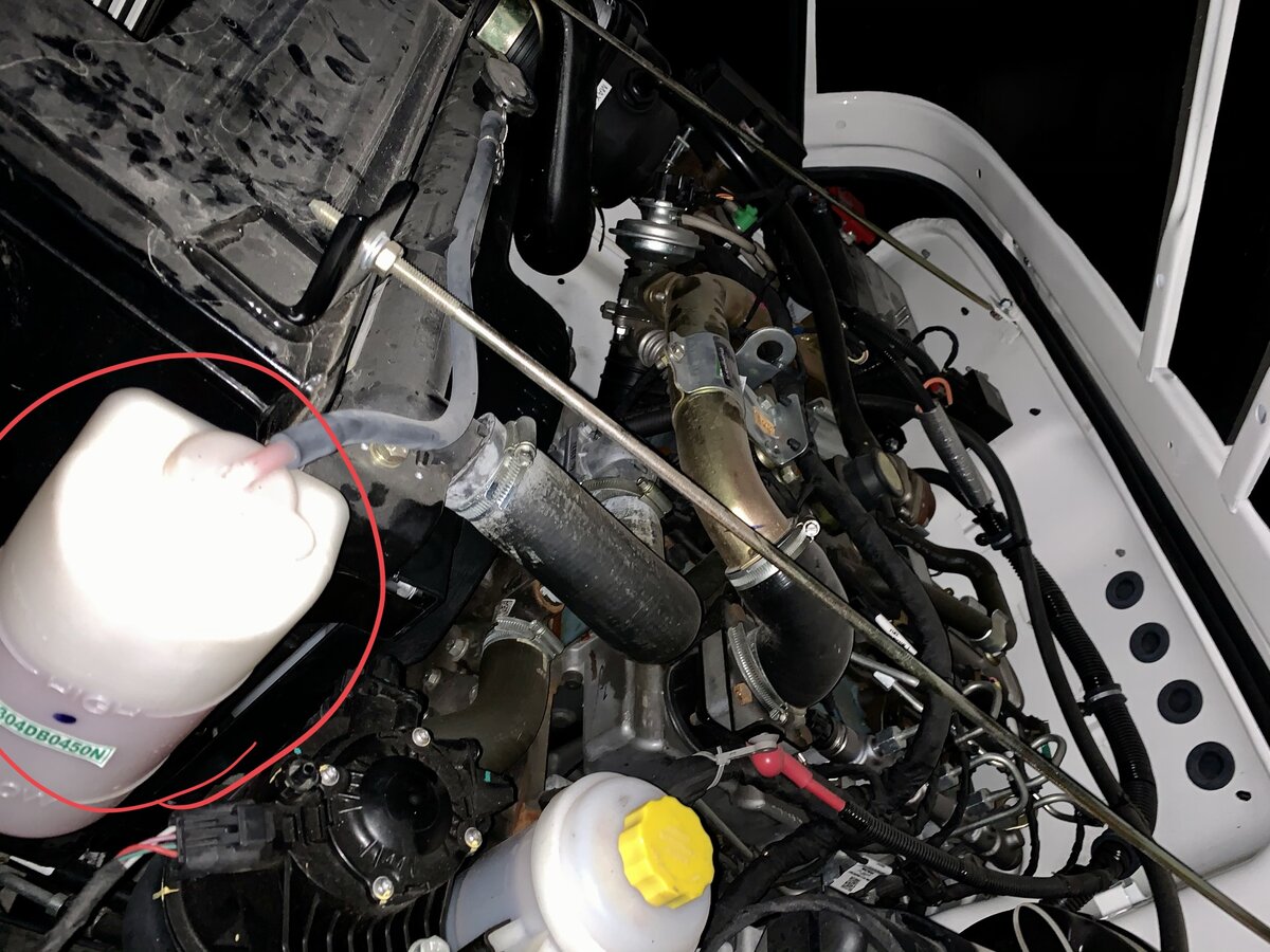

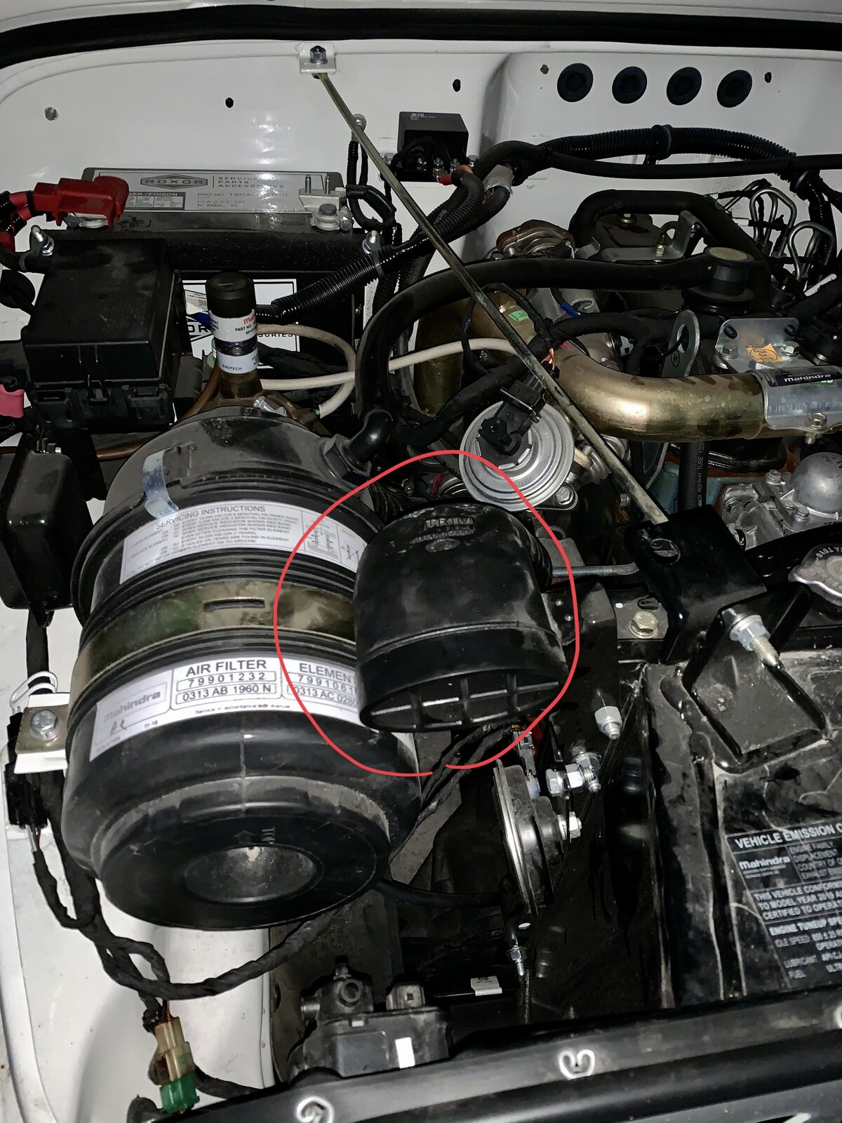

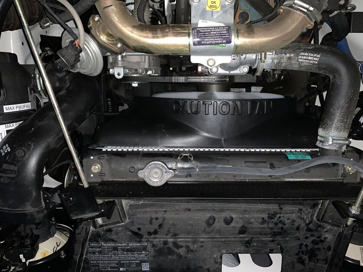

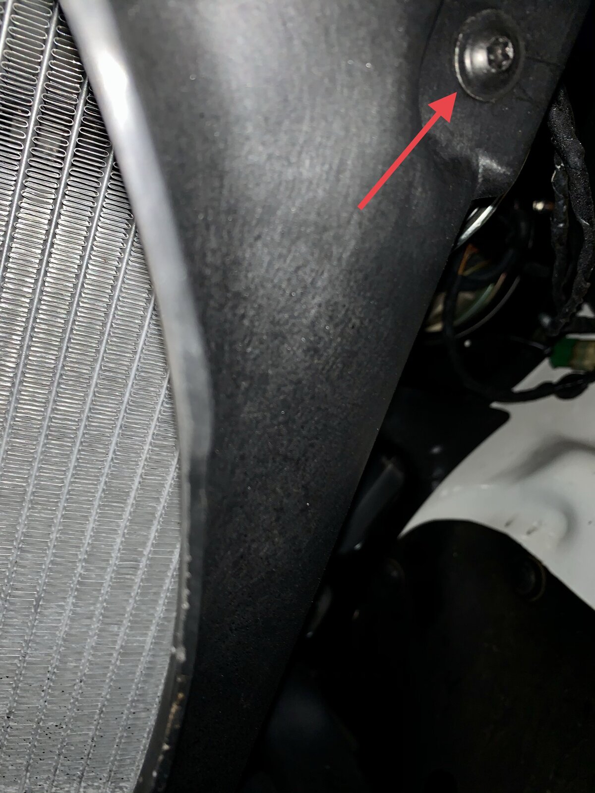

Hope it helps, remove the two items circled in red makes it easier, the air intake out of the way makes it best to slide in the shroud. I did not disconnect the coolant hose!
