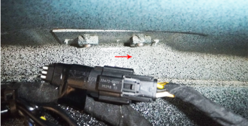

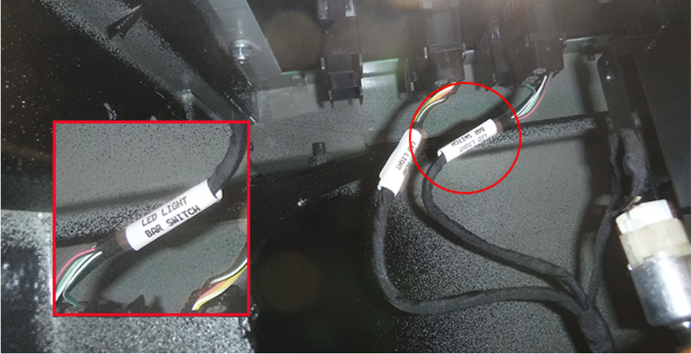

Anyone who owns a 2023 HDUV, please take a look under the dash and confirm whether you have the below harness connectors installed.
1. Passenger side up under dash, looking for harness with connector and cap.
2. Driver's side left of steering column. Looking for two harness connectors attached to two dummy switches.

I just got home from Thanksgiving at the camp and had a chance to look. There is a harness on the passenger side that looks like the first picture. There are also two switch plugs connected to the switch cover plates. One is LED Light Bar Switch but the other says Two Speed Heater. This is a little different than the original models but could be useful. Hope this helps.

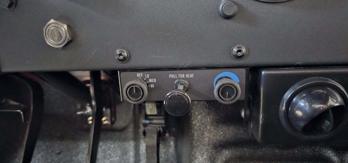

I have a rotory style fan switch on the dash, but I also have the 2 speed wire harness installed on a blanking plug. There are two other harness connection going to blanking plates. One is for the LED light bar and the other is not labeled. It comes with an extra plastic connector ziptied to the back .

You have 3 harnesses attached to blank-off plates. I only had two harnesses, one was LED light Bar and the other was 2 speed fan motor. I did not get the all weather version, but if you want to do like what I did, I am sure it will work if you simply attach switches to the LED Light Bar and 2 Speed Fan harness. I ordered two Mahindra OEM 1803AUA00041N switches from Sherwood Tractor Parts because I wanted the "light" symbol on the switch. These are backlit when the headlights are turned on. Mahindra Roxor OEM 1803AUA00041N Forward Light Accessory Switch. It is a common EATON switch, but I don't have the EATON number, but the EATON number has been posted on this forum before and you could find it if you needed to order it with the EATON number.

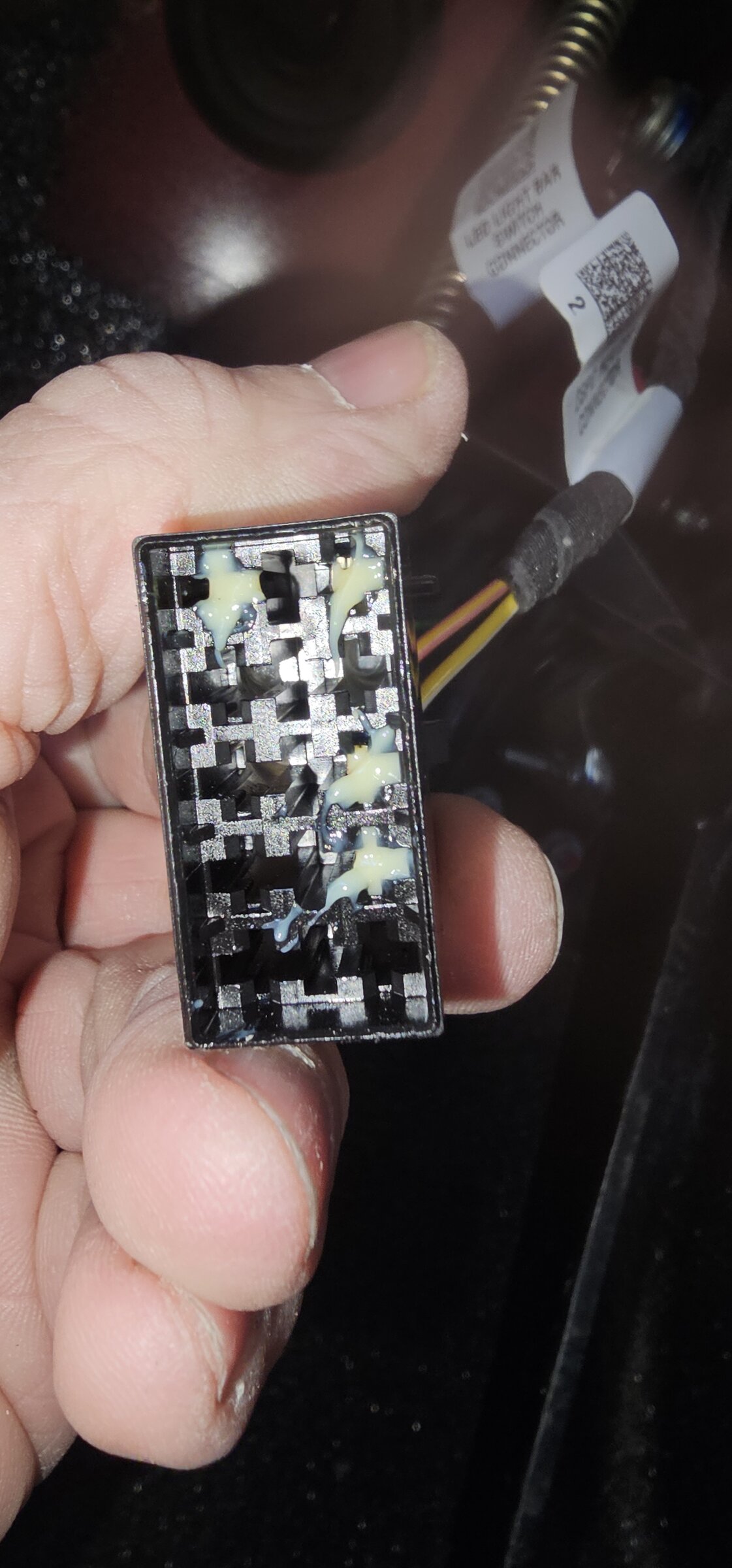

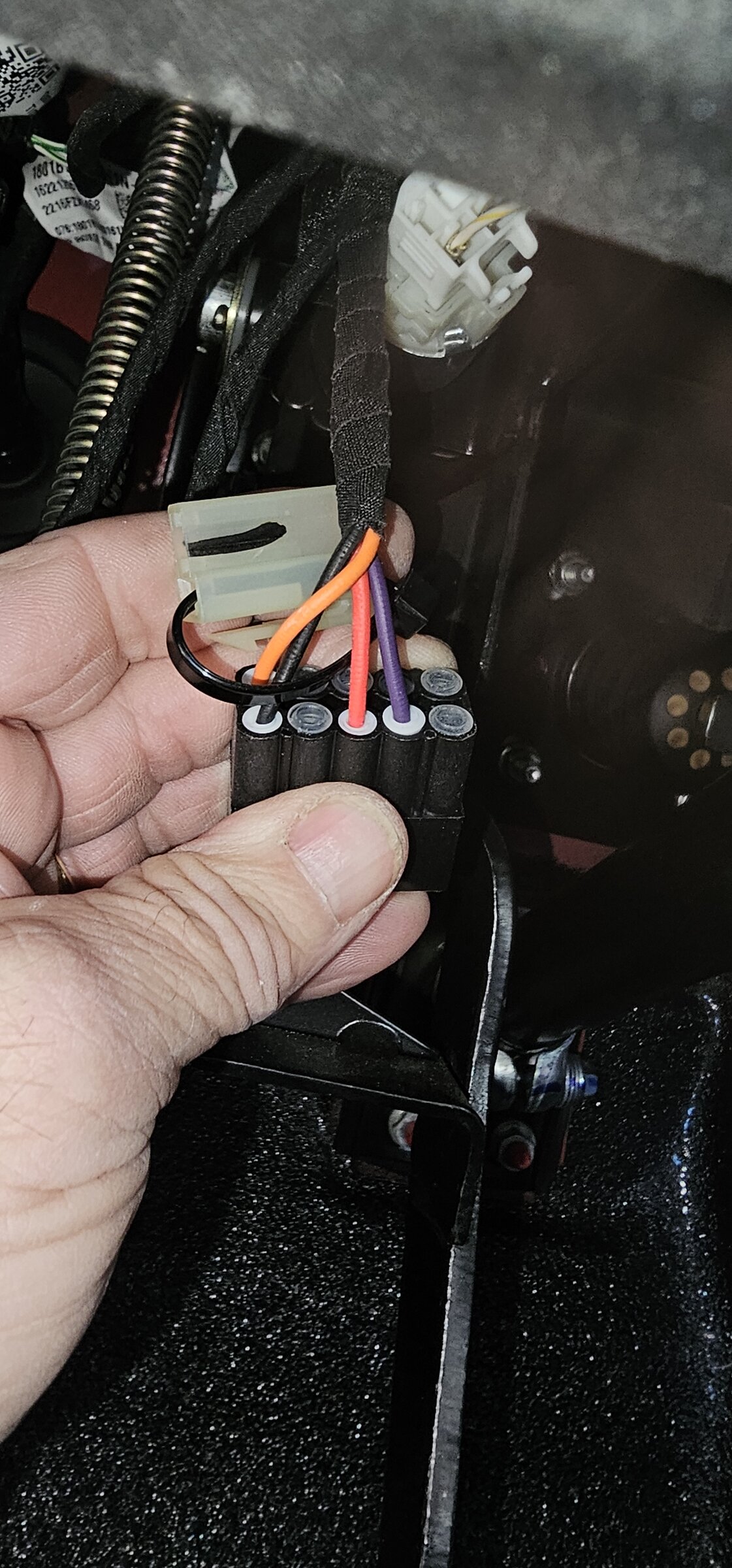

I got 3 switches from Sherwood Tractor today. I plugged them all in the harnesses with the blanking plates.
The harness labeled LED light bar send 12v to pin 1 of that 6 pin connector on the right under the dash. Pin 2 is grd. (Dome light)
The harness labeled 2spHeater fan sends 12v to pin 6 of the same connector. Pin 5 is grd. (Ecoxgear soundbar on order)
Pin 3 is hot 12v
Pin 4 is key on 12v
I have not found what the 3rd switch powers. Could be side LED lights?
