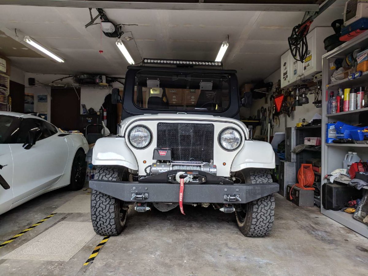

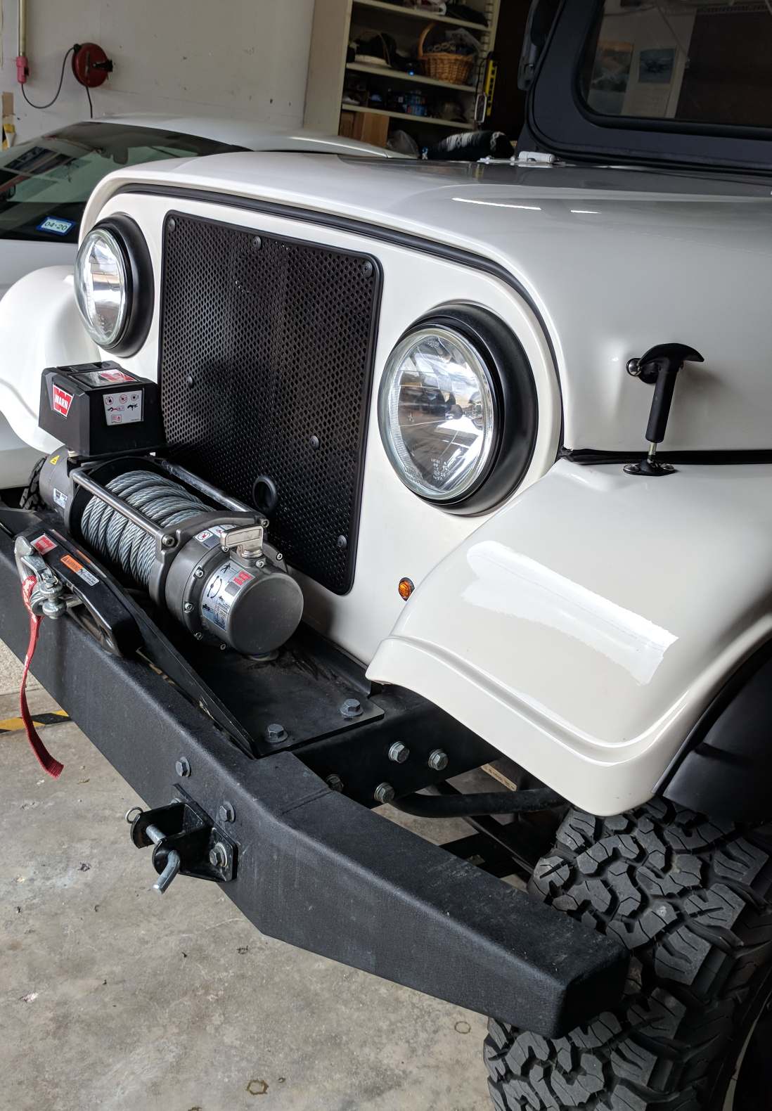

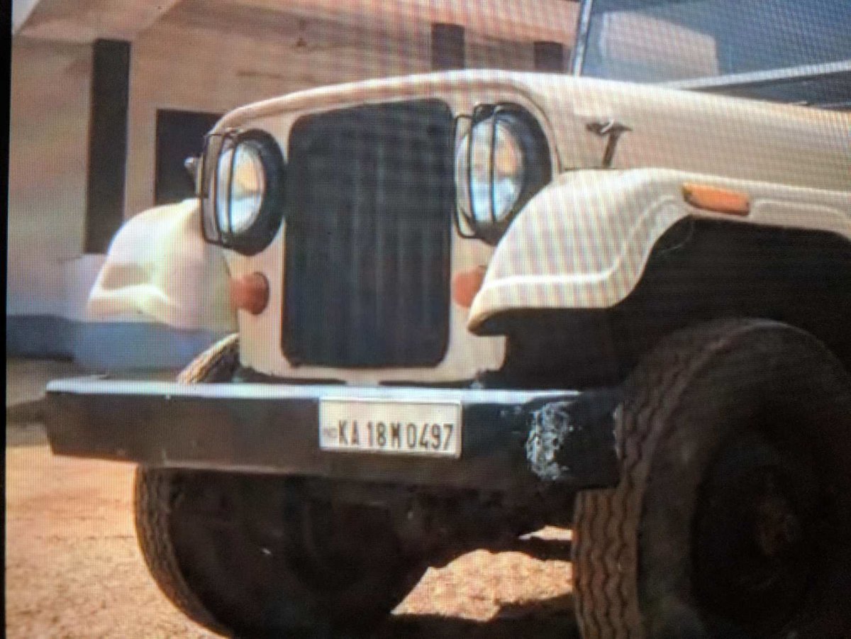

Got my grill guard attached today. Used the plastic hole plugs from the door hinge holes to mount the screen. Drilled 7 holes at the correct points and covered the behind the screen area with black body tape where it may rub and then masked it off and sprayed some semi flat black krylon over the area that will be behind the screen. Looks good. Not great but good. I should have used flat black paint. One pic below is of a TAN Mahindra MM540 over in India that I used as an example to try and copy.
