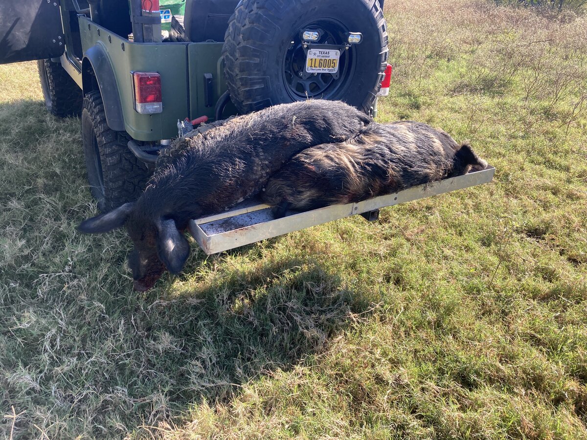

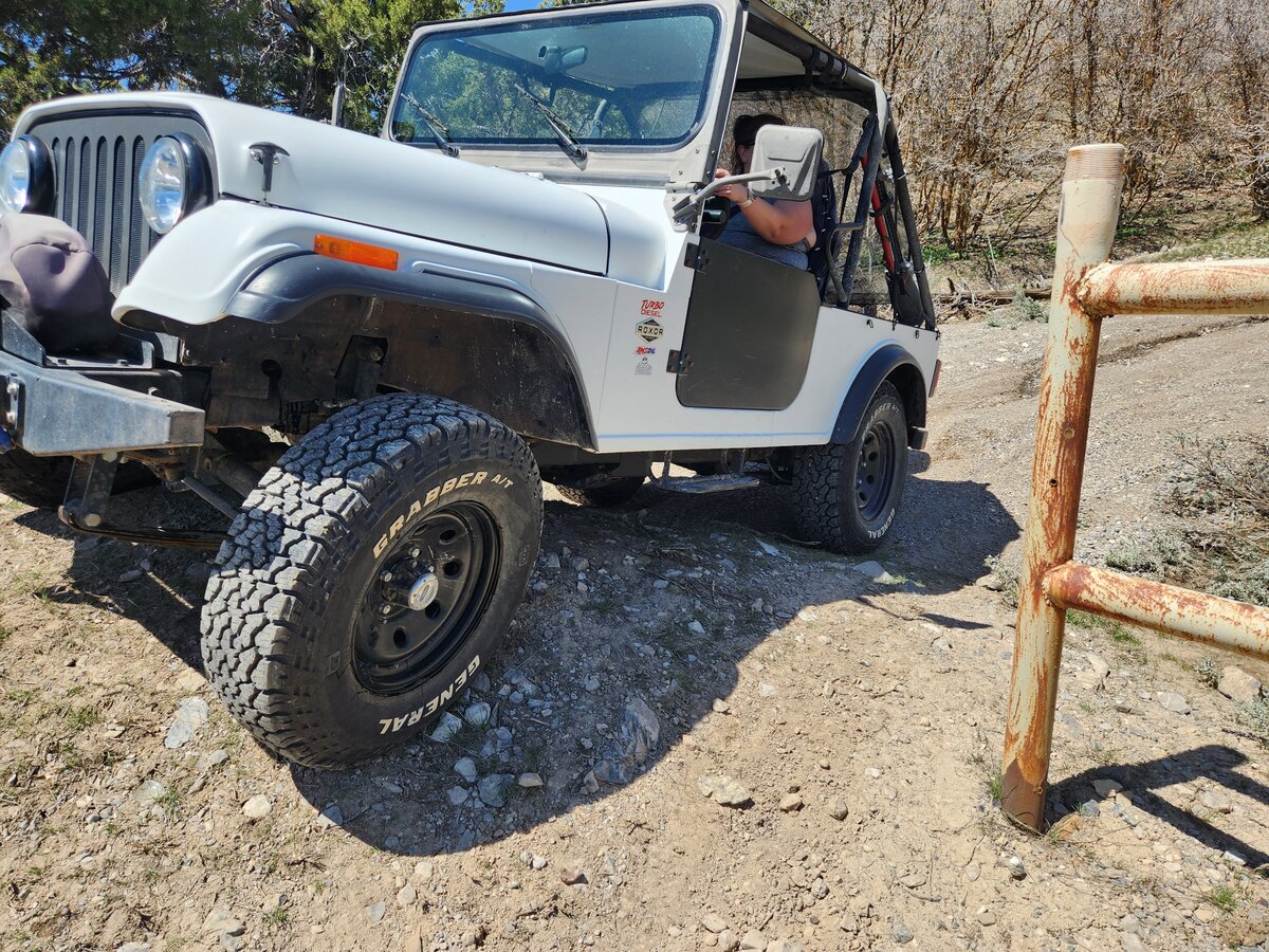

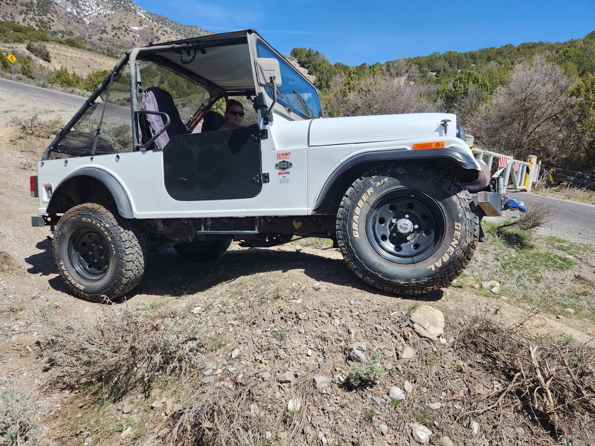

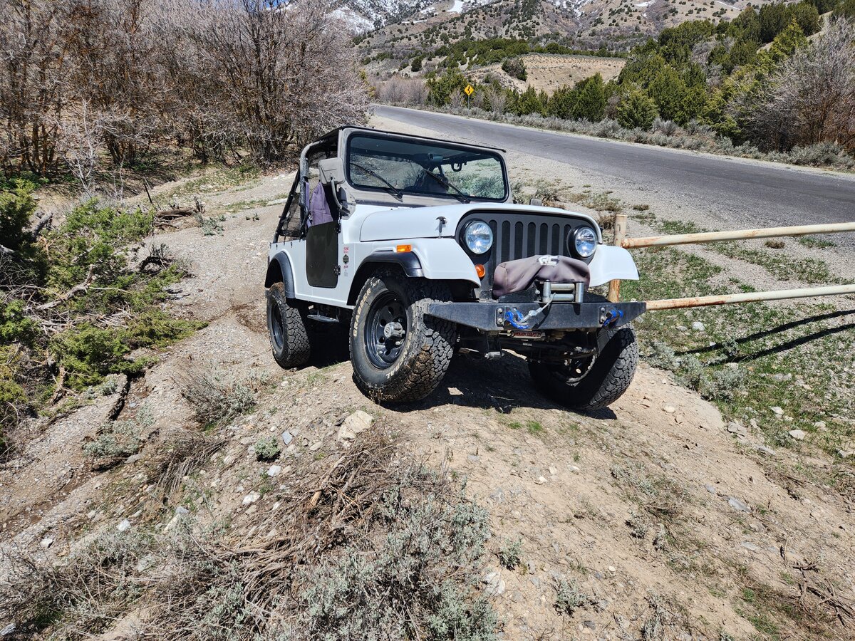

The springs are sagged and weakened. The add a leaf is a poor choice in this case. Do the 2” eBay lift and climax shackles or you can spend some money for custom stock height or 1” over stock by Eaton Detroit spring. Product Lookup by vehicle They have custom spring rates too. But dang they’re pricey. I went the eBay route and they work great. LoadEd up several hogs and little to no squat. If you can deal with the added height I think it’s the best value that will solve your problem. I too was riding on the bump stops traveling in pastures in first gear when I had hogs on the rack. The eBay springs fixed that. It’s McVeigh truck springs that sells them. About 400 shipped I think.
1,305
no squat on that rack and that’s a lot of weight hanging off the back end. Think leverage here.
