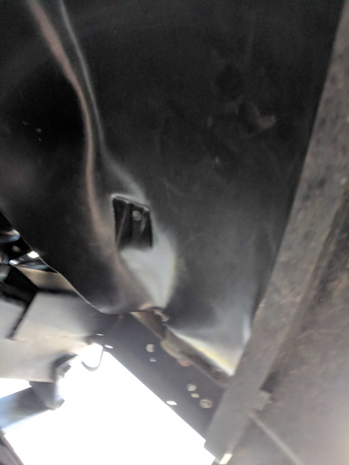

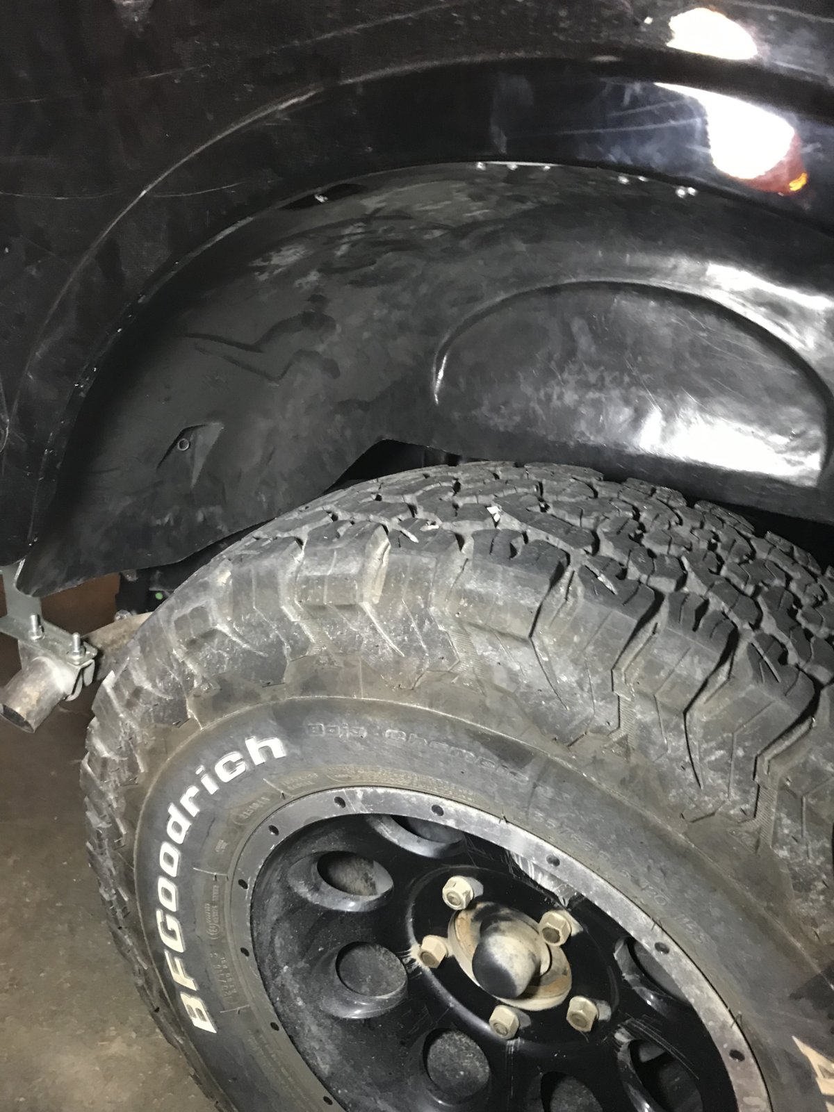

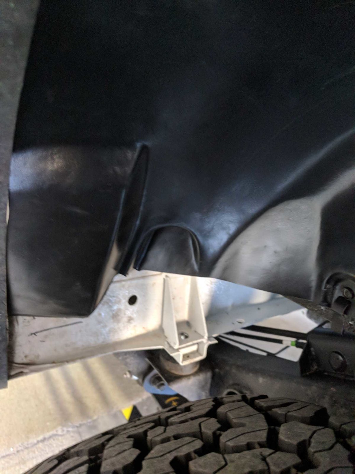

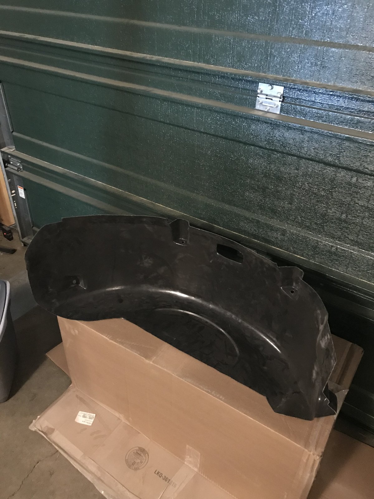

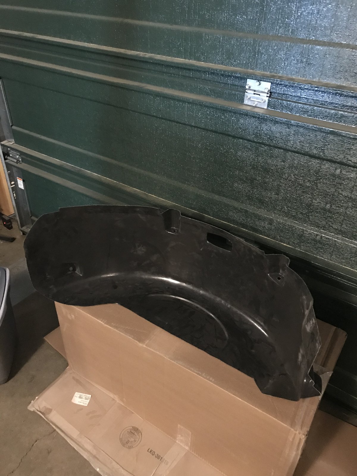

Here’s a rear liner for 08 to 17 Wrangler. It’s chopped to fit just need to cover one hole yet. Used driver’s side on passenger side. Think two bolts through fender well will be sufficient to keep it in place.

Here’s a rear liner for 08 to 17 Wrangler. It’s chopped to fit just need to cover one hole yet. Used driver’s side on passenger side. Think two bolts through fender well will be sufficient to keep it in place.View attachment 4805

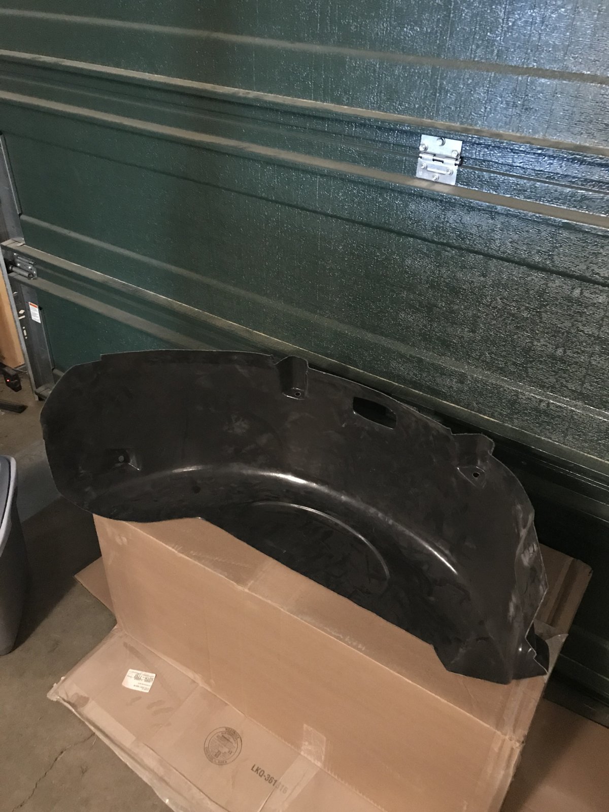

I found them on Parts Geek. OEM/replace 2008 to 2017 Wrangler. They’re not perfect but if you’re real careful measuring, they literally snap into place.

I went directly through fender box with 2- 1/4” SS bolts with fender washer. LOL- the shipping cost!!
When you get them, you’ll need to chop off top center bulge and cover/rivet with drop off from end trim. The other 2 bulges can remain; just make a vertical cut so they can insert into well.
You’ll need to trim a bit at top center where fender meets inner fender as there is no clearance for plastic to slide in

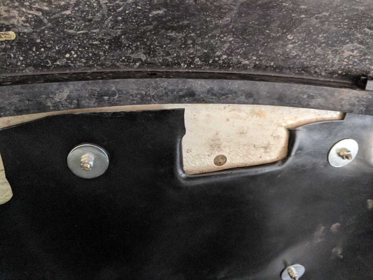

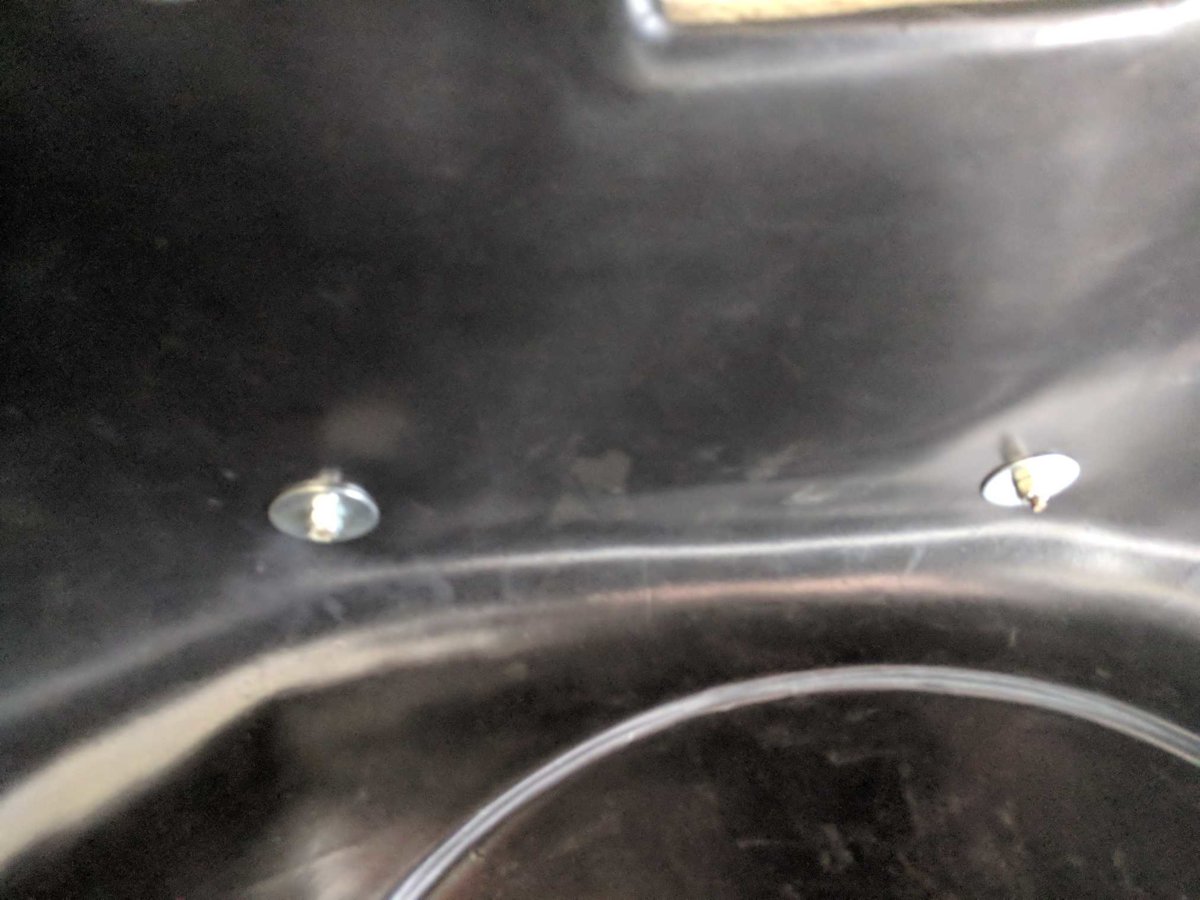

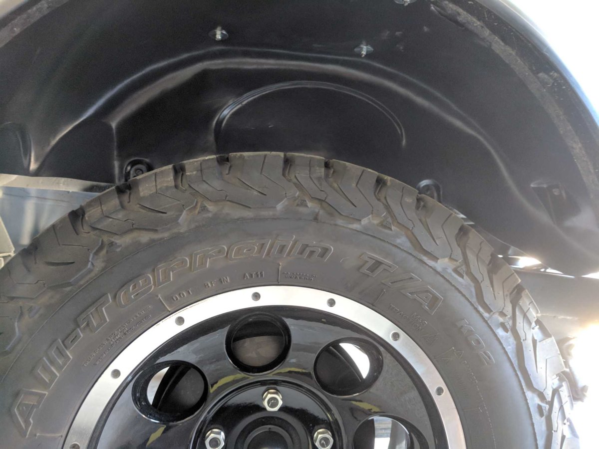

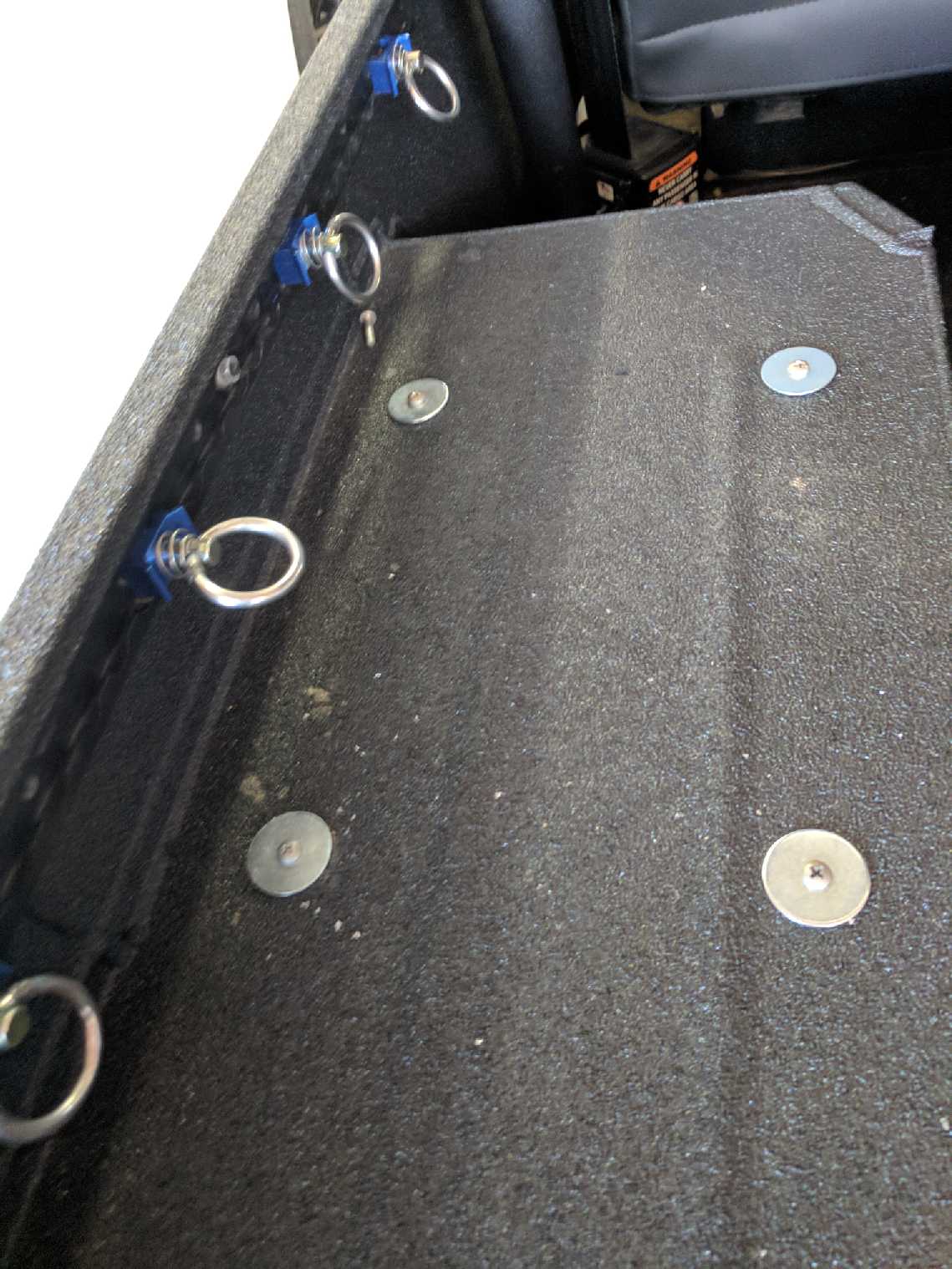

I started by trimming them more or less down to 11.5 wide. Then cut ALL the damn bulges off. Got them shoved in and popped into place. Once I was happy with the basic fit, I then decided to fasten them in with 4 screws on each to keep them pulled up tight in place. I then removed the liners to hunt for attach points.
I noticed the front factory u brackets with nuts welded on that are on the upper area, which I used the rear two for my first home made set, the front set are drilled through and are over coated with the bed lining material on the top side of the wheel house. So two of my pick up points are already there. I then measured back and made sure I missed any of the hacked out area of the liner which wound up being about 9 inched aft of the forward set of holes.
So I just poked an all up from the bottom to locate the front holes. I then shoved the liner back in. Then pushing up on the liner I drilled down through the located holes with the correct size drill. 3/16 dia maybe, making sure I did not drill my damn hand. Lol. I then dropped a 1 inch long # 10-32 screw with a fender washer down into the holes. I then used a fender washer on the bottom side and a lock nut and screwed it in. I then drilled my aft set of holes and repeated the same .
I was happy with the fit accept that the lower portion did not fit tight up against the wheel well along the bottom. So I manipulated some Z clip wire hold downs for trailer wiring into a pinch clip and shoved them on the lower body lip and they now keep that bottom edge tight against the wheel well. I painted the attach screws and washers shown after the pictures were taken. I also painted the white area showing after install.
I do still want to add a little aft lower flap and tuck it in at the rear for more mud protection.
So thanks guys, I now have almost OEM wheel house liners and a bunch of new cuts and old man bruises on my arms and hands! LOL
