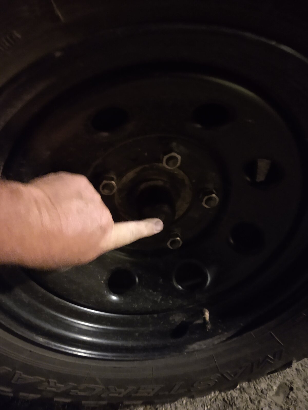

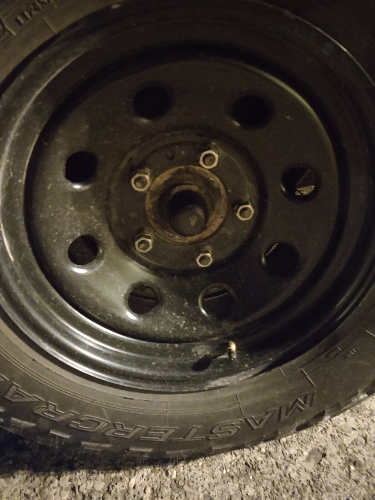

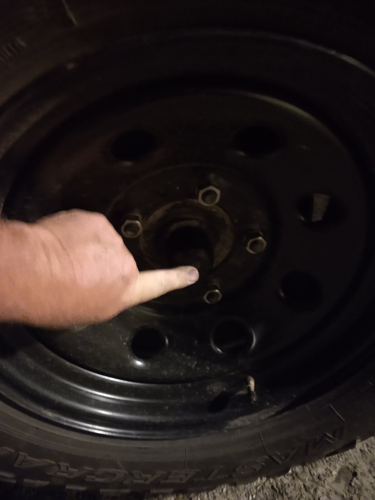

What do you mean end caps?I put in full synthetic diff oil , cooled pumpkin down, but end caps are still hot to touch! Guessing I'm going to have to either change out Spartan lockers for Ox locker or install full floating axel. Drove approximately 10 miles on a pave road, here in WV.
The dust cover/end cap covering the castle but
There’s no diff fluid there. The Roxors only have fluid in the pumpkins. That Bearing is greasable by way of a zerk on the axle tube you can access from the rear and it’s tucked up close to the brake backing plate.The dust cover/end cap covering the castle but
