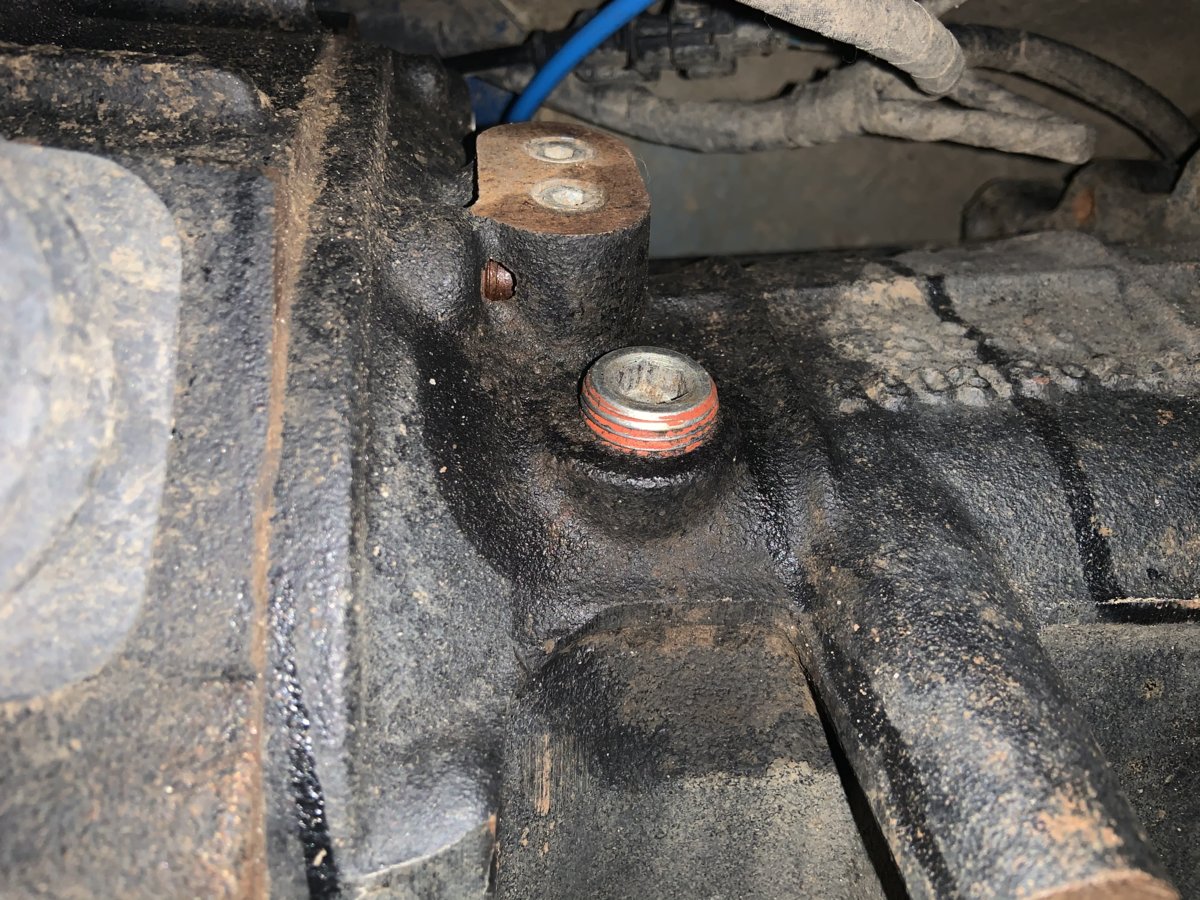

Just got my Roxor today. I’m checked all my fluids except the transmission. The owners manual as very nice detailed instructions for every thing except the transmission. How do you check the transmission fluid level. I did find a plastic plug on the top of the transmisson.

It’s on the driver side between the clutch fork and the reverse switch

Thanks, I’d seen that plug but did not think it was high enough to allow for 2 quarts below it.

Excellent! I had also been looking for where you could fill the transmission fluid. I experienced the same thing that many of the members have in that fluid in my differentials and transfer cases were quite low. I'm worried the same is true of the transmission. Does anyone know how you determine whether the fluid level is low? Is it the same as in the transfer case and differentials? If you open the plug and it's not dripping out then it's too low?

85w90 should be fine, as long as it’s GL-4. Checking level is the same as the diffs and transfer case
I found Pennzoil 75W90 Syntheic GL4, thats all that was anywhere near me and to the specs, so that's what I'll be using now since I blew a bunch of oil out, my bad. The spec say 1.6 litres for the TCase, it takes about 1.8 to get it to flow out the hole, that's probably why everyone feels they are low. The factory is probably measuring the 1.6 litres. That 200ml won't make a difference in my mind. Transmission is probably the same. I checked mine and had to bend the pinky to touch the oil. I didn't add any to it.
