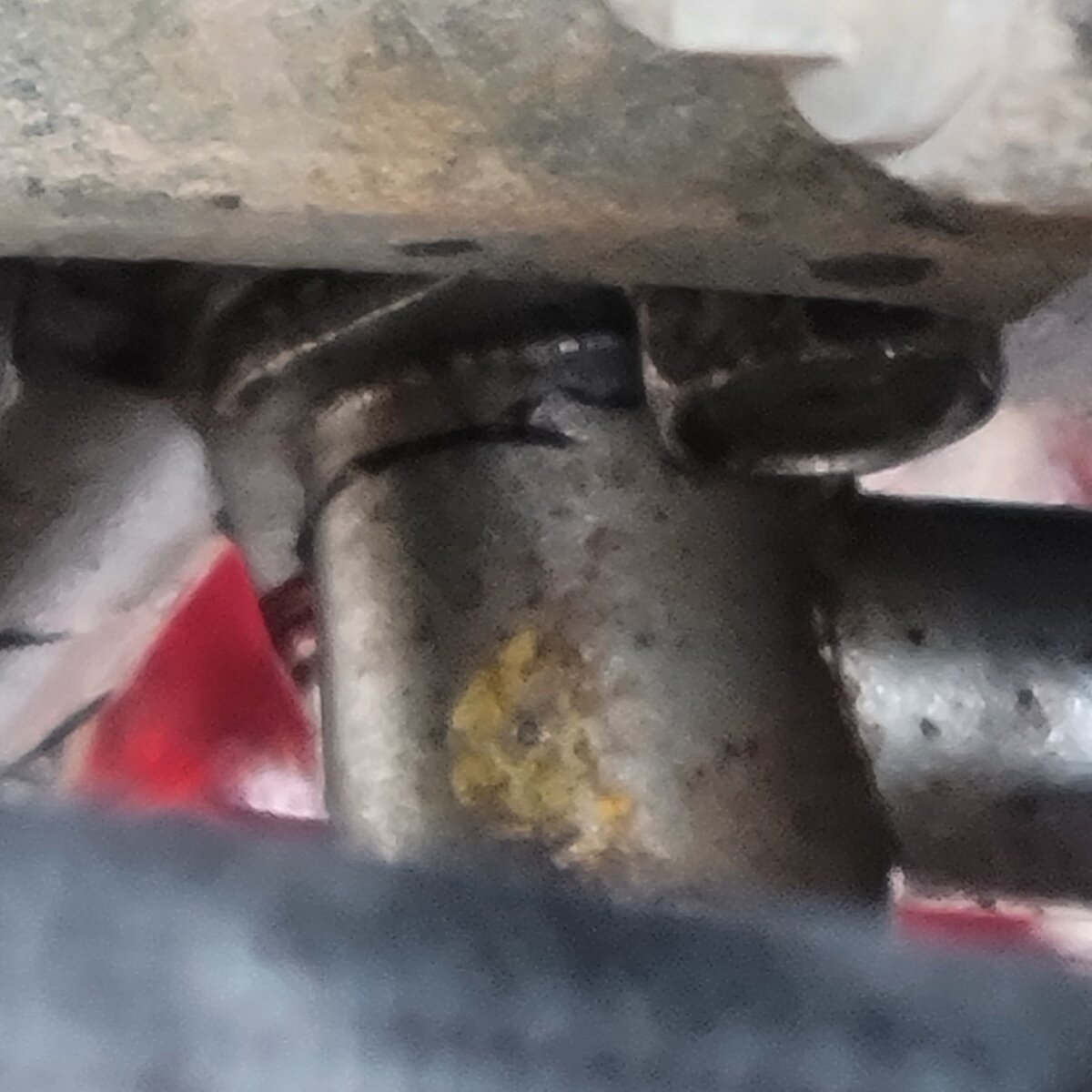

Just found a leak in one of the lines that run from the pump to the steering box. Where they crimped the hard line to the braided one has sprung a leak.
If anyone else has had this issue and fixed it I would like some input. For the time being I will loosen the belt and use armstrong.

Easier said than done. Might be an issue finding banjo fittings. Looking at it, it is going to be a challenge just to get it off. I took the belt off for the meantime. Not much difference except turning tight.

Got lthe line off. quite the task. front bumper off, winch undone at frame, dropped steering sector, wala, line off. Large line is pressure line.was surprised at that. It is a press fitting from a hard line to a braded one. The braded press fitting split. As another fello had his pump slit open, I am wondering about pressure issues. Lucky that a line split rather than a pump broken. Now to find OEM part or find a place to make one with the banjo fittings.
796
The service writer at the dealer told me a line had come loose. I said "what about the crack?" He said "what crack?" Then I emailed him the pictures I took of it, in anticipation of the typical "cannot duplicate the complaint" response.

this seems to be an issue then. l just ordered the 14m and16m banjo fitings and will take them down and have a line hyd line made for it. the fitting will mate with a 6jis hose fitting. I am a bit scared of taking the turns to a full stop. I think running a bit loose on the belt might save the pump. Belts are cheap. I am going to look the pump over a bit and hope there is a relief valve and lower the pressure if possible.

banjo fittings showed up finally. 16mm came from briton, go figure. Took them to a hydraulic hose shop and had one made. Been driving with armstrong, belts off. Glad to have it back together. Just hoping that relief spring is not too stiff and relieves before another pump or line broken.
