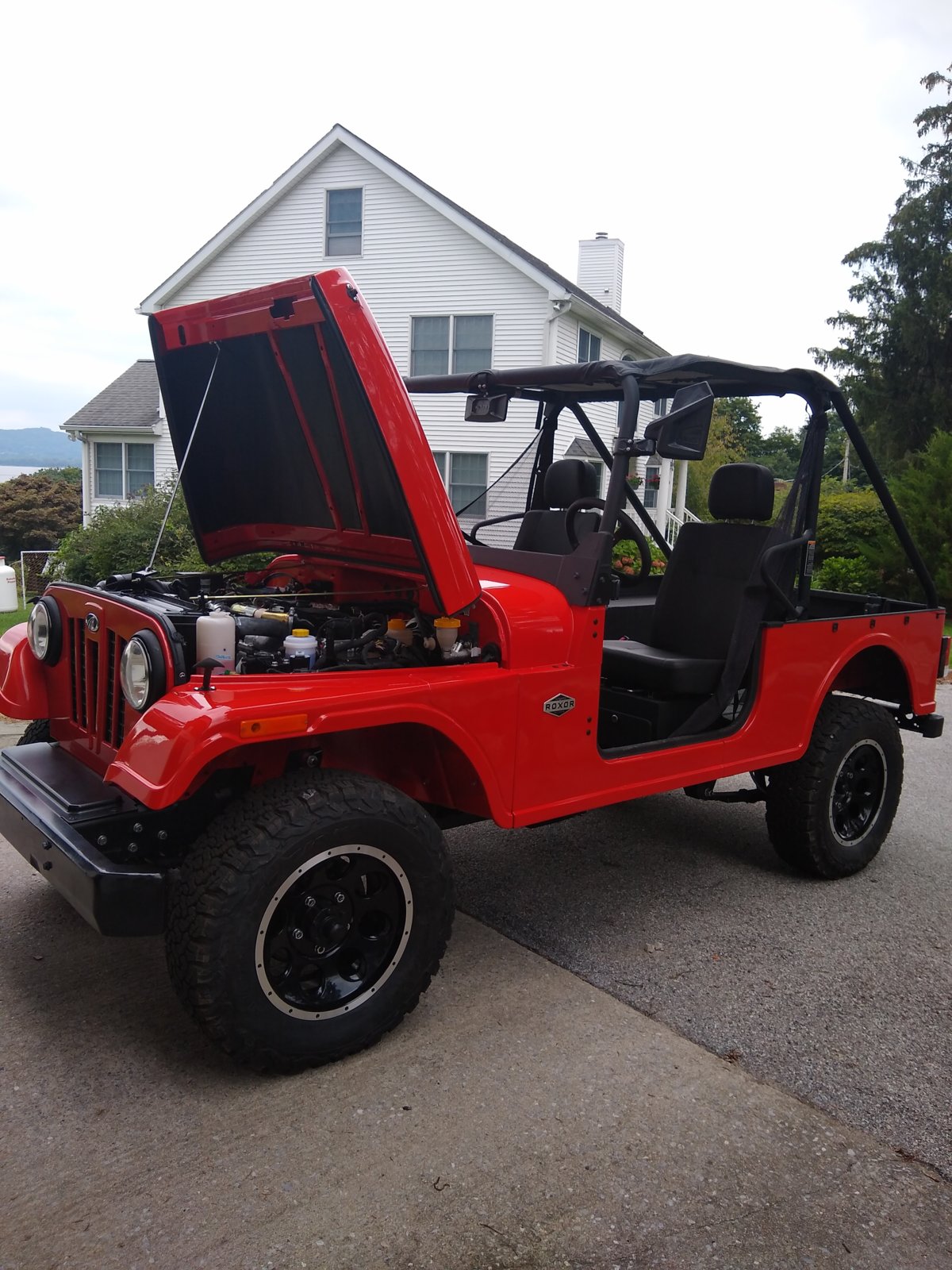

View attachment 4435[ Looks nice in red - Your Roxor is intended as an off road machine, hence the gear ratio and torque factor. It will climb a wall in 4 low. You're probably just used to your 911 or the Audi.
get it off road where you can enjoy it and use as intended - who knows, we might even get you converted to a off road enthusiast yet. Enjoy nature and get a little mud on your tires. Guarantee you it beats the hell out of putting around on a Vespa. Have some fun (chicks dig it too) :cool:
