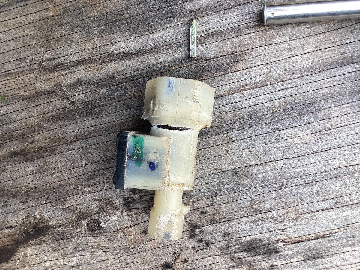

I just purchased a 2019 Roxor and it worked fine for the first week. Only 7000 km on the machine. Changed the oil and air filter. Yesterday on a short run it went into limp mode and the speedometer stopped functioning but all other functions or displays worked. It appears the previous owner had replaced the speed sensor already as well as a bearing and some seals. There is no dealer located within 750 km here. any suggestions?

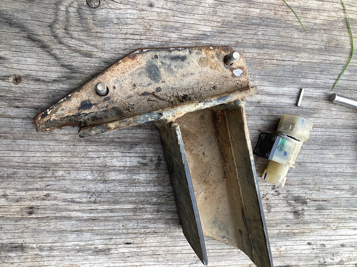

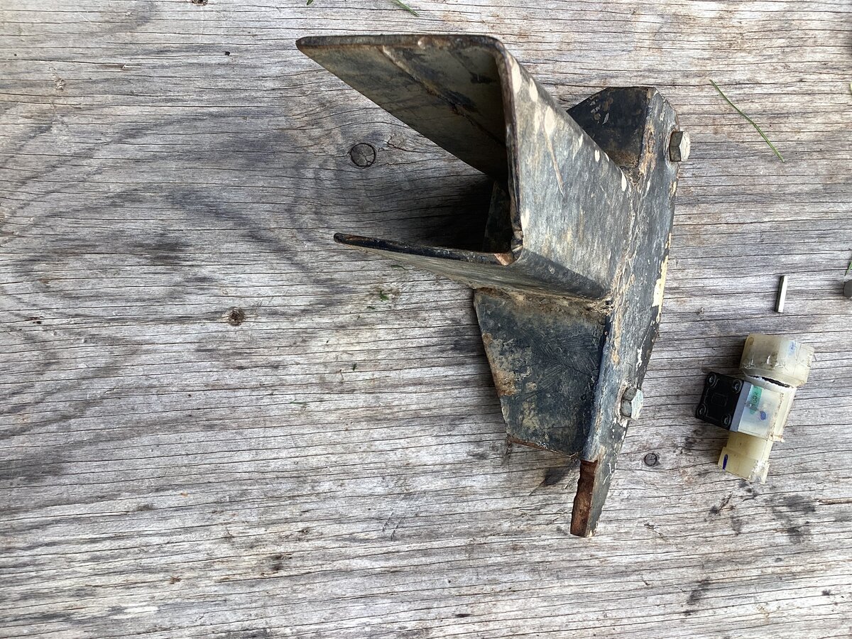

I got under today and yes the speed sensor was broken . I'll try to post pictures. it was cracked and when I took it off the needle part stayed in the housing but easily removed it with a magnet . The previous owner had manufactured a great protective cover for it that bolts to the frame and was easy to remove. I had the old speed sensor and tried it out but still in limp mode . I've disconnected the battery and waiting to see if that may clear the codes. The old sensor was registering 1488 ohms.
