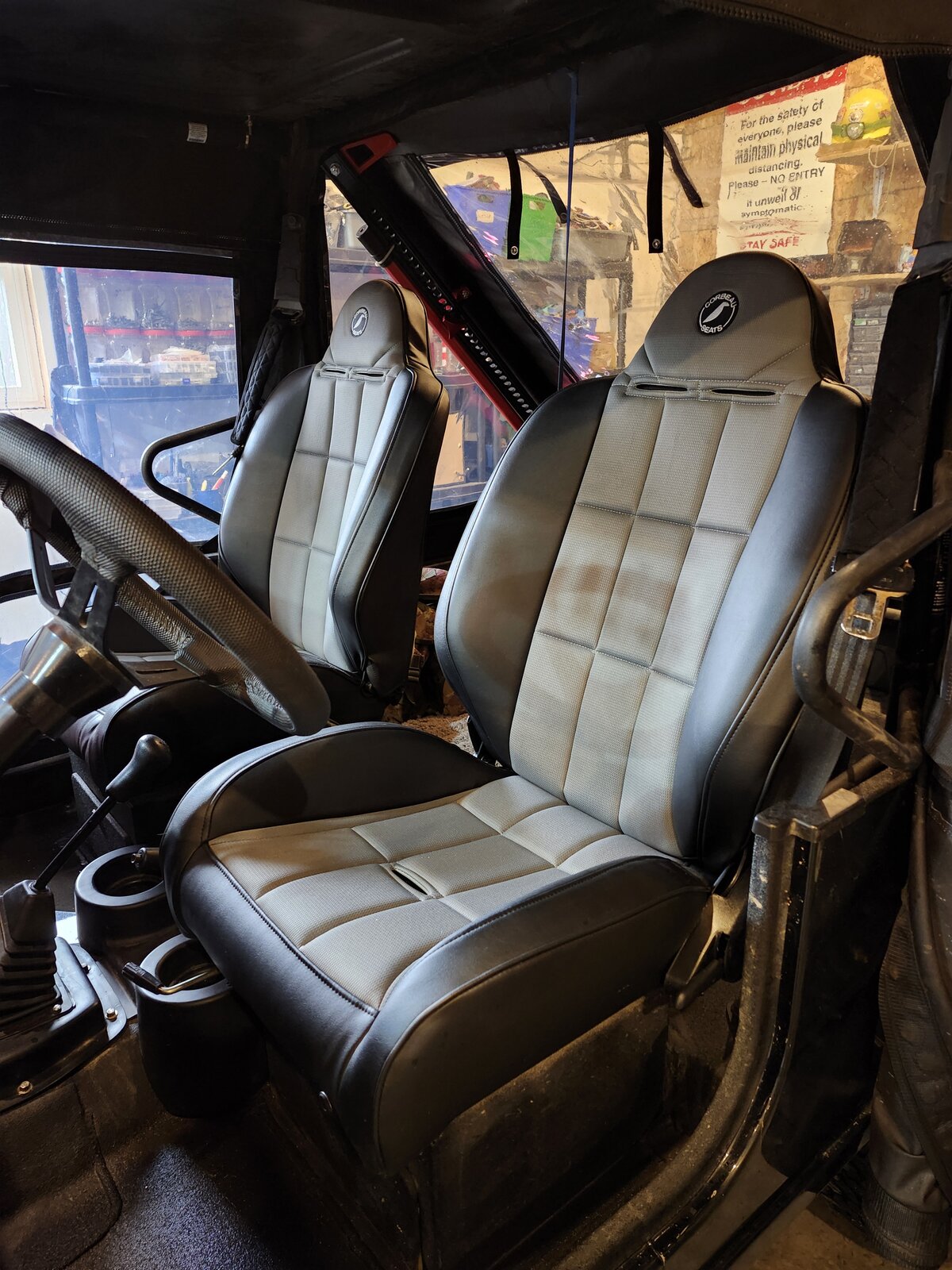

Finally got my new seats installed ( Corbeau ) big difference over stock , easy to install.

Did you use the DF seat bracket? Or did you use the stock bracket?
Stock bracket , just measured the center of the new seat and drilled 4 holes ( will require extra bolts , nuts and washers )if you go same route place a piece of wood under the drill area so ya don't end up poking a hole in the new seat bottom. The seat doesn't move quite as much as before as it hits the seat belt mount on the floor. It also sits a couple inches higher than original. The only other thing to look for is to make sure you seat is able to recline and not hit the roll cage on the side (the seat back is also wider than original).
