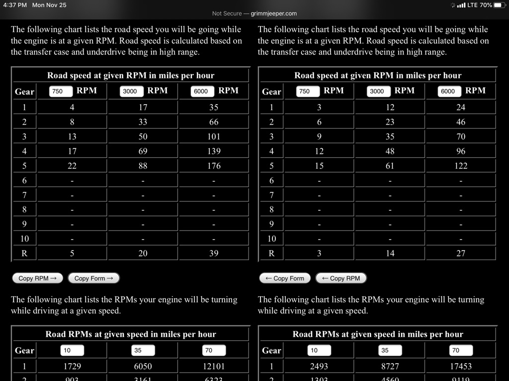

The 3.73s seem fine to me with MT. 4L is very usable for my needs. Think the AT may be best suited with the 5.38s. Will be interesting to see how the 5.38s affect on road driving.
1,302
This is for the manual. Don’t have the numbers for the auto. Both with 29s. 3.73 is left and 5.38 on right.
The site I used. http://www.grimmjeeper.com/gears.html

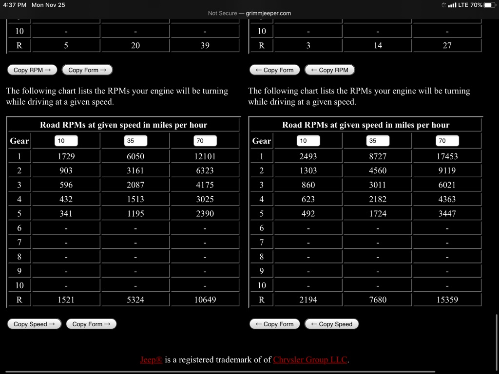

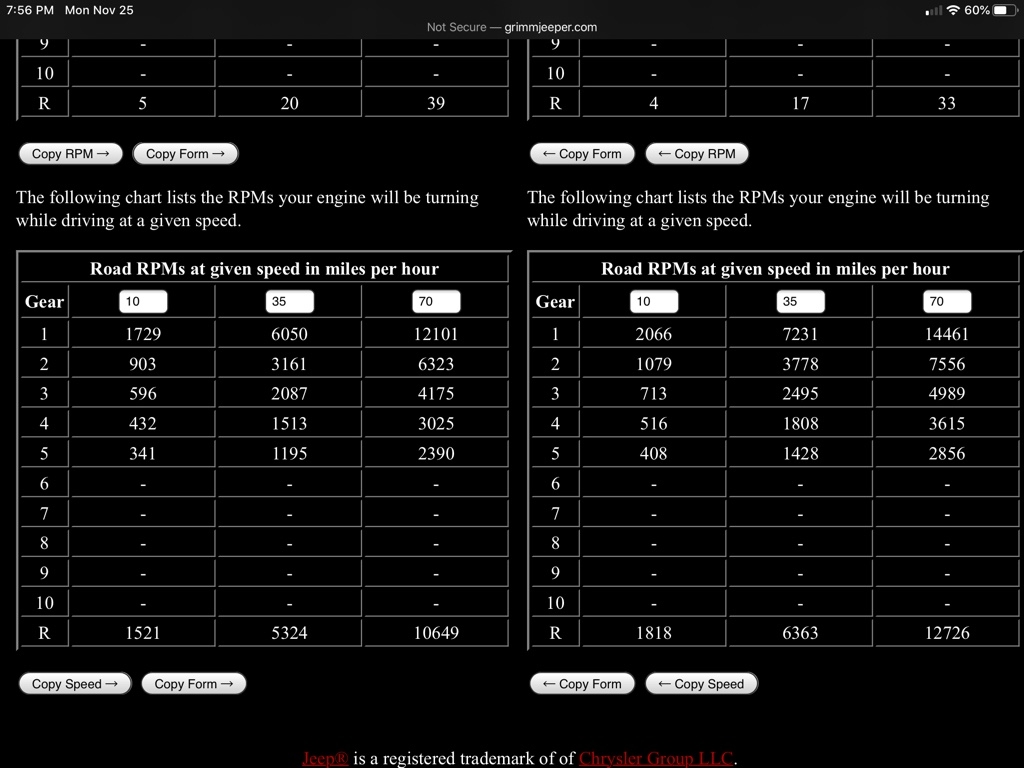

From txroadkill charts, I’d say they figured out how keep the tuners from defeating speed limiters :). I like my 3.73s!!!
1,302
Did they?
Left stock 3.73s and 29s. Right 5.38s and 35s
So run 35s and 5.38s and it’s slightly better in 5th than stock 3.73 running direct drive (4th)

OK, OK- Never said I could read your charts :). Thought they referenced about 1k higher rpm to achieve same speed?
1,302
Your right about the 1000 higher rpm for about the same speed 3.73 vs 5.38. I’m saying take that 5.38 geared roxor and throw a set of 35s on it. your only adding 500 rpm in this scenario which is probably about what you’d wants anyway to overcome the weight and rolling resistance of the tall rubber and higher stance. Perhaps this will help spur some manufacturers to come out with a more affordable lift. Then again I wonder if a level lift (which they say can run 33s) and a body lift of about 1” would be the easy ticket to run 35s.
